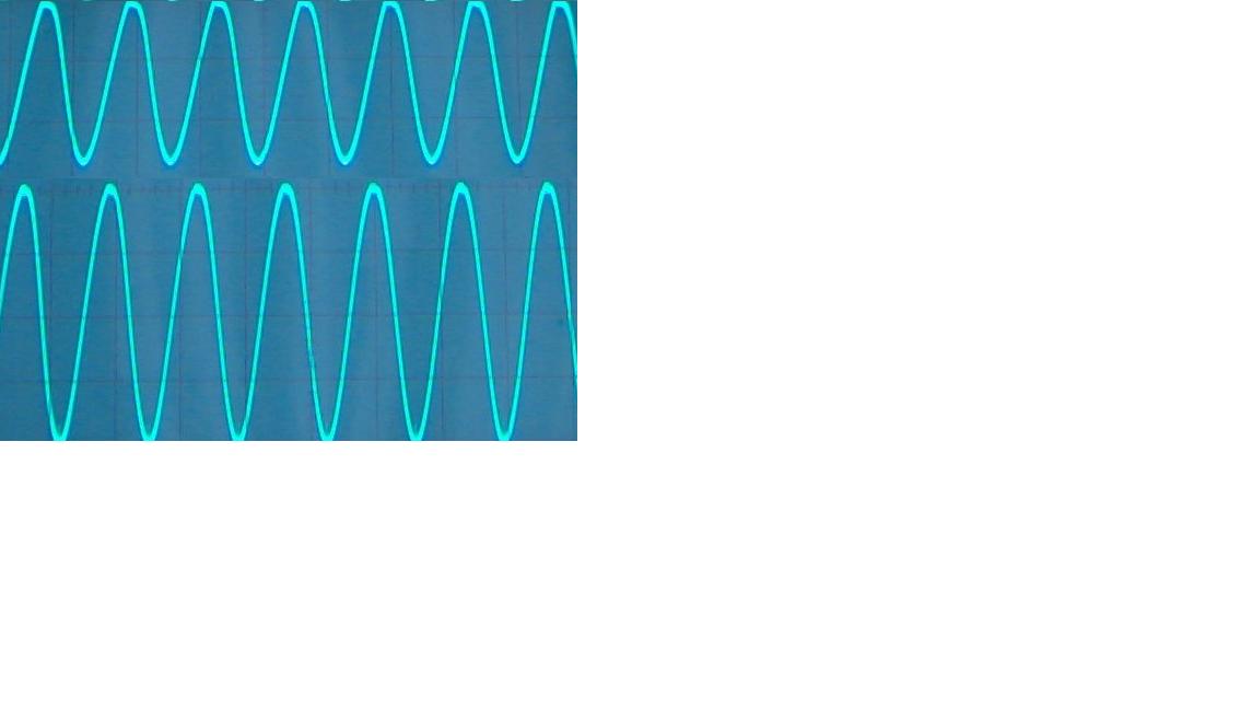

At this moment i can't get dual scope. I measured by sound card scope. I didn't attach pictures, because they looks ugly and are not stable at higher frequencies. But i managed get some info from it.Originally posted by simonbaker View PostGood observation, but I don't think that explains all the other waveforms

I measured Tx J1-1 vs LF353 pin 7. Rx signal lags about 17-20 degrees according to Tx signal, phase shift negative.
So my all previously attached graphs will be lagged about 20 degrees according to Tx.
Can we make any decision at this point?
As you noted, the RX phase can change easily with nearby metals or changes to coils, noise, etc., so it is difficult to trust any phase measurements relative to RX. Even with TX as reference, I usually need to make measurements many times to be sure I did it correctly.Originally posted by johnsmith77 View PostAt this moment i can't get dual scope. I measured by sound card scope. I didn't attach pictures, because they looks ugly and are not stable at higher frequencies. But i managed get some info from it.
I also find it difficult to think unless I see actual dual trace comparisons of the waveforms relative to TX signal. Too much mental arithmetic
. But if you can show the waveforms relative to TX somehow, we can try to analyze. However I am afraid a sound card scope may not be good enough and may cause phase shifts of its own as well as waveform distortion.
Let me ask first: how do you determine phase with your sound card scope? What is the reference? How does the trigger work?
-SB

I determine phase shift by this:
Frequency measured by sound card scope frequency meter shows: 14,51 khz.
Tx, Rx signals period for 360 degrees (period) - i see ~ 68us.
Difference between Tx and Rx i see ~ 12us.
So 12us / 68us = 0,176 x 100 = 17,6 %
Phase shift ~17,6%. Negative
In forum oscilograms i see phase shift positive 20 %.
Triger is not very good at higher frequencies of sound diapason . A little sweeping, but not so big as i could not measure.
Positive or negative shift, there is the reason? No double beeps for my coil. Tx 14,51. Rx also should be about 16,1. So?
Did previous scoppers mixed their Tx or Rx start, end connections ?
Is it a dual trace scope? If so, I would appreciate actual pictures with TX signal as top trace. I am never clear with word descriptions.Originally posted by johnsmith77 View PostI determine phase shift by this:
And could you say again what is the main difference between your signals and other peoples on this forum? I want to make sure I understand.
-SB
johnsmith77: Simon is right, you really need to find a scope so you can look at the relationship of both signals. What you are looking for is a phase shift expressed in degrees of a full cycle (360 degrees), not a percentage of it.
Your method is creative but I dont think it is going to work in this instance.
Jerry

Examples with positive phase shifts (Tx J1-2 vs LF353 pin 7):
a) http://www.geotech1.com/forums/attac...1&d=1261343207
Source: http://www.geotech1.com/forums/showthread.php?t=16122
Timebase: 20us; Phase shift: positive 57 degrees.
[calculated: 12us /76us x 360 ]
b) http://www.geotech1.com/forums/attac...1&d=1192949609
Timebase: 50us; Phase shift: positive 102 degrees. (calculated: 20us / 70us x 360 ]
Source: http://www.geotech1.com/forums/showt...hase#post61260
c) My phase shift negative 17%; its means 0.17 x 360 = - 61 degrees negative.
Timebase: 50us.
Attached picture, it looks very closely i got with pc soundcard scope.Attached Files
