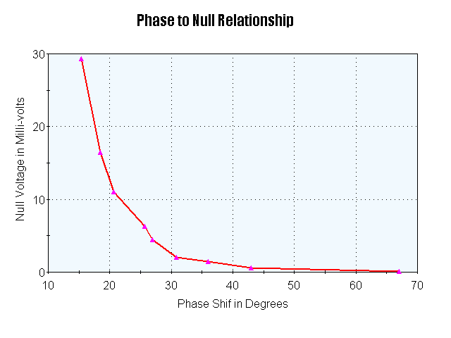

                        Here is a graph that I made last year showing the relationship of the coil phase shift to the null voltage. It may help shed some light on things.
                        Jerry
                          Jerry
                          Nice graph. Md is not working good 100%. The ferrite is not rejected in disc mode.

                                Ok.... The pictures are a representation rather than from your sound card scope. If this scope is not stable enough to get a good picture of both traces you are taking a lot on faith that the 12Us shift is accurate.
                                This whole discussion may not matter in the long run if it is working ok.
                                Jerry
                                Remember this type of graph, as I hope to return to it with an underlying model that would help make it more widely applicable.
