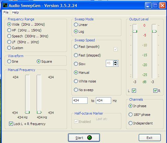

            • Poor mans coil tuning.
              I thought about this one for a while and just gave it a try. No way to measure the inductance of your coils? No problem! Just tune it like a guitar.
              Since the audio frequency is just divided down by 32 from the TGSL oscillator, we can adjust our frequency by just listening to the audio, and removing or adding turns to our coils. It's easy for me because my coils are made with no binding. I make mine sticky with "Spar Varnish" when it goes on the form and then let it dry. It's easy to peel off a few windings.
              Ok.. so here is what to do:
              Download this slick little audio oscillator to run on your PC.
              http://www.softpedia.com/progDownloa...oad-65501.html
              DISCLAIMER: I got mine from the external mirror site. I scanned for viruses so to appears to be OK.
              Then, set up your TGSL and null your coils. Crank up the audio oscillator and set it to a 453Hz square wave (14.5kHz / 32 = 453Hz). When the audio of your TGSL is the same as the audio oscillator, you should be tuned to 6.0mH for the Tx coil! It's fairly accurate..
              Then.. switch your coils.. Tx for Rx and Rx for Tx We won't leave things that way.. just do it for testing.
              Then, set up your TGSL and null your coils again. Now, adjust your audio oscillator for a 434Hz square wave (13.9kHz / 32 = 434Hz). Again, add or remove turns to your Rx coil (which is now connected to Tx) and tune your TGSL to the same frequency. Now, your Rx coil is set to 6.5mH!
              What we just did is resonate each coil to .020nF, and assuming C1 and C2 are in spec, your Rx and Tx coils should be real close..
              Good luck

                    Yes, I agree.. The whole idea makes some assumtions. I thought that maybe this would help a few guys who were struggling with getting their coils right with no scope, inducatance meter or frequency counter.. They would also have to get at least 3 of their caps in spec to begin with... C1, C2 and C6.
                    One observation I just made.. Use volume sparingly! I think that the square wave function tends to heat things up a bit in a PC. Duty cycle must be at 50% or something..

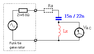

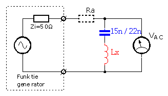

                        Perhaps also another way to determine the coil value ( also for those who haven’t got a scoop , L meter or frequency counter ) is with F osc , the oscillation frequency of the coil itself .
                        The first set of coils I've made were complete according the specs : 6 and 6,5 mH ..... I thought so .
                        Only the L meter on my Digital Multi Meter was a little bit very much out of range , I should have bin more suspicious while removing the big layer of dust of the DMM.
                        Anyway I went to the electronic shop , measured the coils over there and re-calibrated my DMM according the values given by the expensive L meter from the shop.
                        But to be sure I double check the coils with F osc. :
                        In the attached examples is a Function Generator connected to the coil ( Lx) in serie with the capacitor ( 22n for Tx or even better remove the 22n from the pcb in case of any tolerance issues ).
                        Now use the SweepGenerator or a similar Tone Generator Program on your pc or laptop instead of the function generator
                        As Don stated :
                        begin with a very low input sinus voltage round 14 KHz / 0,2 – 0,3 Vac and slowly raise the frequency :
                        In case of the voltage meter over the coil the voltage will peak at the oscillation frequency of the coil
                        In case of measuring over the coil and the capacitor the voltage will reach a minimum voltage at Fosc.
                        Take the value for Fosc ( for example 15,6 KHz and 22n for C ) and use the next formula to calculate Lx :
                        http://www.whatcircuits.com/lc-resonance-frequency-calculator
                        The calculated Lx values are pretty close to the values of my re-calibrated DMM J .
                        I don’t know if this can hurt your pc or laptop so be careful …
                        I haven’t tried the software SweepGenerator or Tone Generator way myself yet
                        ( it was on my list in the “preliminary” ) .

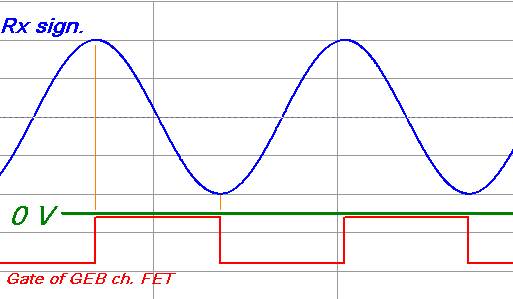

                          Hi to all ,
                          My reply on post 523 and before : in these examples the signal on the gate of the GEB channel FET is a kind of a square wave ...
                          On my TGS this signal - sample puls is more like a sawtooth , I can remember -SB SimonBaker had the same experience in the past?
                          Is the sawtooth a correct signal here ?
                          I know this isn't supposed to be the right way but when I adjust my MD in
                          DISC mode as described above and according to the attached example I have a great detection , but no discrimation at all .
                          Dennis the Mennis

                            Hi DtM:
                            The sawtooth is the ALL METAL mode signal that goes to the DISC JFet gate when you switch to ALL METAL. It should never go to GB JFet.
                            Double-check which JFet you are mentioning and let us know, to make sure you don't have a wiring problem.
                            If wiring is OK, then sawtooth at DISC JFet gate just means your switch is in ALL METAL mode and then DISC pot has no effect by design.
                            Flip the switch to other position and observe the same waveform and let us know how it looks.
                            Cheers,
                            -SB
                              As Don stated :
                              Dennis the Mennis
                              Yes, I've used that method too, I think it's pretty accurate (assuming your sine generator and DVM don't contribute much capacitance).
                              A lot of DVMs have miserable bandwidth on AC voltage I've found, but probably won't affect your method too much.
