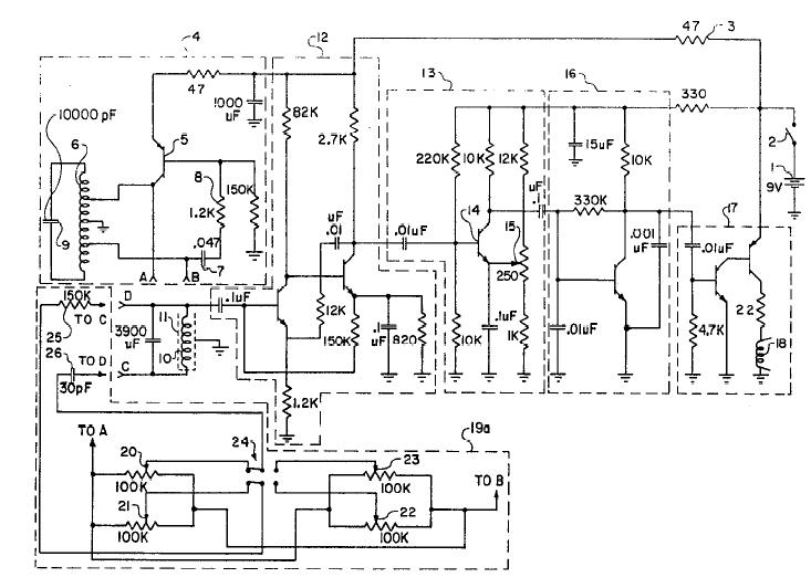

                I did build the attached circuit a while back. It may accomplish what you are describing. Might be an easy way to implement a external null phase.
                The feedback network is at the bottom left of the schematic.

                  Also, I may already have such a circuit if you want to experiment with it. It's a Nautilus DMC IIb!.. It has an adjustable coil balance (Signal loop balance) that feeds back both phase and amplitude to the Rx circuit... I am thinking that the DMCIIb still uses feedback in some way like the older patents

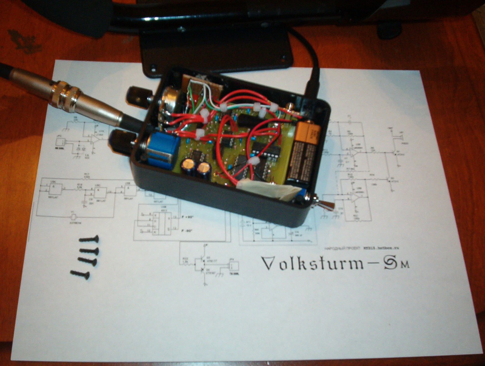

                    Also, for a neat little circuit to play with (single channel) I might recommend KT315's Volksturm.. I built an 3 of these last winter but added a phase shifter right after the Rx op amp.. Might fit the bill if you just want to play with phasing and nulling.
                    The real advantage to single channel is that it goes deeper in the ground.. at the expense of digging everything. Odd thing is that this circuit seems to work best with an untuned Tx (Just a square wave).
                    Don
                      Don

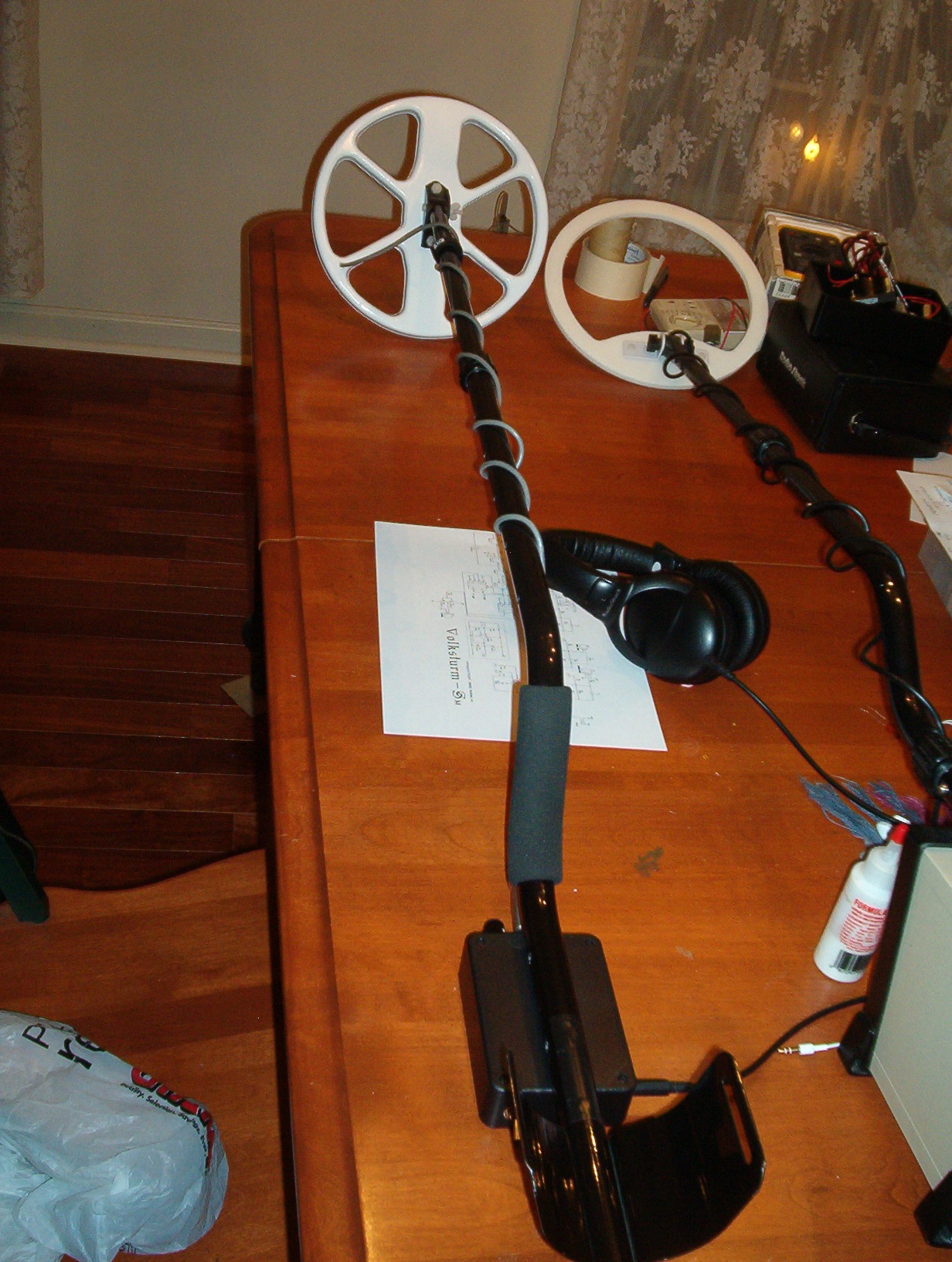

                        Well, I have only made 3 IB detectors to completion and used them so far.
                        For straight relic hunting, I might pick the Volksturm since it might go deeper, (in the ground anyway) but the TGSL is more practical for hunting. I have also built both Stuart PIs and 2 HHs. I did some relic hunting with the HH and it worked OK. I did have some great success with the TGSL earlier in the season so I have some confidence in it.
                        I did notice that in my test garden, the Volksturm would hit some deeper coins that the TGSL could not find, but it would pick up every little nail and small pieces of iron as well. The Volksturm can discriminate or ground balance, but not both at the same time.
                        Don
                          Don
