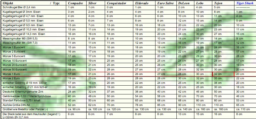

            Best cable for TGSL is double coaxial such as Vladimir is shown, it has been proven many times .
            • Originally posted by tragac3 View Post
              I don't think Tesoro uses such cables though, maybe for a reason.
              -SB
                -SB
                Hi Simon
                We have already proved that the original Tesoro, modifications are better ... why not accept that they have a mistake in the choice of cable?
                I would never replace my TGSL for Tesoro TGS.
                • Originally posted by Vladimir View Post
                  Hi Simon
                  Yes, I accept that as possible. It would be nice to test it somehow too.
                  -SB
                  • Reason:
                      Reason:
                      Don't forget most of those Tesoro MDs use a concentric coil, which is really preferable if you can get the same depth.
                      -SB
                      • I know that, but with the DD coil I got a better sensitivity (# 209). The self-construction is difficult to make a good concentric coil.
                          Right - but that is probably a major reason TGSL beats Tesoro TGS in those charts, because of coil, not design.
                          But I always say if you get great results with whatever design, cable, coil you use, that is what counts. Your's works nicely. I just like to try to learn which individual parts may be superior, not always easy.
                          -SB
