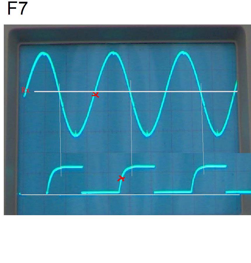

    I think I have spotted your mistake.
    The sampling pulse should not start at the zero-crossing of the RX signal. It is the middle of the sample pulse that must be at the crossing point. Also, for a DD coil, the sampling must take place at the negative-going transition, not the positive.
    And one last point ... all targets should cause a phase-shift to the right.
    If I'm right this is the way the sample puls aprox. should look like ?
Name:	sample puls for DD.jpg
        [ATTACH]11517[/ATTACH]
        Dennis the Mennis
        You need to shift the GEB sample pulse slightly to the left, but otherwise the signal relationship looks ok.
