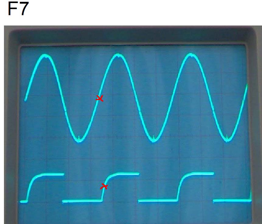

            In pictures below, trace 1 is TX coil (collector of TR1), trace 2 is pin 7 of U101a and trace 3 is source of TR5. In first picture the nulling has been done according to the method 1, which resulted +25 mV at the source of TR5. The phase difference is about 29 degrees (8% * 360 deg).
            In the second picture, the coils vwere adjusted to get minimum voltage at pin 7 of U101a. In this case the voltage at the source of TR5 is -25 mV and pahse difference about -120 degrees (-33% * 360 deg).
            I have the coils resting one on other, without any fixing yet. They don't have the shielding yet. The coils are resting on a styrofoam board, about one meter above the floor; so there's no metal above or below them. At the side of the setup (30 cm away) there are large metal cases (my instrumentation). Can they disturb the nulling? Is it even possible to null the coils without fixing the main parts of them ie am I trying to do something impossible, if I have them just resting free one on other?
            It has been mentioned also, that overnulling can cause troubles. How to prevent overnulling ie what to look for?
            Is it so, that if I null the coils according to the method 1, it will automatically fulfill the requirements in method 2 i.e. the phase difference is automatically correct?
            Do these pictures make sense?
            Andy

              Both methods 1 and 3 are incorrect for setting up the coil balance.
              Also, method 2 should have 20 degrees for the offset, when using a DD coil, not 200 degrees.
              If you are getting 2 beeps when you pass a coin over the coils at a distance of about 7cm, then you have the RX coil connections swapped over.

                So, for my DD coil the phase shift in the first picture is in right direction but a bit too much (29 deg instead of 20)?
                Andy

                  D004.TIF looks most like the result that works best for me. But only if the RX leads are correctly connected.
                  Qiaozhi has good idea to try swapping the RX leads and try nulling again.
                  I find that if the coin is very close to the coil, you may get double beeps in any case. But if further away and you get double beeps, it is a clue that the leads should be swapped.
                  I also feel that after nulling, the voltage at the Source of the JFets should be slightly positive (between 0 and .5 volts) -- your null phase determines whether positive or negative.

                    The first picture looks correct. However, bear in mind that the RX signal will be inverted if you swap over the connections. In which case you will need to readjust them to achieve the same phase relationship. The phase offset does not have to be exactly 20 degrees. The important point is that you must be able to achieve ground balance.
                    Both Max and Ivconic claim to have achieved greater than expected detection distances for this design. In general you should expect the detection depth for a 1 Euro coin to about the same as the coil diameter. Some detectors can achieve better than this guideline, but this is only in an air test. It's a different story when you get out into the field. Look at this link for a realistic guide to detection depth ->

                          Coil nullin, conditions to met?
                          Hi Dennis TM,
                          The coil recipe was as follows: 255mm diameter, 137mm height at middle, TX 100 turns (5.7 mH), RX 105 turns (6.2 mH), wire diameter 0.25mm.
                          I used 0.3mm wire, maybe that left the impedances bit lower: TX 5.3 mH and RX 5.8 mH. The TX frequency is 15.1 kHz. I then added the recommended 9% to that and got 16.5 kHz for RX coil resonance. With the existing RX coil inductance, the capacitor C6 should be 16.2 nF, therefore I added 1 nF in parallel to the 15 nF. I don't have the shieldings (yet). I need to get the device to work on bench before going further.
                          Simonbaker and Qiaozhi have given valuable hints, but I'm afraid I still haven't digested everything. I'm still not sure how to null the coils. Based on everything I have read here, there are several criteria, which all should be met simultaneously:
                          1) First minimize the level at pin 7 of LF353. Then push the coils a bit more together so that the RX signal lags the TX by 20 degrees.
                          2) After completing (2), the voltage at the source of TR5 should be close to zero. According to Simonbaker, 0 - 0.5V.
                          3) Also the sampling on the GEB channels should happen at the zero crossing point of the RX signal. See attached JPG. I understand this so, that the lower red "X" (GEB sampling start) should be exactly at the zero crossing of the RX singal (upper red "X").

                            I think I have spotted your mistake.
                            The sampling pulse should not start at the zero-crossing of the RX signal. It is the middle of the sample pulse that must be at the crossing point. Also, for a DD coil, the sampling must take place at the negative-going transition, not the positive.
                            And one last point ... all targets should cause a phase-shift to the right.
                                This is a tricky issue which Qiaozhi and I occasionally have slightly different interpretations of. And I don't have concrete proof for my ideas. But...
                                My opinion is that the null signal is very deceiving to use for phasing decisions because it does not really indicate the phase of the actual received signals. The actual received signals are very tiny and not visible and have their own phase which is not directly related to the phase of the null signal. I believe you can vary the phase of the null signal by shifting the coils here and there without much changing the phase of the received signals. But don't believe me yet -- it needs to be demonstrated.
                                However, based on my opinion, it means the "sample pulse" needs to be properly phased relative to target signals, in other words, don't worry so much about the null signal for that issue. Of course the sample pulse phase moves around when you rotate the discrim pot, so we always need to mention the location of the discrim pot when we show the "sample pulse", otherwise we are comparing different circuits.
                                As it turns out, there is no adjustment in the TGS circuit to "bias" or shift the basic phase range of the discrim "sample pulse" -- just the discrim knob itself. So for now, we just build the circuit and hope for the best. I'm actually trying to experiment with some ways to adjust the range over which the discrim control works to help troubleshoot if that may be the cause of poor performance.
                                Anyway, what this all means is that I think the phase of the null is mainly important for biasing that voltage at the Source side of the JFet. However, I realize that must be an oversimplification because of all the importance placed on nulling. But from my tests so far, that's how I see it.
                                I know I need to learn more and understand better, so if I completely change my opinion later, don't be surprised. But the main reason I make this point is that I think that with some coils you can null for the rest of your life and they'll never work any better. It's something else about the coil that is deficient and it is a mystery right now. So I would follow one of Ivconic's recommendations which is: null your coil by swinging a coin above it for maximum depth. If you don't get good depth, build another coil!
                                I hope to know more some day. I'm in that group that has not made a TGS with more than 15 to 20 cm depth.
                                -SB
