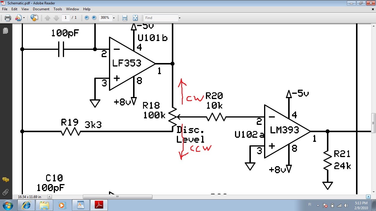

                              Terminology, cable and nulling?
                              I have made my TGSL according to the recipe "TGSL - complete details".
                              Some hundreds of messages ago I had problmes with oscillation in the receiver stage. That calmed down when I replaced one LM358 with one from another manufacturer.
                              The current state is, that the detecting distance of a 2 eur coin is 1cm, yes 1cm in the air. I can null the coils to 10mV, but not a bit lower. It gives a short beep when I sweep the coin just past the overlapping section of the coils, exactly as in the videos in the Youtube. I feel, that it's just about to work, but I don't know where to get the missing 29cm of detection distance.
                              As cable between the coils and the device, I'm using a USB cable, connectors cut off. It has two twisted pairs inside a common shielding. Does twisting make any harm or should all wires bew straight routed inside the shielding? I have made sure, that one twisted pair goes to the TX coil and another to the RX coil. So, the TX and RX signals go in separate twists.
                              I can compare the oscilloscope views to those in the TGSL thread's, I just don't know to which of the sets in the TGSL threads are "correct ones". Hints?
                              I'm not far enough to ask this, but want to clarify it to prevent later banging my head into the wall: when talking CW or CCW positions of the potentiometers, does CW mean the clockwise rotation of the arrowed wiper of the schematic symbol, see CW_CCW.JPG?
                              All hints appreciated,
                              Andy

                                Andy,
                                I think you have some other (serious) issue, cable I think is OK, and even if coil not perfectly nulled you should still get 10-15cm or so. Also most who have constructed TGS or TGSL max air sensitivity is only about 20cm, only a few have attained 30+ cm.... Try looking for short / open or wrong / reversed components, check wirements again...
                                Oscilloscope traces I think the ones Max posted (in TGS Tread) were the best for DD coil, but not absolutelty sure DD is what he used, maybe searching threads will give more info...
                                CCW / CW to me this is strange question, because I would always want Pot to discrimination to increase as you turn CW. I am not Guru so can not say for sure. But again not problem, just hook it up, then test, if descrimination is backwards, then just reverse outer two terminals...
                                Good luck!
                                Molzar
