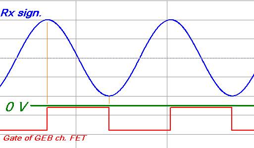

            I am talking about the commercial Tesoro detectors. Check where the sample pulse is located for the lower channel (GEB) relative to the output of the preamp. It must be centered on the zero-crossing. If you cannot locate the sample pulse in that position then your coil is incorrectly balanced.
                [/quote]
                ...just for clarity. With Geb trimmer centered is this what you mean, isn't it?
                • ...just for clarity. Is this what you mean, isn't it?[/quote]
                  Yes - that is correct.

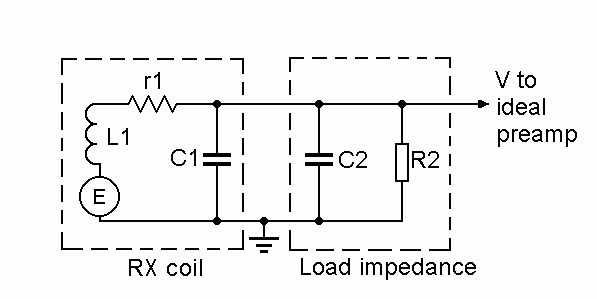

                          Yes, Stefano is correct. The equivalent circuit shows that RX coil is part of Second Order Low Pass Filter. That means we can change the phase lag of receved signal V from 0 to 180 deg if we change the equivalent capacitance C=C1+C2. If you don't believe me, put the following equivalent circuit in AC SPICE analysis. The voltage E induced in RX coil is in phase lead 90 deg relative to TX current. However, the TX coil voltage is not in quarature with TX current because TX coil has resistance and we measure voltage on its capacitance.
                          CONCLUSION: You can adjust phase lag in very wide range by changing capacitance of C2.

                            Your negative phase can also be considered as a positive phase if you add it to 360 degrees.

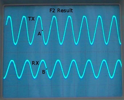

                            If you look at Molzar's post, there is something odd going on there. Figure F2 - see below - shows signal 1 (TX) and signal 2 (output of preamp). On the right it states that the phase difference is -20 degrees (or +340 degrees), but the scope picture shows something completely different. Look at points A and B, they are not separated by -20 degrees. The same goes for F1.
                            There is also clearly something wrong with the ground balance in F7, F8, F9 and F10. The sample pulse is not located over the zero-crossing of the RX wave in any position.
