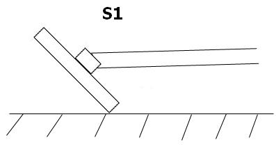

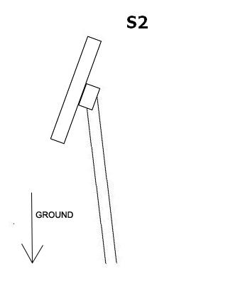

                • Perhaps at this point it is desirable to describe the reasons for the modification TGSL basic version.
                  1. (S1) In this position of coils in relation to the ground, the unit is very unstable with frequent peaks.
                  2. (S2) If the spire rising high above the ground. unit is also very noisy.

                  This is my experience with the first version TGSL plate and coil DD27cm.

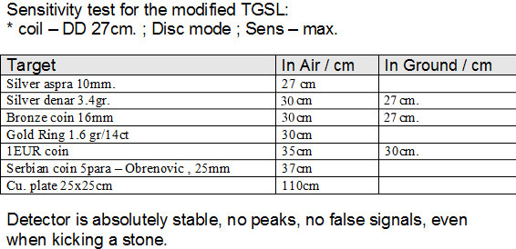

                  The first change I made in Tx, I got a variable gain entrance to the possibility of better sensitivity (in extreme cases up to 45cm in the air).
                  Resistors R25 and R26 I have replaced the recommendation of my friend, and got a little bit slower response unit, that I personally prefer.
                  R29, R31 values increased due to better gain filter, such an experience I had with certain models of devices that I previously made, and the diode D12, which in this part of the much better solution than 4148.
                  Finally with the increased sensitivity and increase the noise. I think that the appropriate filtering and some loss of sensitivity could be found a satisfactory compromise.
                  It remains me a lot more testing on the ground but the results are already very good.
