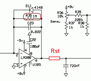

          • My big apology
            My big apology, because of poor visible marks on the capacitor, I have the wrong value.
            The correct value would be 560pF to 720pF that is necessary to determine, depending on the type of IC which is used as the U105. Once again I apologize to everyone.

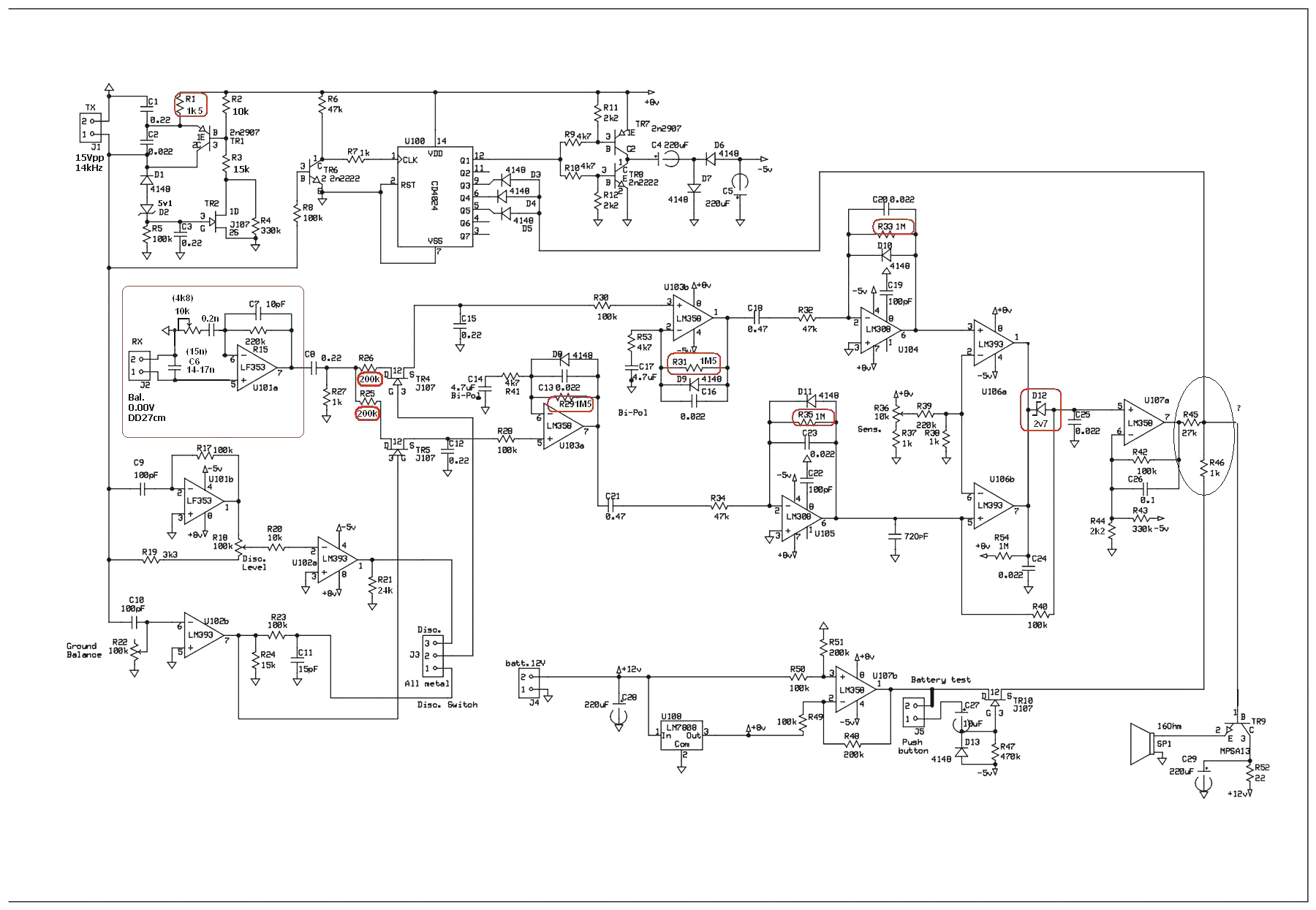

              Another apology. It relates to my posting # 167, which has no attached circuit diagram. I use some other circuit diagram posted by Ivconic, which seems quite different from what shows Stefano in posting # 2 and Vladimir in postings # 171 and # 185. My postings # 167 refers to the following circuit:
              Can someone post me the whole circuit diagram, which discusses Vladimir?
                  This is a circuit diagram with the changes about which I write.
                    Are you suggesting that this mod be applied ONLY to pin 5?
                    Don

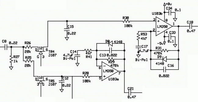

                      • Originally posted by Vladimir View Post
                        This is my method for solving the problem of noise.
                        Try, it is very effective.
                        Greeting
                        Another observation.. depending upon which LM308 this mod is applied to, it can turn the LM308 into a high frequency oscillator. (I tried it.) Maybe feedback to pin 3 of the LM308?
                          I agree, but for me it works perfectly. Perhaps the reason the previous modifications that I used ...
                          • ATTN: capacitive load
                            Vladimir, your capacitive load of opamp U105 creates instability. In theory it is avoided by a resistor as shown.

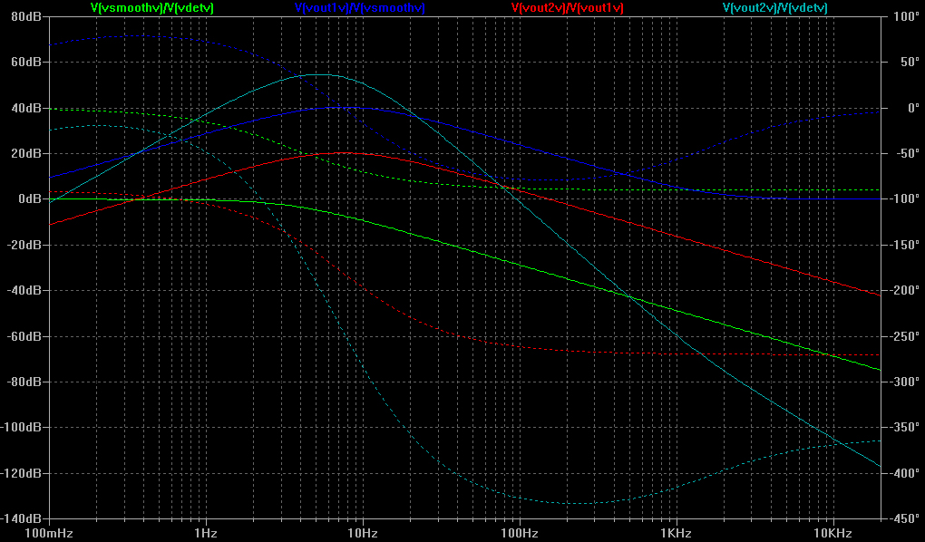

                            • TGSL standard vs. Vladimir comparison, LTSpice

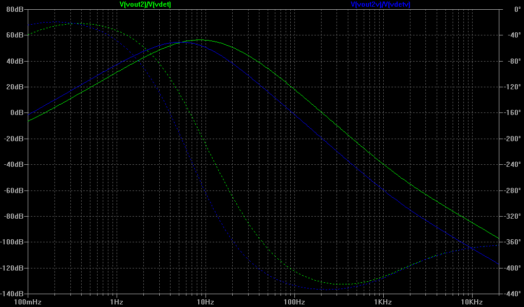

                              I did a crude LTSpice comparison of the TGSL basic filtering, comparing the standard TGSL with Vladimir's modifications.
                              1. The top pic shows the Frequency response (Bode) plot comparing TGSL standard and Vladimir.
                              The green trace is TGSL standard.
                              The blue trace is Vladimir mod.
                              Note that the standard TGSL band center is about 8 to 9 Hz, Vladimir center is about 4 or 5 Hz. Vladimir gain is slightly lower, -1.7 db.

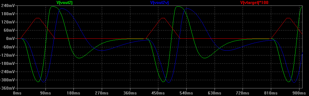

                              2. The middle pic is the response to a target (I made up the target waveform, may not be realistic).
                              The green trace is the TGSL standard.
                              The red trace is the raw target signal.
                              Detection occurs when the response is above 0 volts.
                              Note that there is more delay (25 milliseconds) with the Vladimir mod, as expected with a slower response circuit. This would affect pinpointing. The detection pulse with Vladimir mod is wider (102 milliseconds vs. 70 ms), which is nice, makes longer audio beep.
                              Of course my reference target signal is probably not realistic, but it gives you a comparison.
                              3. The bottom pic shows the frequency response of each filter stage for Vladimir mod.
                              The green trace is the low-pass filter of R26/R25 - C15/C12.
                              The blue trace is the LM358 band-pass filter.
                              The red trace is the LM308 band-pass filter.
                              The cyan trace is all the stages combined.
                              I would note that not all the stages have the same center as the final stage. This may mean the combination is not quite optimally designed. It seems that the first stage low-pass filter is a little agressive, maybe that is the reason. However, if you look at the breakdown of the standard TGSL op amp stages (http://www.geotech1.com/forums/showp...&postcount=250), you see the centers are not well matched there. So Vladimir's mod is not any worse from that regard I think.
                              Conclusion: Vladimir mod looks like it achieves a slower responding TGSL, which may be better for deep targets, but more difficult pinpointing for shallow targets. The standard TGSL stages may also not be balanced as well as they should. Vladimir mod should give a slightly fatter audio beep. I would expect Vladimir mod may have less noise chatter, but can't really tell from this. Vladimir's gain is slightly lower (-1.7 db) than standard TGSL.
                              However, this is just theory. The MD must work well in practice. Only building and testing will say if a particular mod is useful. And of course different mods have different uses. Vladimir's mod may be what I want for dry sand beach hunting where objects go deep. Standard TGSL better for hard, mineralized soil, shallower targets, better pinpointing.
                              -SB
                                I think that leading resistor is recommended also to make the circuit consistent for different chips. What values of R and C are best, is the question. Also, is this the best place to put this filter? And there should be a similar filter on the disc channel to keep them balanced, I think.
                                -SB
