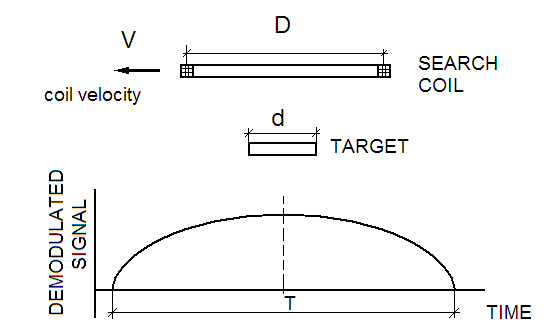

          • Spectrum of demodulated signal
            The ancient method is to calculate period T of demodulated signal because we know diameter D of search coil, its velocity V and target size d.
            The modern method is to connect a spectrum analyzer to output of demodulator.
