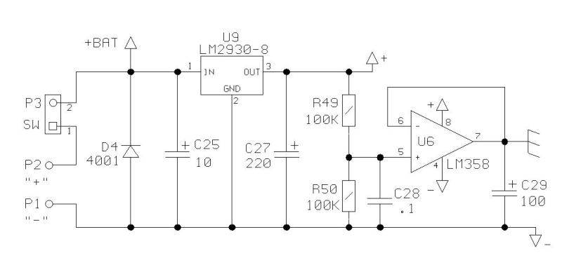

    I disconnected the emitter of TR7 from the + rail. Then I soldered 6V battery pack between anode of D6 and ground (battery minus on anode).
    The detection distance is now about 33cm, but the tone is still faint and short.
    All voltage rails are now quite clean: the 14.5 kHz ripple is below 2mVpp while it was 40mV before modifications.
    There's total of 10 pieces of 330nF capacitors, soldered between the + rail and ground, where they are close enough for a SMD capacitor to reach them. I think these capacitors are not needed if the minus voltage is taken from a separate battery.
    I will next try to get the tone loud and long, as it is up to 20cm distance for a 2 euro coin. If successfull, then I conenct the TR7 back and install some bypass caps more. It is not convenient to have two batteries.

      You achieved distance from 15cm to 33cm with separate power supply. Great!
      What is your coil shielding? (mylar, foil)
      I managed achieve a little better distance when shielded coil with less overallaping shielding.
      It could help when making another coil.
      About dfbowers mod: do you have only shorten r37 or connected to -5v also?
      Sound is weak in all tgsl, but Ivconic used time delay circuit with 555 to make it constant in all distance.

            It might be good idea to change all bypass electrolytic capacitors to low ESR ones to lower the ripple.

              There can be used IC chip 7660 for -5V. I remember it was discused on tgsl thread, need find some more information about it. Not shure if it is good solution here.
              Also i attach White's Classic ID power supply circuit, it very likely to tgsl's, but some differences.
              Whites don't use chopper stage on this Classic id circuit. But voltage is 8V only instead of 14V in TGSL (8+6 (not 5 when measured) )

                    When I first built the TGSL on a breadboard I noticed terrible voltage spikes on the supply rails at the TX frequency, due to the negative supply circuitry. I was very concerned and thought it must be fixed.
                    But other people's TGSL seemed to work very well. So I began to think maybe the voltage spikes just don't matter. First, because they are at the TX frequency, they will not make a problem at the Synchronous Detector, because they would just make a constant voltage output. And the rest of the circuit is a very low-bandpass filter that probably ignores them. Well, I'm not sure, I recall I thought I saw the spikes in the op amp outputs. If they could chop up the inputs to the final comparators, that might act like noise and kill weak signals. But those spikes are so fast, I don't think they do.
                    However, if we are seeing new evidence that these spikes are a problem, this is a good reason to take measures to reduce the spikes. However, be careful in case they are not the real problem.

                        Tgsl works good with separate power supply and not so good when only some capacitors are connected. I wonder if 7660 could work with less spikes and rails than chopper stage power supply.
                              How about capacitor selection in you project. Since it works better on a separate P.S. maybe look at what you are using for polarized caps?? Can you post what you are using and maybe we can compare the ripple specs?
                                I was talking about Mullihaka's TGSL. I only suggested ic 7660 for -5V power supply and did not tested yet as Mullihaka did. Please read previous page.
                                So this question about caps should be addressed to him.
