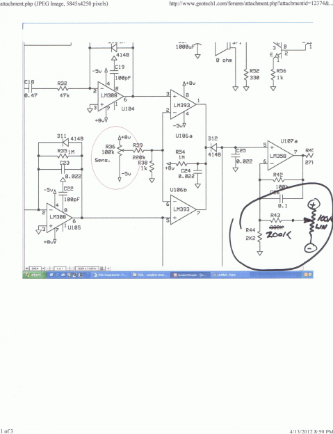

    R40 is there to prevent chatter.
    I actually analysed this circuit and posted my results at the IGSL page. There are some misconceptions regarding the circuitry here, so here are my two cents.
    Chatter-wise most of the job is done by R42 C26. C26 is by my opinion ~4 times too large, and if left as is it just produces odd delays in audio response at weak target responses.
    R43 sets the output threshold level to ~1.4V to linearise audio (darlington) and it is best if left as is.
    "Sens." potentiometer is actually setting a threshold at which comparators will trigger, and subjectively it does not do much, because the same targets will sound the same at various different settings of this pot. If you set it too high you'll miss lots of deep targets, but the shallow ones will sound the same.
    What you can do is replacing R44 with a real potentiometer. For my IGSL I bought a real stereo pot (2 channels) because variable R44 provides a real audio level control. OK, my values will be somewhat different, and I did some other changes as well. Anyway, if you want to experiment, replace R44 with 100k lin pot, and replace C26 with 22nF. Leave everything else as is. Or you may use my other values and replace R44 with 10k lin pot, replace R42 with 10k, R43 with 47k and leave everything else as is (don't replace C26). In case R44 is turned down to 0ohm, LM358 turns into a comparator and produces pure binary response.
    Here is a LTspice file of this circuit for your pleasure (400nF at the rightmost end is a piezo stand-in)

      • Well I tried the first suggestion and changed R44 to a 100K pot and C26 to 22nf. This did make an improvement in that I can now get an audible beep with a coin waved about 32 cm above the coil. As suggested, turning the pot all the way to zero ohms makes the response very binary. For now I am going to leave it that way but it still isn't exactly what I was looking for and I probably did not explain it properly.
        I ran a little test by unplugging U101 and connecting a 100K pot between +12 vdc and ground with the wiper connected to the junction of R45 and the base of TR2. I found that the actual threshold point to get diodes D3, 4, 5 to conduct is +.44 volts. Above that the audio get louder and below that it is completely silent. Much like the squelch control on a two way radio.
        With U107 installed again, Pin 7 measures a -6.13 to -6.14 volts. Pin 7 must go from -6.14 to at least +.44 volts before any audio will be passed through the audio circuit. What I have been trying to accomplish with a threshold is to have a control where I can move the voltage on pin 7 closer to the .44 volt threshold. Exactly where it should be set depends on the amount of noise that is present at a given location.
        I feel that not hearing a beep when pin 7 is not being driven above the threshold is leaving something on the table depth wise. Probably not a lot but that is what I am working towards. From what I have seen on my scope, getting an air test of about 40 cm on a 2 Euro coin should be possible.

        • You seem to be happy with binary output
          Anyway, I have a solution for you, and I know you'll like it: replace the diode D12 with 68k resistor and enjoy - it will give you that extra boost for low level signals, however, It will ruin their level response a bit, so it will become binary-like for small signals. If you find it too much of a boost, just replace R54 (1M) with larger value, say 2M2. Anti chatter functionality remains untouched.
            Actually I prefer proportionate audio. The original 2.2K for R44 was a good choice but by installing the pot in it's place, I was able to find a sweet spot where the proportionate audio is much more pronounced. I did take it out and play around a bit this afternoon and found that full binary (zero ohms) gives short cracks of audio which are not pleasant to listen to. Right now I am thinking that a 25k linear pot with maybe 560 ohms between it and ground will be a good compromise. The way it is now, much of the rotation of the pot causes little change. I am going to take it out this coming weekend for an overnight metal detecting trip and I am sure that will give me a lot better idea on where to go with it.
            As it is right now, I would rate this TGSL equal to my At Pro for sheer depth ability and somewhat better than the Ace 250, which is saying a lot because both Garrett's are good detectors. Of course depth isn't everything and the Garrett's have much to offer with their audio.

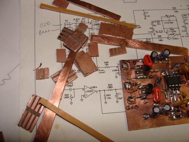

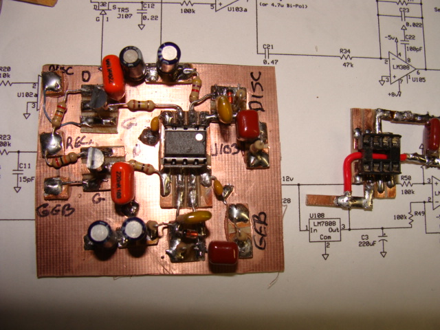

              • Hey Jerry,
                I like your prototyping work. Good idea. Thanks for sharing this.
                Cheers,
                Aziz
                  Hey Jerry,
                  Cheers,
                  Aziz
                  Thanks, but I cannot take credit for it. I got the idea from this guys article: http://www.k7qo.net/manart.pdf
                  I have used it for building radio receivers so there is no reason why it will not work for a metal detector.
                  Jerry

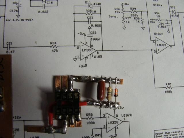

                              • Another thing I picked up on yesterday is my original attempt at the threshold modification to my original TGSL (Ivconic board) was actually working better than I realized. The picture below shows the change I made several months ago. This is the threshold circuit from other Tesoro products like the Lobo.
                                Originally, I was not happy with this mod because my goal was to be able to set a steady background tone when searching for coins. This is the reason why I proceeded to mod my second TGSL (EDU board) according to Davors suggestions.
                                What I accomplished with the EDU board is very nice Proportionate audio which is settable from a low volume to total saturation. However, there still is no background tone.
                                I took the original TGSL out to the test garden yesterday. By chance, I turned it on while the coil was about three feet off the ground and heard the very nice, stable background noise of the TGSL. No crackles or pops, just a nice tone. It took me a while, but I figured out the I had the threshold set to max and backing it off quieted the tone. However, when I lowered the coil to the ground, the tone also went away. The reason this was a surprise is I normally turn the detector on when the coil is close to the ground so had not heard that steady tone before. I thought my mod was not working.
                                I then learned that the area near the ground in which the tone would not be heard was controllable with the GEB setting, very similar to this video: http://www.youtube.com/watch?v=bhTtkGCisfQ
                                So my next step is to incorporate Davor's mods along with the threshold mode shown below. Hopefully this will combine the best of both detectors.
