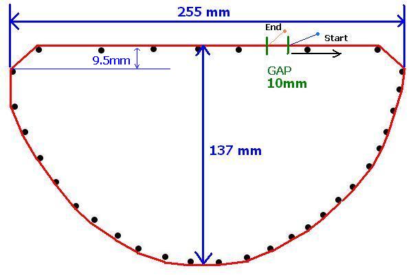

                • Vladimir could you send a picture of your stencil on which you are winding your coils a specialy with geometric parameters (all radiuses etc) ??
                  best regards;]
                      best regards;]

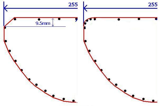

                        • vladimir..another thing. does it realy matters the shape of "d"?(picture) because i seen many ideas
                          best regards and thanks for help

                            • Originally posted by lunamay View Post
                              Elasticity of the wire itself forms a transitional arc shape at the corners.
                              • Originally posted by Vladimir View Post
                                I don't think that it matters too much. I have built configurations with square corners and round corners and I cannot tell much difference.
