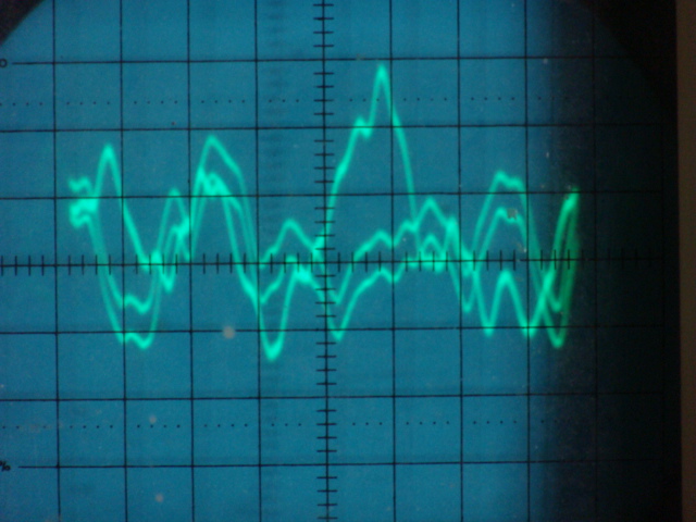

          • TL081 Outputs.
            I checked the output of the TL081 op amps and found that the GEB channel had a lot more noise than the Disc channel. I tried a few different TL081's and found one where both channels are fairly similar.
            The picture is the outputs as measured on the inputs of U-106. The scope set for DC and turned up to maximum gain of about 2 Mv/div, and the RX input is shorted at J-2. Both channels were zeroed to the center line so there is somewhat of a positive trend for both channels. The Disc channel have about a 1 Mv square wave superimposed on it so it shows up on this picture as two parallel lines. Can not show both the residual noise of the outputs and the actual square wave in the same picture since there is a wide difference in frequency.
            I wonder if the filtering of the negative supply is such that 1 Mv switching transients are normal for this circuit. It certainly does not seem to bother the way the detector works and when the scope gain is cut back to say .5 volt/div, you cannot see it at all. I did look at the negative supply with the same scope setting and it has a larger square wave of same freq.

              I am very surprised that you can see a difference in noise between chips, since it is the last stage in the amplifier/filter chain, and the noise the chip adds should be negligible compared to the amplified noise coming in the inputs. Maybe something to doublecheck.
              The bandwith of the filter is so small that virtually any op amp should be able to handle it from a frequency response standpoint. The only critical factor that I can figure out is the output bias level, which can affect the apparent MD performance because it affects when a target signal crosses the comparator thresholds. That is why a "precision" op amp like the LM308 is used as far as I can figure.
              Unfortunately I have enough EMI noise in my area that I can't do any depth related testing. I'd like to try some alternate chips and see what is going on.
              I don't think I've seen a "double" trace like that due to superimposed square wave. Is the square wave at the TX freq? It might even be picked up in the air by the probe?
              I've certainly seen supply spikes all over the place, but haven't seen a proven effect of any -- I don't know if they could trigger the comparator or not or are too fleeting.
              -SB
                -SB
                I started out just measuring the DC offset of the TL081 op amps like you suggested but I noticed that the readings were bobbing around a median value so I looked at it with the scope. The Disc channel had a slight negative offset and the GEB channel was almost a volt positive but both varied plus or minus.
                The picture is of a very slow, low frequency signal. I had to slow the sweep on the scope way down and then take a timed exposure to get the results shown.
                I think the superimposed signal is from the negative power supply but the odd part is why it only appears on the Disc and not GEB channel. I suppose that gives a good starting point for further checking. I will set the scope up to show that if I can but I doubt if I can get a clean picture on it because the low freq component of the overall wave keeps shifting it up and down.

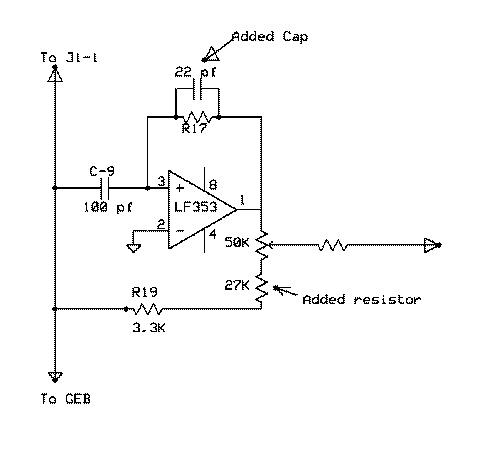

                  • Discrimination Bandspread
                    I changed R-10 from 100k to 50k and added a 27k resistor between the lower arm and R-19. The 27k was arrived at by experimentation. I started with 50k fixed to keep the over all resistance the same as what it was. However the point that nickels discriminated out was too far towards minimum rotation and I could not pick up small foil even at full CCW. Changing to 27k permits foil to be accepted. I installed a knob that has a skirt with a 0 to 10 scale on it so it makes for accurate readings. Here is a short table of what I now am able to discriminate with this setup:
                    Junk ring.....2.5
                    Foil............ 3.0
                    Nickel......... 3.6
                    Pull tab....... 3.9
                    Ring pull tab 4.8
                    2 Euro Coin 5.5
                    Zinc penny.. 7.7
                    Copper pennies, dimes and quarters cannot be discriminated which is the way I want it.
                    I had some misgivings about not having the resistance total be the same as before removing the 100k pot but that does not seem to be critical. For now this settles the discrimination issue. I spent a lot of the weekend moving the frequency from 14.22 to 14.5 khz and finding a pair of LM381's that are closer to a match. I also went back to the exact same resistor for R3 that I had changed with a pot a few weeks ago.
                    So now I have the same little bump in the TX sine wave that I had before all of this started. As far as I can tell, it does not make any real difference. After I had everything reassembled, I took it out for a test run in the coin garden and I really like the results. Deepest coin I have buried is six inches and the TGSL hits that with ease. I am sure I can get 8 inches in my soil with the 8 inch coil.
                    I also found out that my method of placing my chunk of ferrite on the ground and swinging the coil over it was over correcting the ground balance by a bit. It was reasonable close which is why I was having pretty good results but balancing to the ground alone gives a noticeable improvement in depth. For example, what was faint is now real clear. I can now run sensitivity nearly at max with the threshold backed off slightly and have a fairly calm background tone. It warbles and crackles a bit but prefer to have a slight threshold tone.
                    So for now I am going to hunt with it and start working on the next build.
                    Jerry

                      Nice customization for your personal preferences!
                      If you put a tiny trim pot for the 27K resistor, you could "dial in" your choice of DISC range for the DISC pot.
                      -SB
