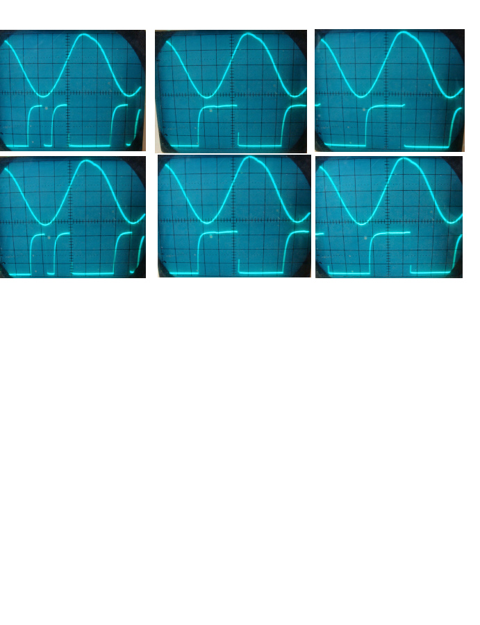

  • Originally posted by Jerry View Post
    Hi Simon,
    Here are a few pictures showing what happens while adjusting the TX oscillator. The changes with just a little distortion in the TX sine wave is interesting. The bump produces noticeable ringing. The upper trace is the TX signal measured at J1 and is set at 5 V/div. The lower trace is U101b, pin 1 and is set at .2 V/div. Same setting apply to all pictures.
    First picture is the TX oscillator (top signal) tuned for a clean sine wave.
    Second shows the TX oscillator with about as much bump at the top as was there before I added the adjustment pot.
    Third is somewhat in between with just the slightest of bump at the top. Even with that, there is still ringing.
    Interesting at how the Disc pulse amplitude goes up with more distortion of the TX sine wave. I suppose the next question is how much is needed for good discrimination. I am too wiped out right work on it tonight but it gives me quite a few ideas.
    Thanks for suggesting this, it is interesting.
    Jerry

    Hi Jerry:
    I've seem some crazy waveforms at u101b pin 1, but yours looks particularly unfamiliar - can you confirm you are measuring what I think, which is: the output pin of LF353 that connects to the DISC pot?
    I think maybe you are scoping pin 2, the inverting input of U101b (LF353). The output is more revealing as to how it affects the sync pulse.
    Also, to really see what is driving the sync pulse, try scoping U102a (LM393) pin 2, the inverting input of the comparator connected by resistor to DISC pot wiper. Then as you turn the DISC pot, you can really see why the phase shifts where it does. Maybe that is what you meant to do anyway.
    Regarding the "double" sync pulse that happens at one extreme of the DISC pot -- I had originally thought it was due to all the "ringing" in the LF353 output. Today I checked (with dfbowers' TGSL) and noticed that the double pulse happens when the comparator is driven purely by the TX oscillator signal. My guess it is due to the oscillator voltage going beyond the "rails" of the comparator and causing the glitch when the DISC pot mostly selects the oscillator signal.

      Hi Simon,
      Just walked out to the shop to confirm what I was hooked up to and you are correct, it is Uio1b pin two that I took pictures of. I must have been more tired than I thought, I just hooked it up quick, snapped a few pictures, shut everything off and called it a day.
      It is raining here today so I think I can get some more pictures. I will check U101b output pin 1 and also U102a pins 1 and two.
      However the last series of pictures is still interesting in that it shows a huge gain in the pulse along with increased ringing with increased distortion. So it was still useful in that sense.
      Will post more later this afternoon.

        Ok. BTW, I think the ringing mostly happens when the LF353 "saturates" due to out-of-bounds input, and clips the output, going nonlinear. I'm guessing that your input signal you scoped suddenly spikes when the op amp is decidedly outside the linear range. The original TGS had a lower TX oscillator voltage which I believe did not cause this condition -- we've basically "super-charged" our TGSL oscillators by removing the regulator JFet.
        The TX signal "blip" also can make a really hefty blip in the LF353 output, but it doesn't actually ring I think if the LF353 is operating in a linear mode; but it can cause some weird DISC phase shift motion sometimes.
        -SB

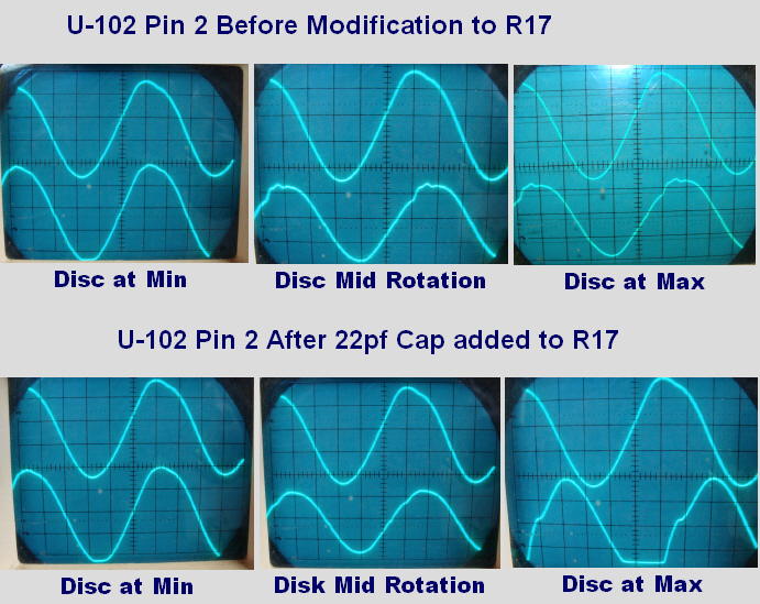

        • Discrimination Issue Solved!
          Well I made a lot of progress this afternoon and I think I made some discoveries as well.
          I checked the scope signals at U-102 pin 2 and also at U-102 pin 1. Overall, the output of U-102 (Pin 1) proved to revealed the most information that was useful for my problem. I have noted before that this square wave (The Disc Pulse) would only move so far while turning the Disc control clockwise and it would hit a point were it would stop advancing in step with the Disc knob.
          I Added a 68 pf Cap across feedback resistor R17 and now the Disk Pulse moved much further to the right as compared with the TX pulse. This increased my discrimination by a lot, too much even. With the 68 pf cap on R17, I can discriminate out U.S. Quarters! This is more than what I was looking for so I reduced it to 22 PF and that will disc out zinc pennies and not quite silence copper pennies and dimes. Exactly what I was looking for!
          It did not settle the issue of shifting where nickels discriminate out. It used to be five on my very crude scale of 0 to 9 and now it is a little over six. (6.1) I may revisit the TX operating frequency but I can live with what I have now. Especially since a little further experimenting may have given me a good work around.

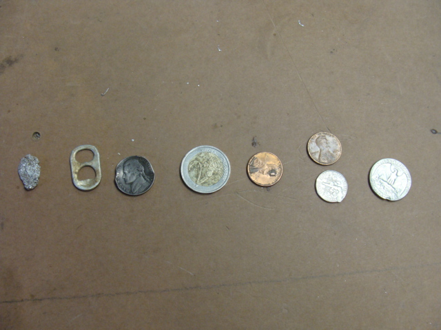

          As of right now, my TGSL discriminates as follow. On a scale of 0 to 9:
          Small Foil ........... 5
          Nickel.................. 6.1
          Pull Tab............... 6.3
          2 Euro Coin ........ 7.0
          Zinc Penny ......... 7.5
          Copper Penny...... 8.0
          Quarters cannot be discriminated.
          Notice that the discrimination scale is compressed into about half of the rotation of the Disc control. With that in mind, I shut the detector off and started measuring DC resistance between the wiper of the Disc Pot R18 and ground. I discovered that from 0 to about 2.2, the reading stayed at a constant 3.3K. This has me puzzled since I not see a 3.3K path to ground on the schematic. Will have to check R19 for proper placement tomorrow.
          Sticking with that 2.2 number a little further, earlier I had made a note that the Disc pulse would not start moving to the right until it reached 2.2 on the disc scale. This is also the same point where the pulse actually started to move the double blip in the Disc pulse went away!
          I was going to mention another possible change but will hold off until I find out for sure the status of R19.
          I knew this was going to get a bit long, so I dumped the pictures of U102 pin 1&2 into single images. The first one is captioned and is of the input of U102, pin 2. the second is of the output at pin 1 and the captions for disc settings would be the same.
          I also included a pic of the targets I used as test subjects for the discrimination test.

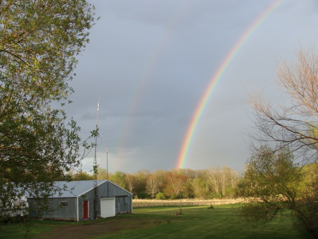

                The last picture is probably the best rainbow I have ever seen.
                A good way to end the day.
                Jerry
                If you look to the left of the photo, you will see that it is in fact a double rainbow.
                Maybe there were two pots of gold.
