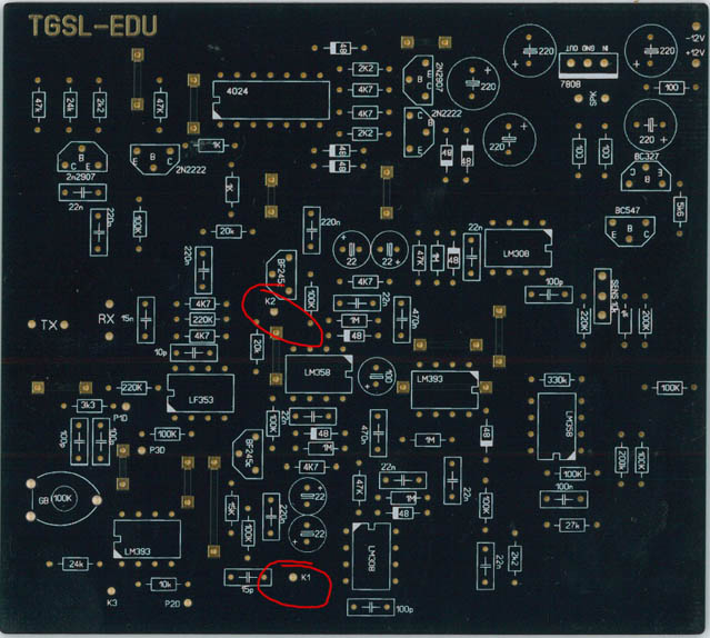

          • I don't know what you refer to with K1 and K2, but you must be close.

              • I also didn't understand what K1, K2 are --Do you mean J3-1, J3-2 of Disc switch? Are you in ALL METAL or DISC mode? Do the beeps occur in both modes?

                • K1 and K2 is disk switch wires markings on silverdog's pcb ... sorry about confusion
Name:	pcb parts.jpg

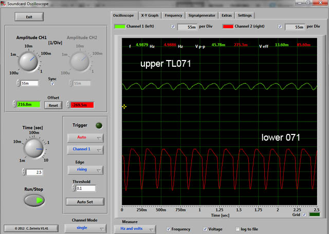

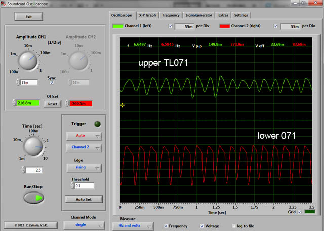

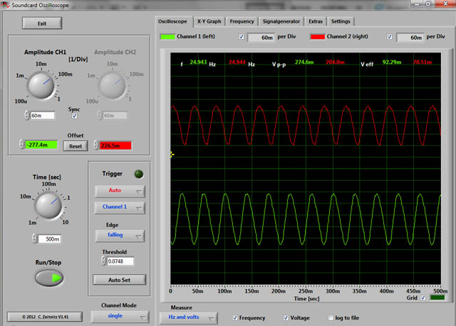

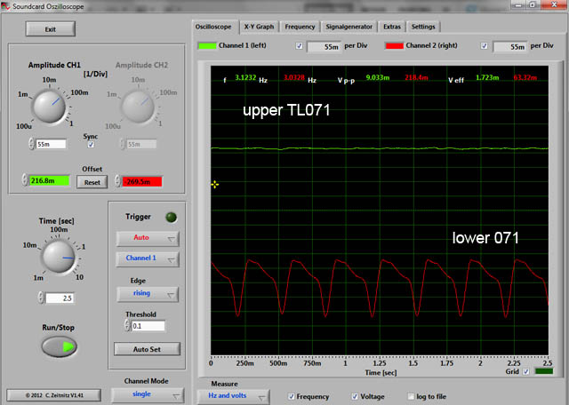

                        • I have tried scope on pin 6 of both TL071
                          upper channel is upper IC
                          first one is big overlap in coils no beeps
                          second one is
                          close to nulling - smaller overlap of coils
                          no metal present - beeping
Name:	nulling no detection.jpg
                          third one is me waving coin across coils and detector beeping

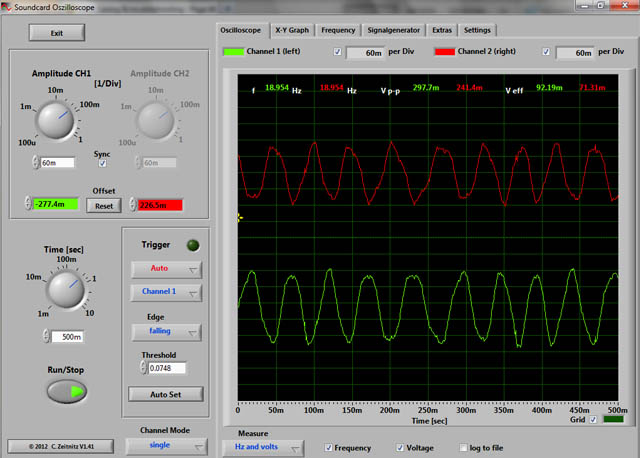

                          • here is screenshot of audio in green and open channel - nothing is connected

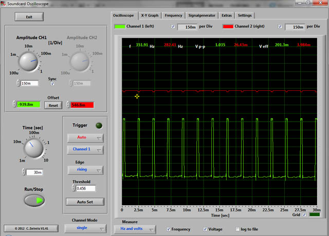

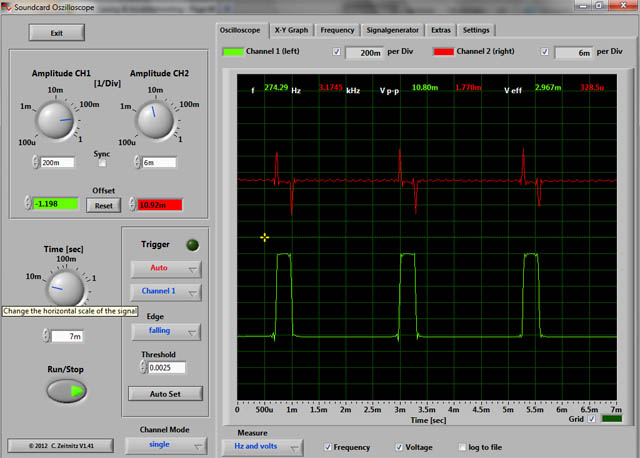

                            • graph 12V and sound output with beeps
                              magnified disturbance so you can see what it is
Name:	12V and sound.jpg
                              • Two gates TR4 and TR5 on two channels ... total silence - no beeps ....
                                (only if sens pot is on 3/4 smaller beeps as it should be)
                                coils close to nulling point but no beeps ... only difference is connection with scope ... ??
                                please explain this to me if you can
Name:	gates of silenece.jpg
                                gates of silence
                                and waving metal over coils
Name:	gates with detection.jpg
