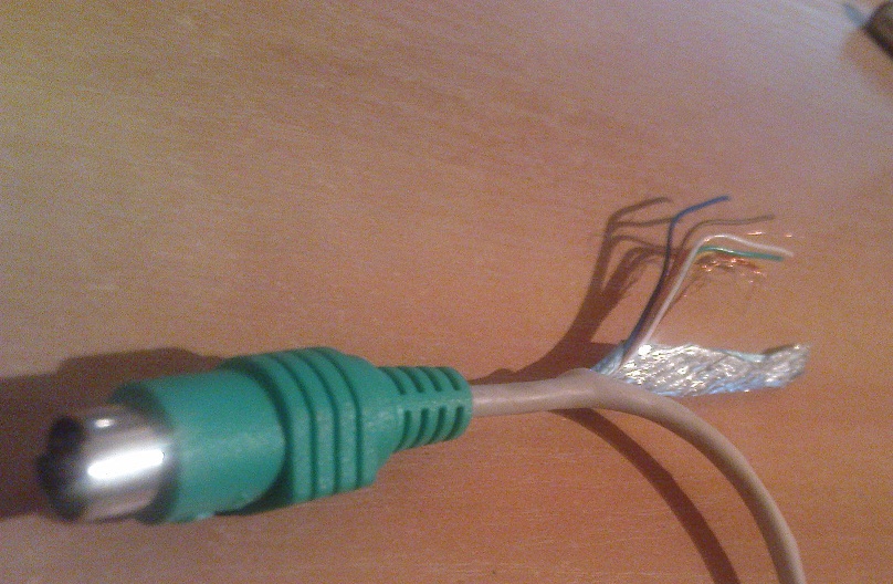

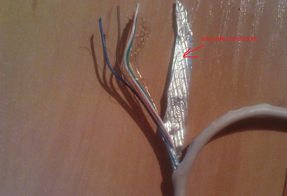

        • dfbowers.. so can i use a one side conductive al tape like this one used in mouse cables? or i have to get both side conductive tape? is there a difference?

            • Originally posted by lunamay View Post
              Lunamay,
              Either will work. You just have to be careful about where you wind a ground wire with metallized mylar to make contact with the conductive side.
              Don

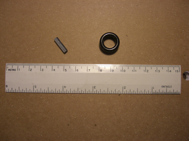

                        • ferrite tests
                          I just redid some ferrite tests using some dfbowers unshielded coils.
                          I still seem to get the results I reported previously. Regardless of the null signal phase, my ferrite targets signal seems to drop out at about the same GB pot setting -- around mid position or slightly past it. Unfortunately the test is not very clear, there is noise, but that is my best try.
                          So, based on Qiaozhi's description of the ground effect, which I'll accept as true, I have to consider my choices.
                          Basically, my ferrite targets do not represent the ground effect. They will always lead me to put the GB pot in the same position regardless of null. So I don't feel using these ferrite targets accomplishes anything for real ground balancing, which should always be based on the RX signal zero crossing. If over time your null signal slips around (due to coil aging, bumps, etc), according to the ground model Qiaozhi describes, you'd better readjust your GB pot accordingly. And his recommendation to start by setting your RX null signal with the GB pot at the middle position gives you some leeway on either side.
                          Having said that, what if the ground contains bits of ferrite target that are like the ones I have been using? They seem to have a characteristic phase that comes in like a real target and their phase seems to be in the range of the GB sync pulse, because I can block them by moving the GB pot to mid position. This would correspond to the "dual ground model" where two different kinds of effect are present.
                          Happily, because Qiaozhi starts with his GB pot in mid position and adjusts the null phase to zero out there, I kill two birds with one stone. My ferrite targets happen to cancel out there too.
                          But what happens if my null phase slips, and I must now change the GB pot back toward a lower setting to match the new zero crossings. Suddenly my ferrite targets will start being detected again and make unwanted beeps.
                          I don't know what is really in the ground. But if it contains ferrite samples that act like my targets, then my conclusion is that I would want to ground balance as follows:
                          1. Set my GB pot to just knock out my ferrite targets -- maybe a little beyond in case of null slippage.
                          2. Now adjust my null signal phase zero crossing to lie under the GB sync pulse center.
                          3. There may be a small adjustment in phase needed to anticipate a small constant shift due to a slightly conductive ground that does not vary. I haven't figured out which way this would shift the null, but the GB pot could be adjusted slightly for it. If this would involve moving the GB pot lower, then I would move the null phase a little higher instead, because we don't want to lose our setting for rejecting the small ferrite targets.
                          4. Now glue my coils carefully and don't allow any slippage of the null phase.
                          If in fact the ground never contains anything that could produce a signal like my ferrite targets, then I'd just pick the center pot position and not worry if the null slips to a lower position. If it does contain such targets, I might advise cheating toward a higher position in case the null slips. But going higher I think reduces gain for normal targets, so what's a mother to do?
                          In general, if we want to ground balance based on Qiaozhi's ground model, the null phase is quite critical, since the GB pot can only move the sync pulse about 45 deg (more like 35 deg for my detector). To hit the center of that range, you need to really be careful with your construction.

                            A word about ferrite.. Obviously we all have different samples, but several of mine are nearly the same. A clay brick can closely approximate the ground as well (obviously all bricks can be different too). I have found that some of the clay bricks that I have closely approximate the soil where I live, so I can GB indoors. My ferrite slugs tune out slightly clockwise on the GB trimmer from where clay bricks do. So.. probably a safe bet to GB on ferrite.
                            Another interesting point. Several of my detectors have fixed GB settings not the same. My X5 responds positive to ferrite ..and my Cibola responds negative. If I GB my X5 to the ground, then Ferrite will respond Negative. So, once again.. I think that ferrite is a safe bet.
                            If anything, for soil where I live, I can turn my GB trimmer Counter clockwise from ferrite a little.
