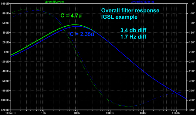

      If you want to replace 4.7uF bi-polar with two back-to-back electrolytics, you should DOUBLE the value of the two capacitors to 10uF for a series grand total of 5uF. If you put two 4.7uF capacitors in series, their combined total will only be 2.35uF.

        I should point out that on the TGSL we used two 10 uf caps back to back to give an approximation of a 4.7 uf.... It was actually five but with tolerance on electrolitics being so wide, it was close enough.
        Two 4.7 uf in series back to back is going to halve the value. It should still work but will raise the freq. of the filter I would think.

            You're correct, wrong value will mess up the filter (assuming you like the filter the way it is).

                  My simulation shows the wrong cap will cost you about 3.4 db gain and raise the filter center frequency 1.7 Hz.
                  Probably would hurt depth a little; maybe not significant. With our larger coils, I would want to err in the other direction (larger, not smaller cap).
                  -SB

                        I would just go ahead an put in non-polarized ones, either a 4.7 uF (and jumper the empty space) or two 10 uF non-polarized in series as per the PCB layout. People have been very successful with the back-to-back 10 uF polarized -- but I personally would use non-polarized until I learn more about the long-term effects of back-to-back polarized.
                        I will guess that using the "wrong" capacitor (two 4.7 uF in series) would make an MD that would be superior for smaller shallow targets in conjunction with a smaller coil, but it would not respond as well to deeper targets in conjunction with a larger coil.
                        If you look at another TGSL modification by eduardo and produced by silverdog, you will see those capacitors are changed in the other direction -- he uses 11 uF for that capacitor, and uses a 1 Meg resistor for the LM358 feedback resistor -- this makes an even slower and higher gain response than the IGSL -- maybe better for large coils and deeper targets.
                        We have not really proved this in the field, although dfbowers has built and reported on eduardo's modification http://www.geotech1.com/forums/showp...postcount=4716 .
                        So choice of filter characteristics is not a cut-and-dried subject. But for the IGSL, I would definitely use the 4.7 uF or 5 uF value, not 2.35 uF.
