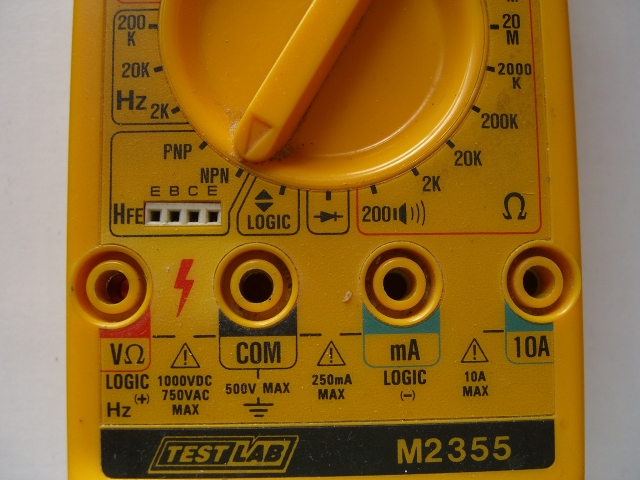

                      • duff parts
                        I remember years ago it wasnt uncommon to get resistors from known manufactures/suppliers to the radio/tv trade etc where they were sending out resistors with wrong colour codeing, what a pain in the *** that was, tryed to get into the habbit of checking each component where possible before installing, but to this day I still forget.
                        Another one to look out for is pin outs ID, This particular project uses mainly T092 packages, and that in no way tells you its EBC 123, there are 5-6 pin out combinations, and that is another reason why we are getting so many conflicting storys between say TL071/BF245. Note: you can purchase transistors with same part ID same package, but different pin outs.
                        Try contacting some of the suppliers and often even they dont know, so again its another pain in the ***.
                        The best way I found of working out pin out conections is first of all get you multimeter and find the Base which set on 20 mega ohms range, you will find continuety between base and emitter and base and collector one way very much like a diode reading, the polarity will depend on wether its a PNP or NPN, the emitter to collecter reading normally will read O/C on 20mega ohms setting.
                        So with this first simple test you will know if its PNP or NPN and you know your base conection.
                        To work out the collector/emitter conections I plug the transistor into the hfc socket on one of my multimeters and swap between the E-C leads until I get the most sensable reading which is normally the lower readings of the two.
                        If anyone here has any better ways of doing it please bring it on here because its a very important subject that far as I know has been discussed enough.
                        Hope this helps a little.
                          I use a cheap multimeter, as shown below. It has the ability to test bipolar transistors and measure hfe.
