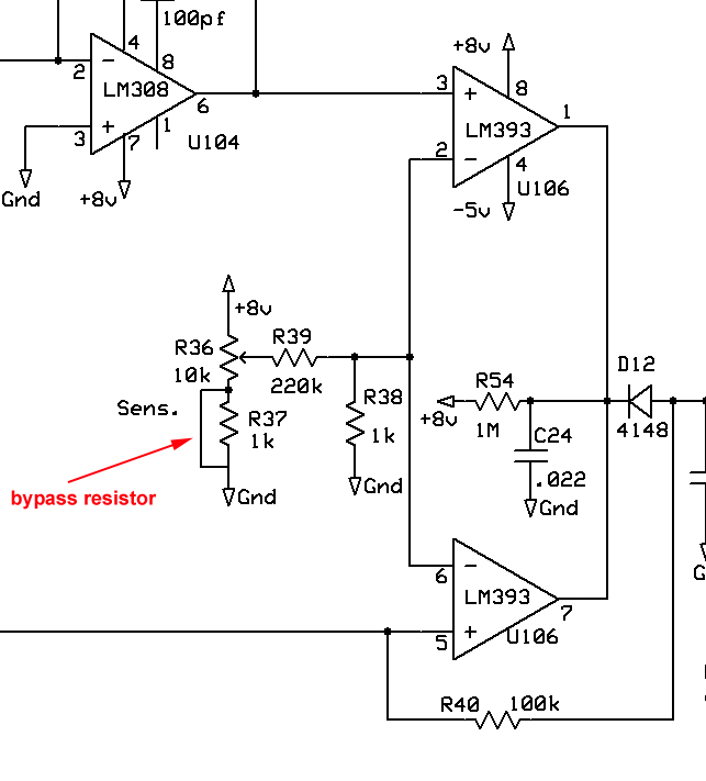

                          When you pot your coils in a permanent shell and take it outdoors far away from the city it may work very well.
                          However, I suggest you try the "dfbowers mod" of the sensitivity circuit. You simply bypass the 1k resistor R37, which is easy to do with a jumper wire.
                          Then your sensitivity control will have more range.
                          Otherwise I will be interested in what you and Danny find with troubleshooting.

                            Your TGSL appears to be working great to me! It looked like more than 22 cm in the video.
                            Cheers,
                            -SB
                            hello simonbaker
                            that video in youtube not me . I want to mention I ues same coin But I get 22cm on my tgsl.
                            and I tried what you said but did not succeed is still weak sensitivity.
                            Thank you for your interest
