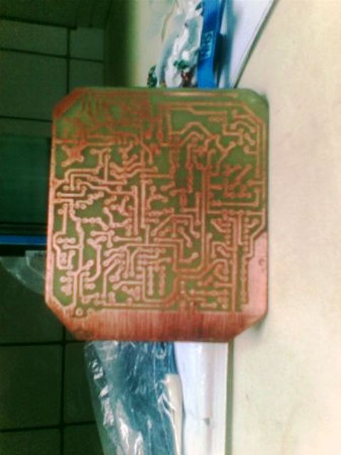

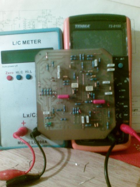

                        • ashefr10 can't post; needs help TGSL
                          Originally posted by ashefr10
                          hello, I'm not a sinusoid wave output of my LF353 but a saturated signal on tgsl. why?
                          Hi ashefr10:
                          It depends on which output you mean. Pin 7 output is the RX signal. If that is saturated, then it sounds like your coils are not "balanced". There is a fairly exact region of overlap where the "null" RX signal is small enough to not saturate the LF353. You just have to adjust your coil overlap carefully while watching your oscilloscope.
                          If pin 1 output is saturated, it depends on how badly. This output is the delayed TX signal for driving the discrimination sync pulse. It is best if it is a sinusoid, but often the MD will work quite well even if the output is somewhat "clipped" and has some "ringing".
                          However, it may help to put a small capacitor in parallel with the feedback capacitor R17 (for U101b op amp). Use the smallest one that works, as it slightly shifts the sync pulse.
                          *** It would be best if you could also post this question to the TGSL thread; my mailbox is getting full and I can't answer too many questions here.
                          Cheers,
                          -SB
                          other issues, I have a TX which is 14 khz RX but also when it should be of approximately 16 kHz as provided on the oscillograms. I do not understand what a parameter is on C6? thank you again for your quick answers
                          14 kHz is OK, it can work with correct RX coil and C6 value. Normal TX freq is 14.5 kHz, not 16 kHz.
                          What are the inductances of your TX and RX coils?
                          C6 is .015 uF normally.
                          Please post this question and future ones on forum so we can answer better.
                          -SB

                            • tgsl frequency 16 khz for RX COIL
                              hello, I want to know how to change the frequency RX, because I have 14.5 and 14.7 kHz for TX to RX and not 16. So I want to know how to change the frequency of RX 16 khz to do it. THANK YOU
                              __________________
                              hello , Nico
                              Hi Nico:
                              TX frequency of 14.5 or 14.7 kHz is good!
                              RX resonant frequency is determined by the RX coil inductance and the parallel capacitor (typically called C6, .015 uF), and is around 16 kHz. You can use a formula to adjust to a different value of C6 if your RX coil inductance is much different.
                              Look at this link for more information: http://www.geotech1.com/forums/showp...&postcount=494
                              Post any other questions here. Look at Qiaozhi's message above for advice on getting permission to post messages.
                              -SB
