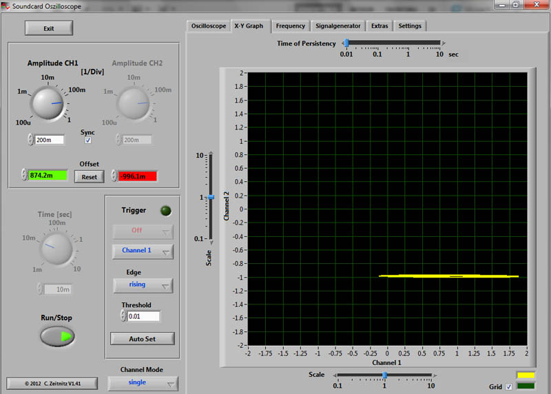

  • By moving coild made this ...
    at this point md starts to beep ... cant stop it by pots

    • Originally posted by sdesic View Post
      Used TX and pin7 on X-Y graph
      made it pretty adjusted phase so few lines are drawn ... I think
      as I don't know what I am doing
      GB on max (down)
      K1 and K2 connected
      [ATTACH]25102[/ATTACH]
      Looks like something is oscillating
      Should be an ellipse - the angle of it depending on phase shift between disc and Geb gating signals.
      S

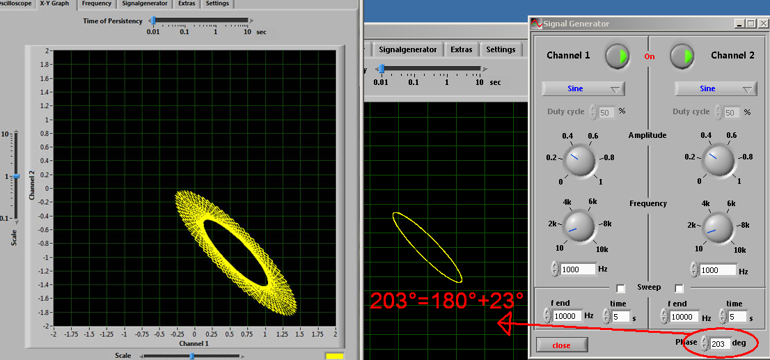

      • What to do next ?
        • The first graph indicates a phase shift between Rx and Tx, and according to the X-Y plot it is over the recommended maximum ~20°. I'd say the Rx coil is too close to resonance, and reducing a parallel capacitor would reduce the angle between them. The Lissajous curves are quite useful for measuring phase between two signal sources. I can conclude, by fitting your curve with mine, and stereoscopic visual inspection, that your Tx/Rx angle is 23°.
          See for yourself...

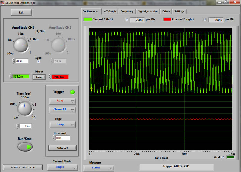

          • that screenshot is not my nulled position - or we should quit that for now
            after that I made one more screenshot (moving coils to point where it should be)
            my first capacitor in RX is 15nF
            I can desolder him and check capacity with LRC meter and confirm with regular multimeter and then ... replace with lower capacity
            I have 1nF and 10nF in that range
              that screenshot is not my nulled position...
              It doesn't matter, the phase shift is largely independent of everything else. Only resonance offset and loading can shift the phase.

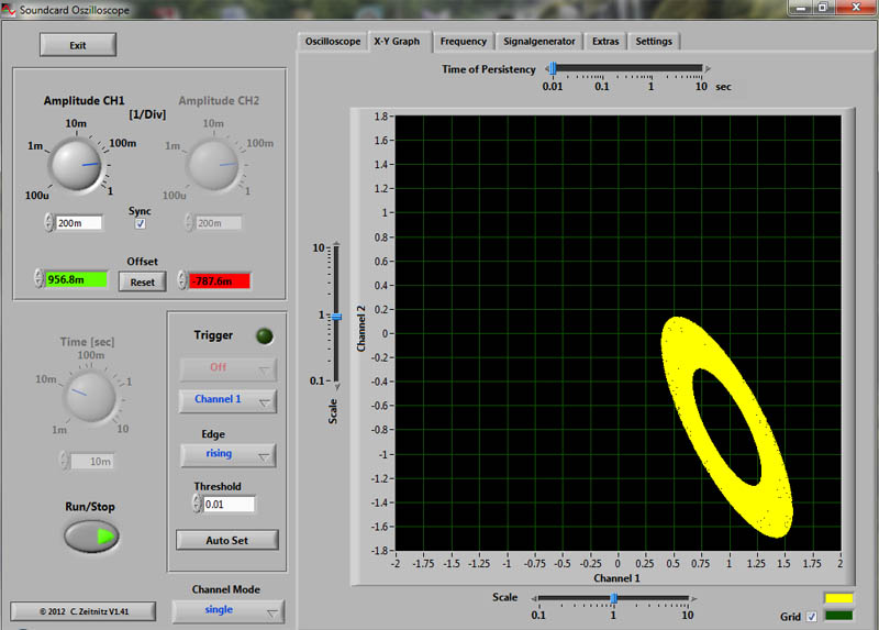

              • 15nF changed with 10nF ceramic
                X-Y graphClick image for larger version
                don't see any change - maybe it shifted little bit to positive section

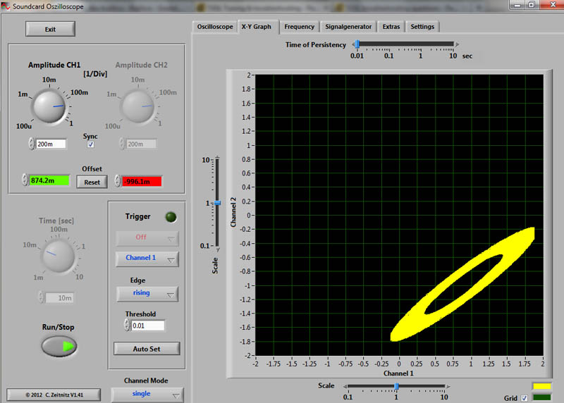

                • Changed capacitor 10nF to 1nF and still I have same problems with coils at "nulling position"
                  detector goes beep beep beep ...
                  I tried moving coils and I can inverse or level this graph as I want ...
                  as I move them to nulling position RX falls off

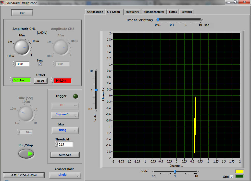

Name:	tx - rx7.jpg
Name:	x-y distance.jpg
                  • Increased phase shift with reduced capacitance is confusing.
                    Can you achieve under 100mV at pin 7 in balance?
                    • started 4.5V AC and got to 40mV AC
                      barely made it... it was harder to find this spot with this capacitor value in place (1nF)
