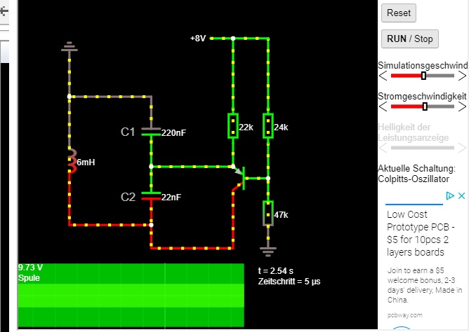

                    I played with an online colpitts oscillator and i saw that the voltage there is 9.78V V not -16Volts.

                    Whats wrong?

                      • AH HA! There is your problem. You do not have -5Volts. look at tr7, tr8 , d6 and d7. That's your problem right there. Now as for TX voltage, it's supposed to be around 16 volt PEAK TO PEAK. Not -16 volts! I am going to measure voltage on my tgsl coil with cheapo meter and see what I get.

                          • I had about 11-12Volts before when it still worked. My Multimeter is a Mastech , cheap and good.
                            The oscillator simulator said the same. But i dont have this voltage now.
