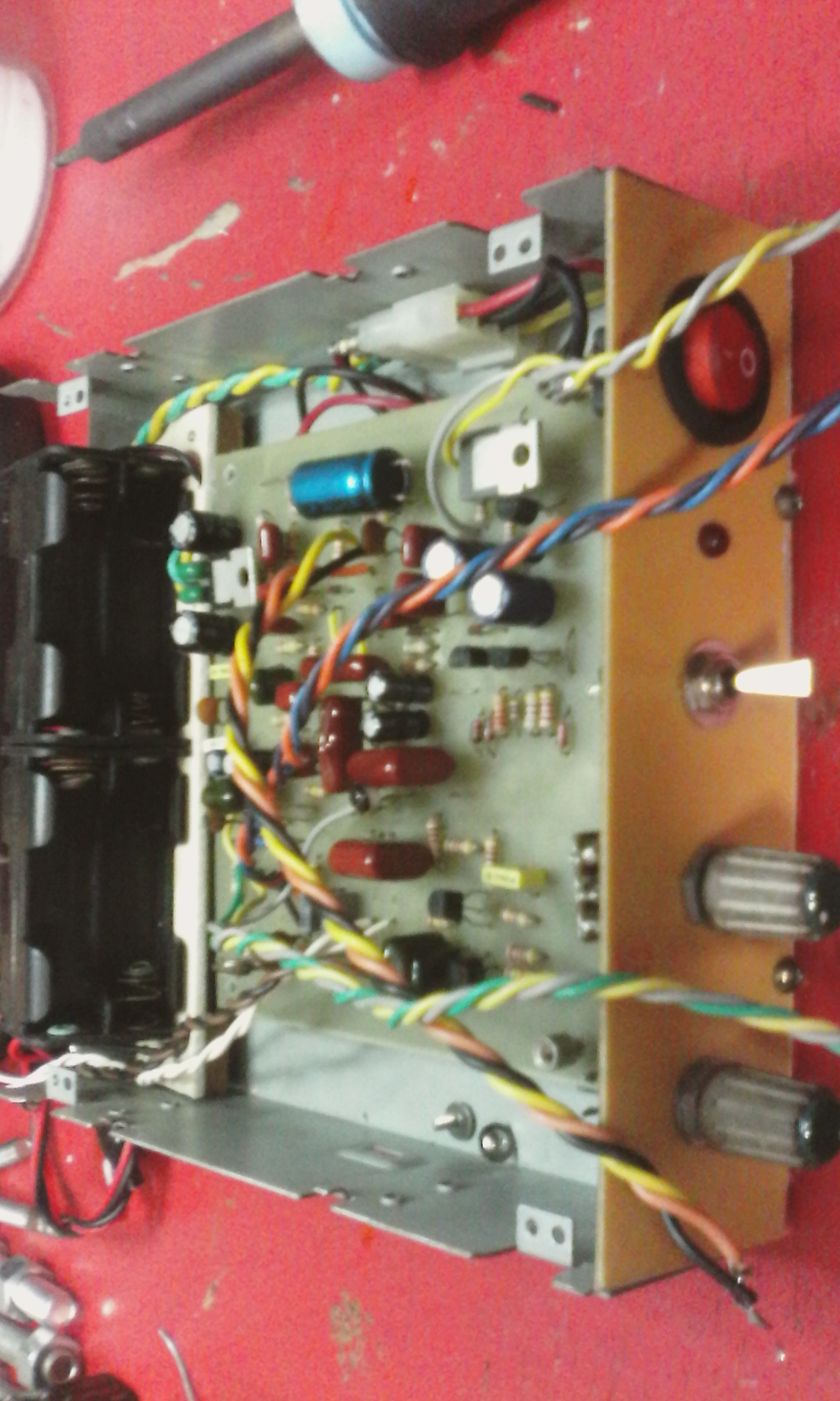

  • This was my first TGSL build, notice chips are soldered on foil side. This was error forgetting to mirror layout before printing.
    • LOL, And here I was thinking I was the only one who's done that.

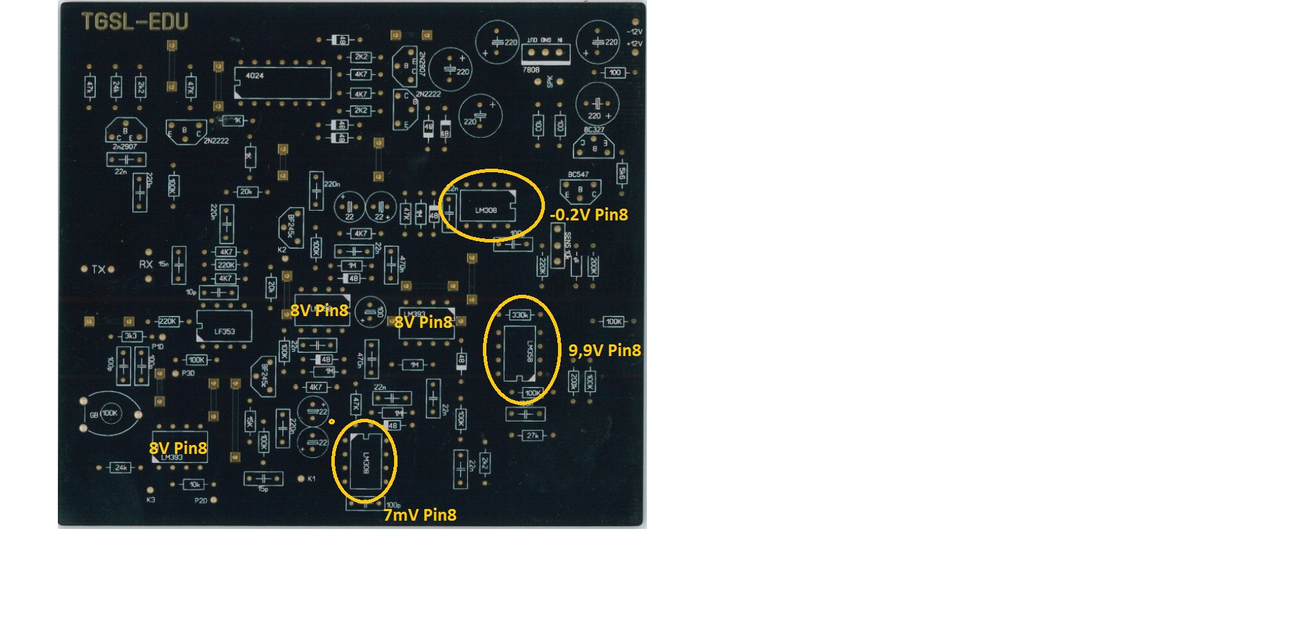

        • I desoldered and tested the 2n2907 and the two poly caps. everything is working. I have 14,21 khZ but only 0,003V instead of 16 Volts. What can be wrong?.
          • What are you using to measure the voltage?
            • Plese dont tell me that i need to buy a oscilloscope. I measured with Multimeter.
Name:	Pin8 Voltages.jpg
              • Originally posted by BKY1337 View Post
                [ATTACH]42013[/ATTACH]
                Pin 8 of the LM308 op-amps is a COMP pin. This problibly tells you nothing.
                Pin 8 of the LM393 & LM358 op-amps is V+. DMV measurement tells you there is power.
                Did you Google search and LOOK at the Data sheets for these op-amps????
                For any input/output of the analog signals and even the digital switching/clocking an O'scope really is a requirement.

                  • I already used this dmm to measure the tx voltage and it worked. I replaced the 358 with a TL082 and it didnt change anything. I removed the 4024 and the detector became quiet.
                    I just cant understand why i only have 4mV where i need to have -16Volts. Every part in the colpitts oscillator is working.
                    I have 8volts supply and i have 5,6V at the base of the transistor , the transistor is working. What voltage do i need to have between the parts?
                    I have a null voltage of 4 Volts at pin 7, this is maybe because i have connected the coil wrong. Its only a test coil.
                    I measured the pin 8 voltage of this op - amps because hyena asked in an older post for this.

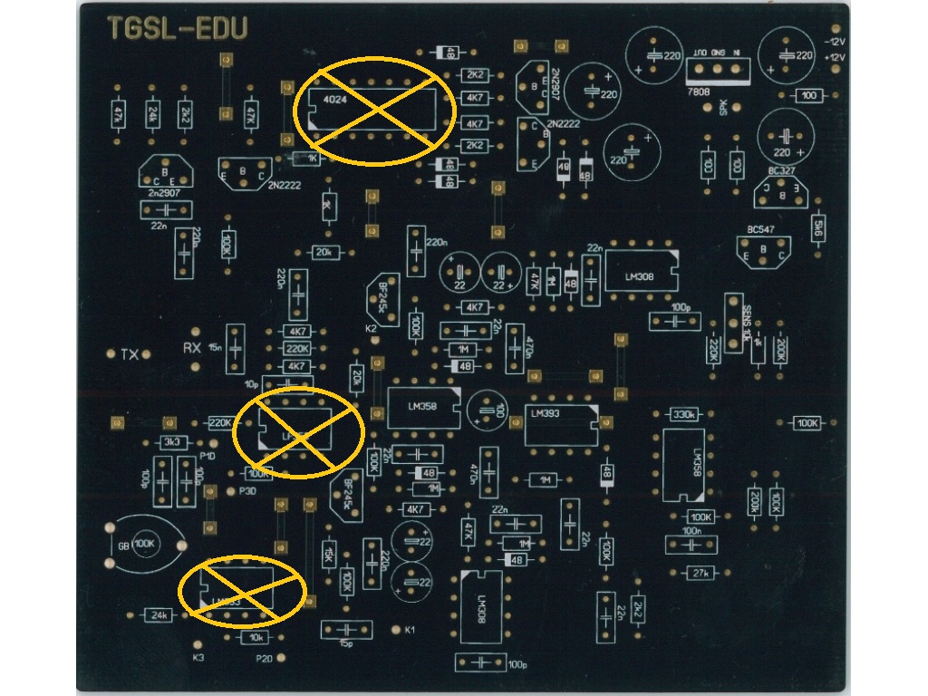

                        • Well, yes the oscillator should run independently with only coil connected. Remove U101 and U102 from circuit, oh I forgot yours is surface mount. Disconnect one end of C9 and C10 to isolate U101 and U102. This will completely isolate the oscillator. Also check TR6. remove CD4024 also. Then check oscillator again.
                          • I have bought a DSO150 right now. I hope i can use it to find the problem.
                            • My TGSL is not surface mount. It is the Kit from Silverdog.
                              I will try what you said.
                              Do you mean this ICs ?:
                              • Also you measured 0.2 volts on pin 8 of LM308. PIN 7 of LM308 is rail voltage(+8V) not pin 8.
