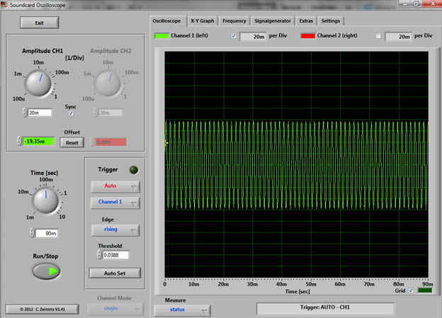

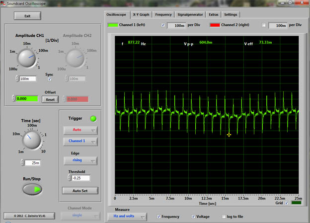

      • here is screenshot of pin6 of 4024

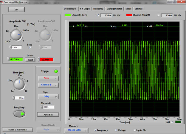

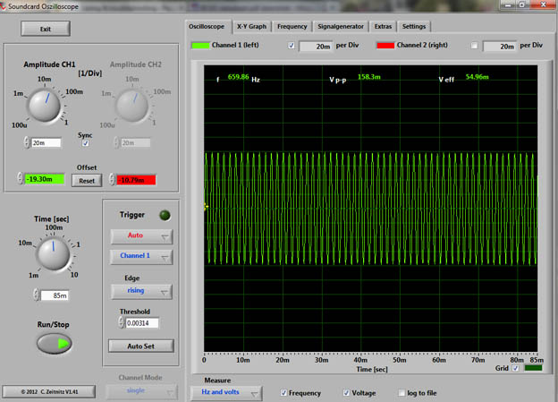

        • Ground balance part - pin 7 LM393
Name:	GB 393 pin7.jpg
          • Gate of lower
Name:	gate lower.jpg
            and upper BF245
Name:	gate of upper BF245.jpg

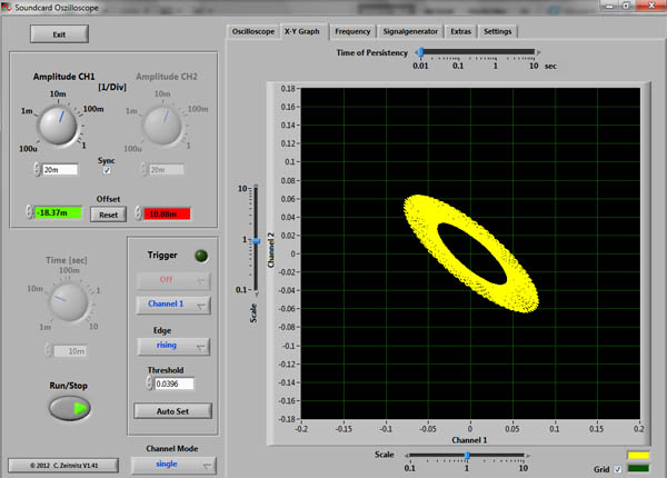

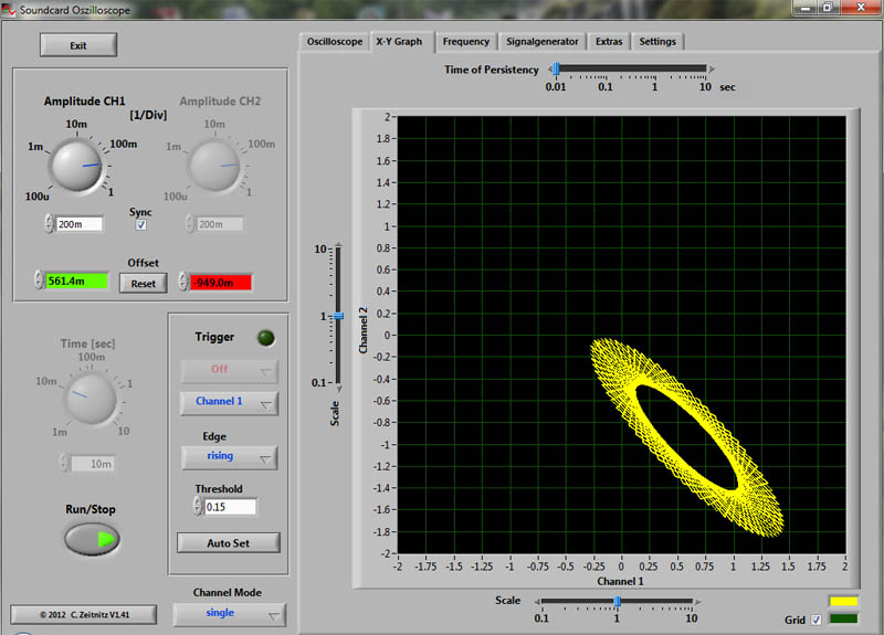

            • As for GB you can use the x-y graph and connect either Tx or Rx pin 7 to the second channel to observe effect of phase adjustment.
                Guess you already see the point - use the smooth signal representation. Digital sampling oscilloscopes go to great lengths to make the sampled signal bearable to watch. For an amateur a good old cathode ray oscilloscope is a premium.
                ....and very cheap secondhand on ebay......especially if one channel is enough and a two channel scope is missing one channel (as can be the case!), you can pick them up for "Peanuts"...

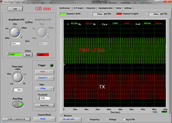

                • xy graph
                  tx and pin 7 GB
Name:	xy tx gb.jpg

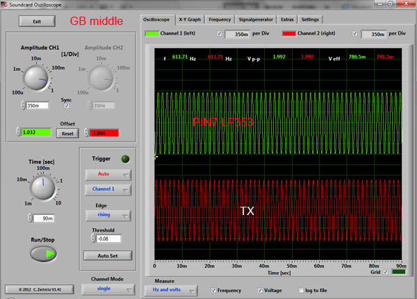

                  two channels - tx and pin 7 393
Name:	classic tx and gb.jpg

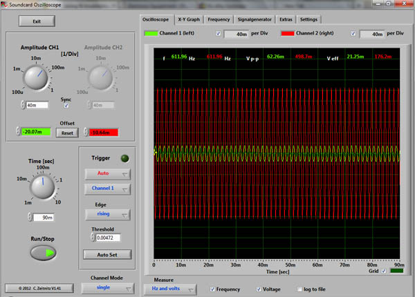

                    • New setting on pots in souncard probe scope
Name:	xy tx gb.jpg

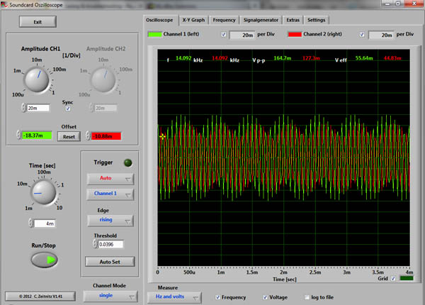

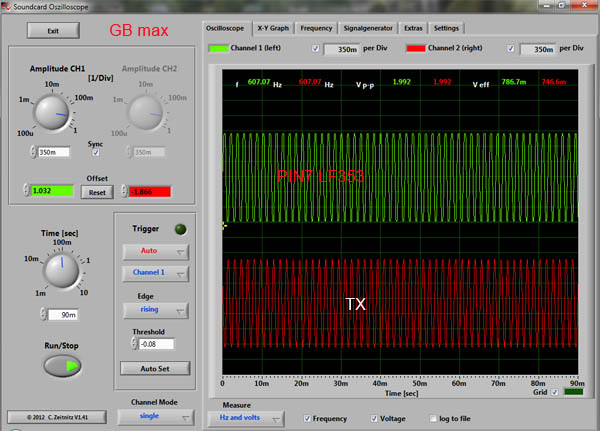

                          • Done one more graph with tx and pin7 on two channels with three variations of GB
                            nex I'll try something which is not sine... gate of TR4... with max and min GB
                            • GB will only change phase so I suggested you to try x-y plot where it is visible.
                              Try to replicate situation where you have the delay after turn-on, and seek a waveform that turns on with it. Once you find it yoi'll know what causes the delay.

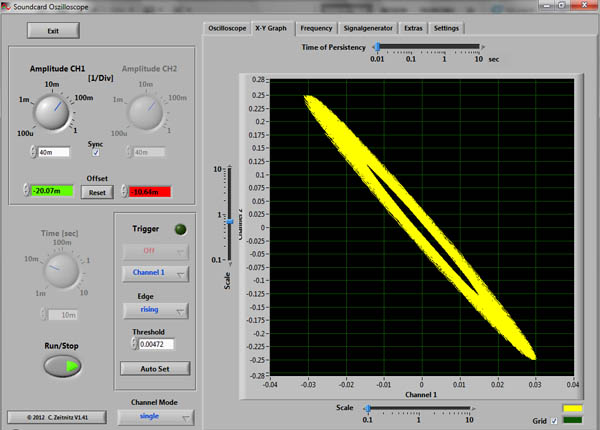

                              • Used TX and pin7 on X-Y graph
                                made it pretty adjusted phase so few lines are drawn ... I think
                                as I don't know what I am doing
                                GB on max (down)
                                K1 and K2 connected
