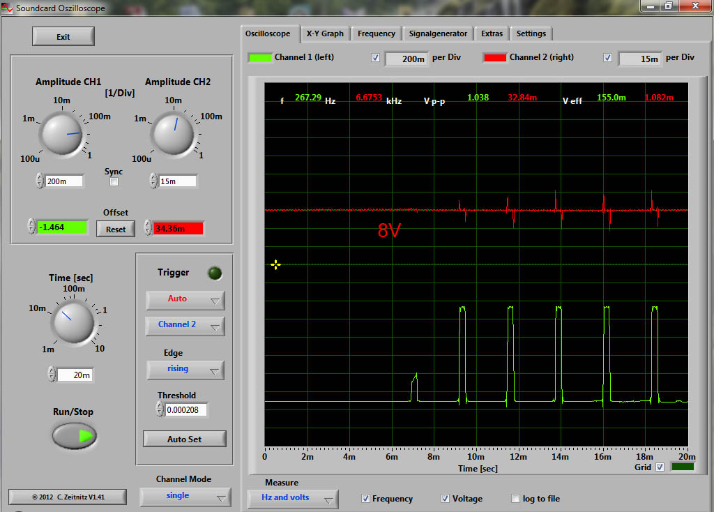

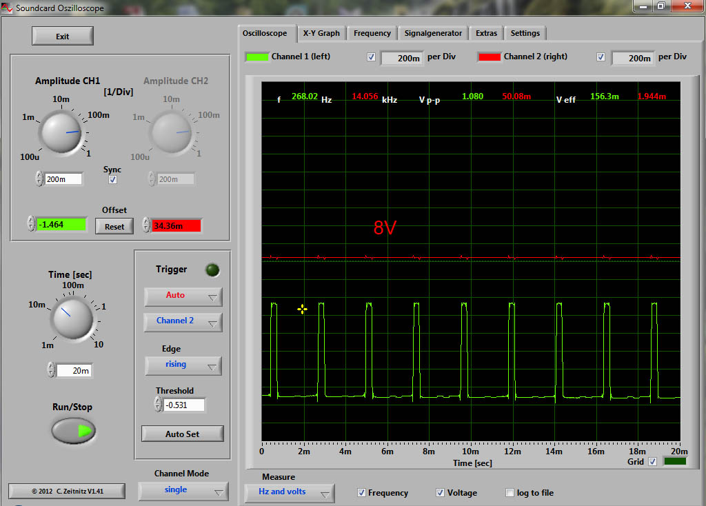

                              • Graph for 8V and speaker out signal with beeps going on "nulling position" of coils
                                8V has some fluctuations but I think it is there without scope connected - goes through GND and 22k + 22k resistor from other channel
                                it can be magnified
