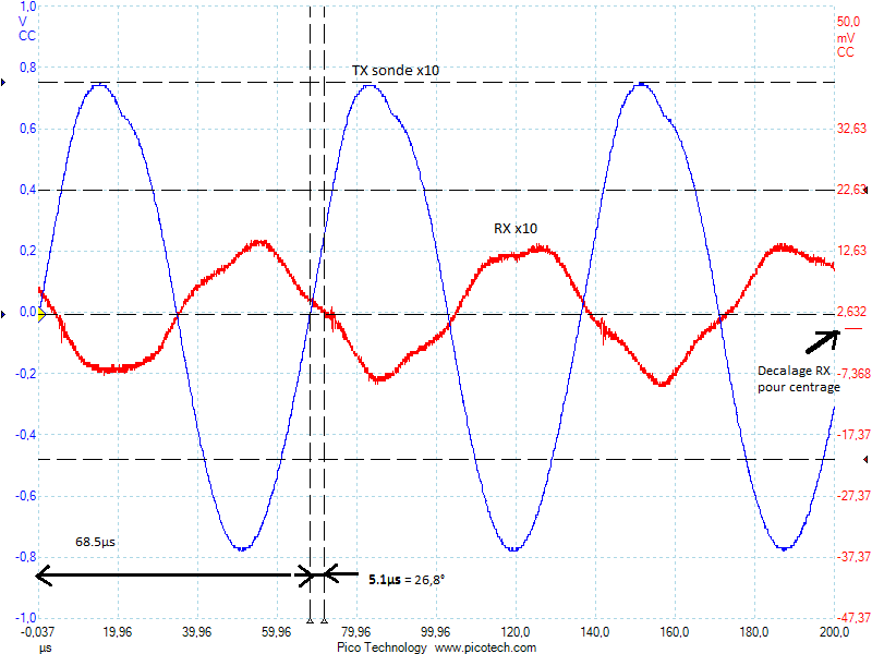

          • Hello,
            I would like to make a récapilatif my tests smd TGSL.
            My coils are made with 0.28mm and I precisely these values​​:
            6.5mh and 6mH
            The capacitor is 21.8nf TX and RX 16NF. I have a frequency 14.61khz
            I had not yet oscilloscope and I am the nulling coils in AC voltmeter, I have the best result 450mv AC pin 7 of U101
            I get the 32 cm and 1 euro 5centime
            Potentiometer in the middle of the GB and I eliminate a ferrite toroid. (I do not have a cylinder)
            With these results, the steel is discirminé with the potentiometer to the minimum. So I do not have control of the metal with the discirmination but aluminum rings and can be discirminer.
            Today I had a two oscilloscope traces and I checked the phase in this configuration and I get + - 60 ° phase shift. (RX behind Tx)
            So I tried to set at 20 ° and I get better at 28 ° which gives me 34mV AC on pin 7 of U101.
            With this setting, the steel is discriminated with the potentiometer discir +-in the middle .. I think the result is better. I keep + - 30cm 1 euro and 5cent.
            Here is a picture + - 28 °
            a beginner question: The RX voltage is not symetric (-75 +130mv)
            Do I have décallé track of RX to TX or focus on is what I have to align the 0V lines?
            Also I noticed that I did not -5volts but -6.2volts?
            I ask these questions because I'd like your advice before filling the coils.
            For the moment these tests are done with the coils off lid but I think I can improve
            the nulling with fit snugly in the receptacle coils.
            Thank you for your advice
            • Voltages are fine as they are. TGSL is a motion compensated detector, and as such it discards all offsets of static nature.
              Try improving the Tx signal, as apparently there is something causing impurities.

                  • Hello,
                    Information for the image of my previous message is a complete measurement error.
                    I remade test the result:
                    I have very difficult or impossible to achieve 20 ° phase shift while maintaining the correct amplitude RX
                    When I am approaching this value, the performance drop.
                    I get very good results with ± 450mv AC on pin 7 of U101 but the phase shift is 60 °. GEB pot in the middle and functional discrimination.
                    With these settings the voltmeter and ferrite I 5cent euro 32 cm 34cm ditto 1 euro and 1napoléon to 35cm
                    I tested with different capacitor RX and TX but the variation is too low.
                    The lateral displacement of TX and RX low there is the amplitude varies.
                    My coils are of 0.28mm 6.5mh specifically for RX and TX for 6mH.
                    Will you tell me why I do not reaches the 20 ° phase shift?

                        • Your MD appears to work quite well. Does it matter what the phase shift on pin 7 is? Are you talking about the phase of the null signal?
                          No one has satisfied me that the actual phase shift of the null signal is very important to depth or discrimination by itself. However, it may have some importance regarding immunity to certain noise sources, such as amplitude modulation of the TX signal. It may also be a sign that you did not build your PCB or coil quite right.
                          But for basic MD operation, you can get a good MD with many different null phases, and your performance is not bad at all.
                          My tests have indicated that null phase can be very influenced by the cable you use to connect the coil to the PCB, and also the type of shield you use. If the gap in your shield is shorted or low resistance, it could cause a big phase shift, and you would want to correct that. Any metal near your coil or mounted on your coil could influence the null phase (without necessarily causing much harm).
                          If your TX frequency is too near the RX circuit resonant frequency, you can get an exaggerated phase shift -- but usually your discrimination and ground balance would be off-center and perhaps appear not to work. This problem is usually fixed by adjusting the capacitor in parallel with the RX coil to a lower value. If lowering the capacitor value does not change the null phase much, it probably was not wrong to start with.
                          It would be best to post actual photos showing the TX signal vs the RX signal at pin 7 as a dual trace, showing 2 or three cycles on the screen to show the phase relationship. Sometimes people have different ways of referring to the phase measurements.
                          Also, whenever measuring depth, the EMI noise around you affects the depth very much. Sometimes people think their TGSL is bad, but it is not. If you take the MD far away from noise (in the hills for example) and measure the depth there, it may be much better. That is my situation in fact. I often measure about 16 cm depth in my workshop, and 34 cm when miles away from my town in the hills. Such EMI should not affect the discrimination and ground balance much I think if you test close enough to your coil, so you can still test those functions in your workshop.
                          It is very useful to build many coils and compare them, because there can be surprising differences. Also try different cables.
