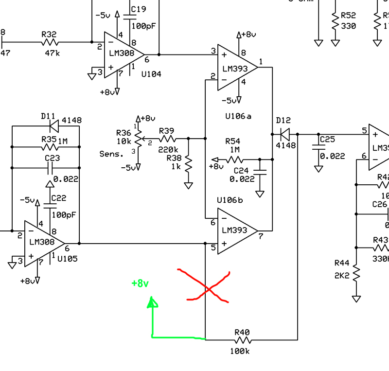

    I have a problem on my TGSL I hope to find Solution with Your advice.
    I can Get coin in air 30cm and Rejection of iron . the problem when move the coin near to coil I get high sound when move coin in 20cm or 30cm Sound becomes very very weak.
    What I do to get loud voice in 10cm or 20 or 30cm
    Note: I dont have problem in my PCB

      You could try increasing the values of C17 and C14 (4.7 uF) to up to 20uF. Or change capacitor C18, C21 from .47uF to 2uF. You may not like the response though.
      Another problem is noise -- any noise in your workshop can make the target beep shorter and sound fainter. Test again far away from noise.
      Also look for Ivconic's experiments with audio circuit.
      -SB

                        My previous suggestion (with bigger capacitors) was to make the beep longer, in case your problem is too short a beep with weak targets.
                        However, if your real problem is simply loudness, then you can try this:
                        Disconnect the 100k resistor R40 from U105 pin 6 (output of LM308 GB channel) and connect it to V+ voltage.
                        This should help give you same volume sound for all beeps (except very short ones). But it may be too loud, so you may need to use a voltage divider to get smaller voltage than V+.
                        P.S. I haven't tried this so you would need to experiment.
                        -SB

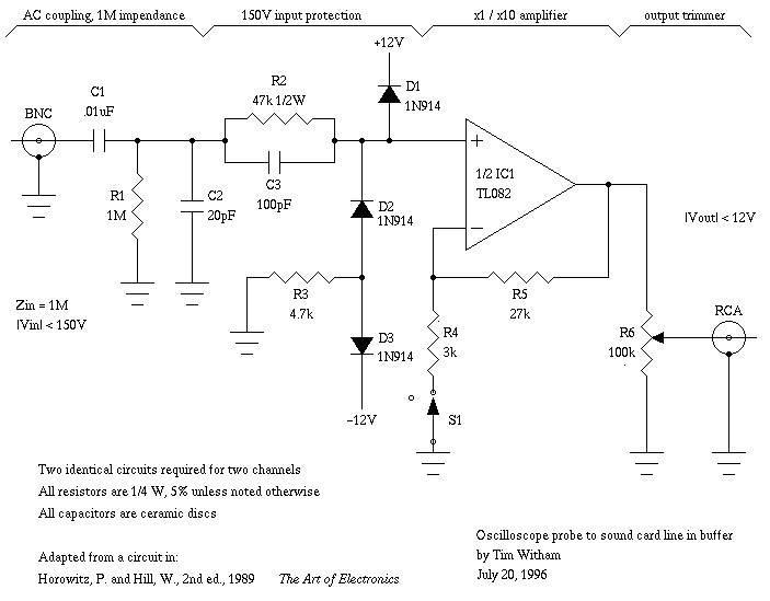

                            Maybe Dennis the Mennis can also talk you (johnsmith77) into getting a PC PicoScope which he has used very successfully. I'd like to get one myself.
                            -SB
                              -SB
                              Very good suggestion! I already have a good scope so it is more difficult to justify yet another toy, but it does offer some advantages over a conventional scope.
                              I downloaded a PC sound card oscilloscope this afternoon just to see if it was usefull for TGSL frequencies. From what I have seen so far I have to say no. But I was using the internal signal generator for a source and not a properly terminated input. 60 hz noise was a problem along with the sample rate. If the hum is eliminated then just maybe it will work somewhat.
                              This is the one I tried: http://www.zeitnitz.de/Christian/scope_en
                              I am going to make up a proper input cable for it and give it one more test before passing final judgement.
                              Jerry

                                Hi Jerry ,
                                perhaps this is of any use ( though there must be another million examples) ....
                                http://www.pi4raz.nl/index.php?optio...=223&Itemid=46
                                kind regards ,
