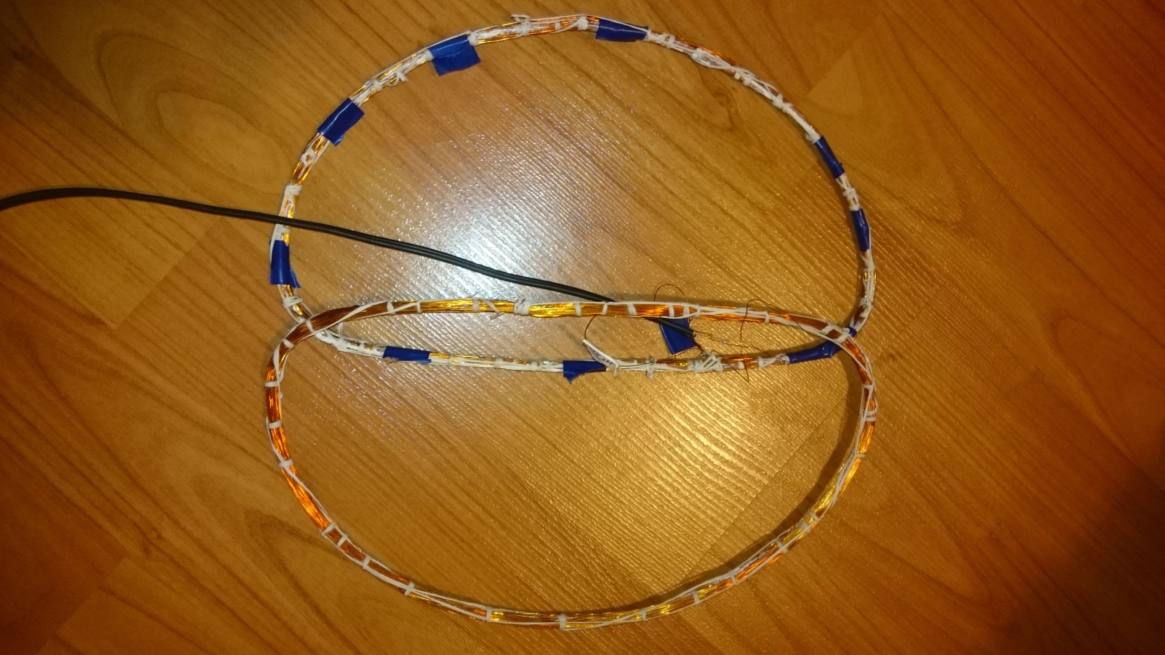

                    • I've connected my new unshielded coils to the circuit. The results are the same. TX frequency 14,07 kHz, RX 13,83 kHz. The RX resonant circuit not working somehow. The LF353 has +8V on pin8 and -6,3V on pin4, and now 800mV on pin7. Strange.

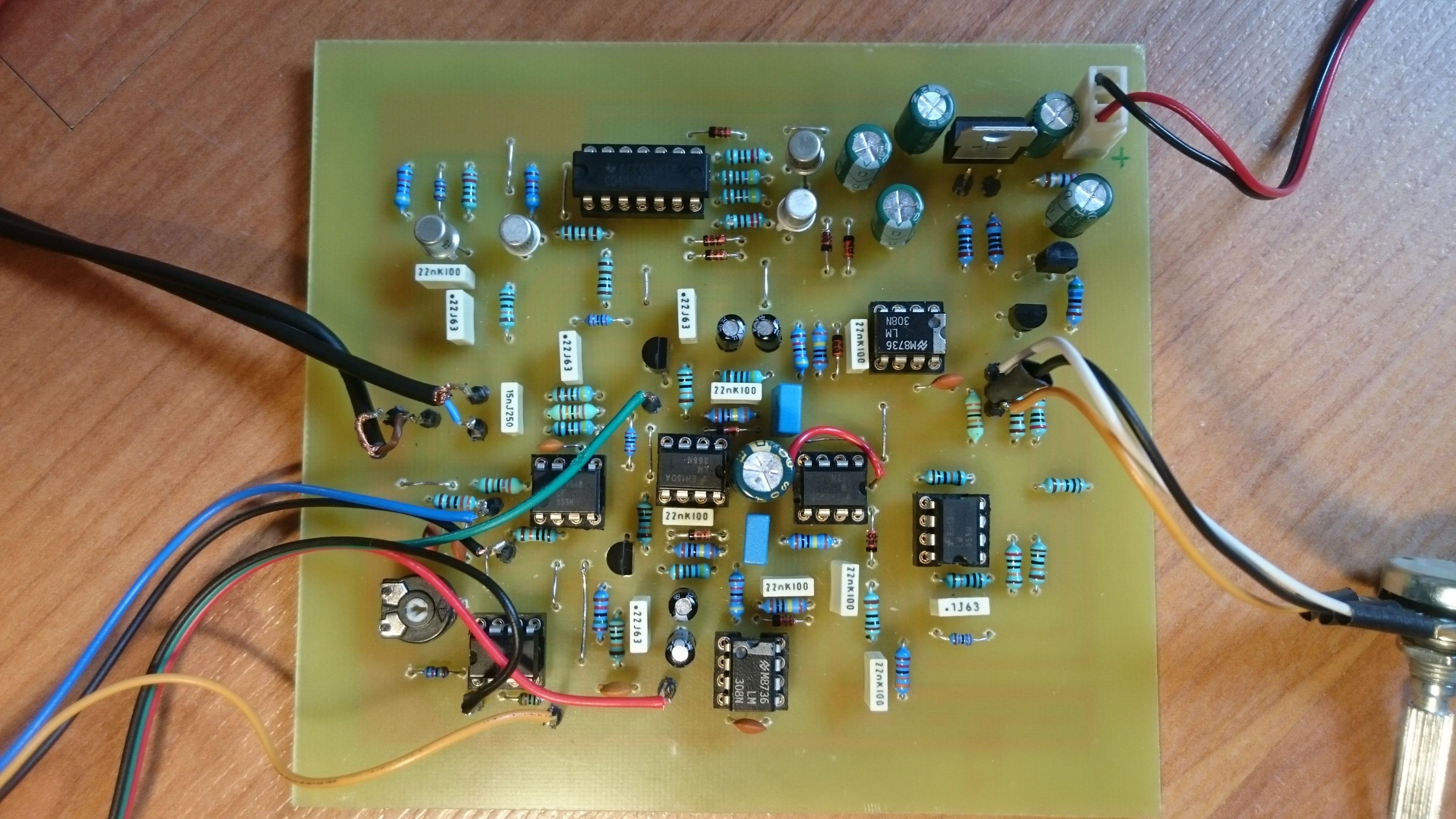

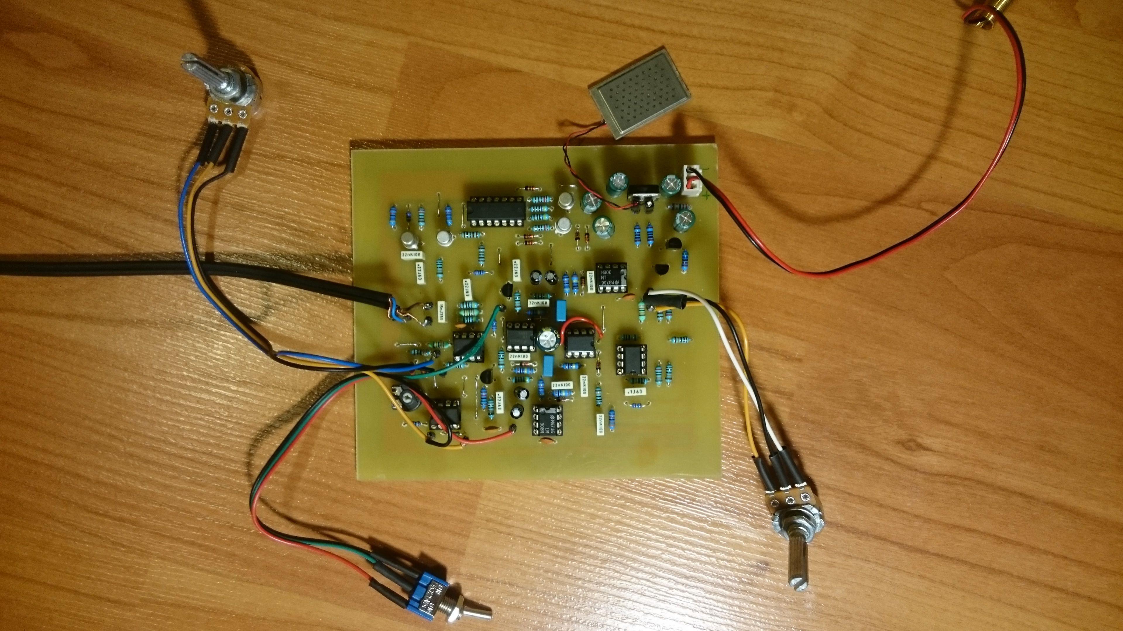

                          I made pictures.

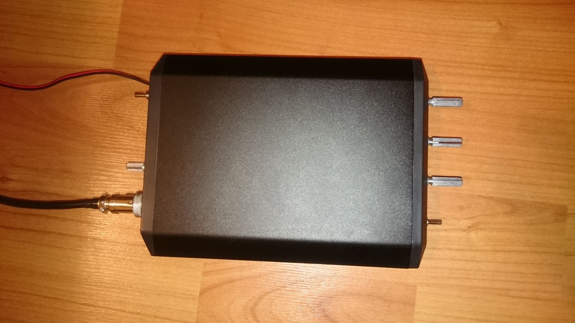

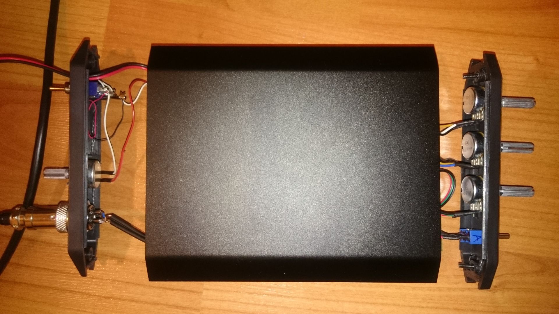

                          • I made little steps forward. I measured my TX frequency, it was 13,86 kHz. Frankly, I don't know how can this value 14,5 kHz in the TGSL doc. The resonant circuit with 22 nF capacitor and 6 mH coil must be 13,85 kHz. Whatever. The difference between the TX and RX frequency in document is 16,12-14,5=1,62 kHz. My RX frequency must be 13,86+1,62=15,48 kHz. My new RX coil is 6,6 mH, so I need 16,02 nF capacitor. I soldered 1 nF capacitor paralell with the already built-in 15 nF.
                            The new coils are not fixed, I can change their coupling. I trying to learn, how can I nulling them.
                            But ferrite rejection and discrimintion not working well. Sensing distance is very bad. Sad. Many people built this detector without an oscilloscope...
                            Good news is, I made a box from an external HDD enclosure. It looks promising from the outside, but really messy from the inside. I have a volume control and an earphone/speaker switch.
