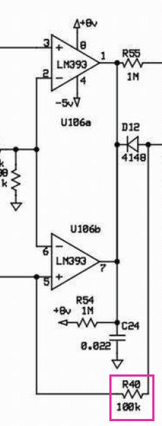

              Can you also check the outputs of the comparators to see if they are oscillating?
              As you can see from the TGSL circuit, the comparators are not using hysteresis to tame any instability (motor-boating) when the input hovers near the reference voltage.
                For these noise tests I used min-sensitivity and so the comparators were not motorboating -- however, they were being triggered by the noise. But the speaker does not sound because the pulses are too short to get through the next low pass filter.
                My PCB, on my noisy workbench, does not fully motorboat with the RX coil active because the noise effectively breaks up the motorboating. If I short out the RX coil, then I can get a pretty clear motorboating at the max sensitivity.
                I can't explain why, but in my field tests, I was able to get motorboating below the max sensitivity, which turned into steady tone at max sens. It's as if when I'm in the mountains, there is a bias on the comparator inputs. I previously determined it was due to the sunlight on the diodes, but this time I had it covered quite well -- just a small hole where the cable came out. Next time I'll plug that completely.

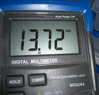

                Oscillator Trimming
                I tried trimming the oscillator frequency to see the effect. Nominal frequency is 13.82 kHz.
                At 13.55 kHz I get a strong tendency to motorboat, more than at 13.82 kHz, but I'm not sure it's from feedback, or rather the noise signal -- or maybe a confluence of both. The noise signal looks like a lower frequency sine wave.
                At 13.32 kHz, the circuit will not motorboat at any sensitivity setting. The noise chatter seems suppressed.
                At 13.10 kHz, the circuit seems less noise, I can turn the sensitivity up much higher without chatter. Detection of a Euro seems cleaner and clearer also.
                However, I didn't retrim the RX coil for each oscillator setting, so probably the gain was just dropping. To test that, I added 1 nF and retested and indeed noise signal was higher (probably due to higher gain). So not sure that proved much, although strong motorboating at 13.55 kHz seemed to indicate some interaction of noise spectrum with oscillator frequency.
                -SB
                  Qiaozhi, wouldn't this 100k resistor be hysteresis feedback? It's only applied to the GEB channel but since this is a wired-And configuration it should apply to both channels. (?)
                  Simon, maybe you have a different configuration there, or an open resistor or diode?
                      I suspect that it's intended purpose, but it will not provide any hysteresis.
                      For a comparator used in the non-inverting configuration, the hysteresis voltage can be calculated with the following equation.
                      HYST = R1 * (VOH - VOL) / R2
                      where R2 is the positive feedback resistor.
                      In that case the hysteresis works out as zero volts, because R1 equals zero ohms.
                      Even if the PCB track connecting U105 pin6 to U106b pin 5 had a resistance of 0.1 ohms, this would only provide a hysteresis of 10uV, which would be completely lost in the noise.
                      • apples, oranges
                        I have always believed that the 100k resistor is a "feedforward" path whose purpose was simply to make the TGSL audio louder for stronger targets. It effectively sets the pull-up voltage of the comparators to the output of the GB LM308, which is then passed through to the audio signal by the next stage. Note also that in the original TGS, the GB LM308 does not have the limiting feedback diode, so it's output range is potentially higher -- this corroborates the purpose of the feedforward resistor to modulate the audio volume. Also as you mentioned, it is only on one side of the "AND" logic and wouldn't be effective, so doesn't make sense for hysteresis.
                        Also, as Qiaozhi points out, the 100k resistor won't make a hysteresis feedback, primarily because the LM308 output is a low impedance "AC ground" that sucks away any feedback signal.
                        I haven't come to a conclusion about motorboating yet or if it is a problem, because generally noise is the limiting factor that keeps me from turning the sensitivity pot to a region where it motorboats. And it is perhaps true that all TGSLs will motorboat if operated at a certain threshold. But no doubt you can build the circuit to have less tendency to motorboat. Hysteresis could help that, but I'm not sure you want it for other reasons. On the other hand, I have often considered adding hysteresis just to lengthen the audio beep. But I think it might make the chatter more disruptive.

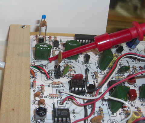

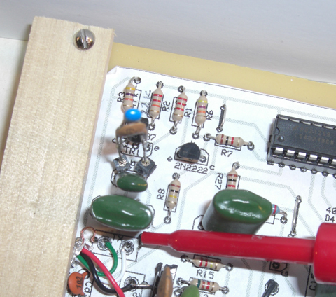

                        My last fooling around, I mean tests, comparing the LM308 output noise between my PCB and dfbowers PCB revealed that the noise "personality" (how it looks on an oscilloscope) is extremely sensitive to the oscillator frequency.
                        I found by changing my oscillator frequency by merely 200 Hz caused the noise to look completely different. It went from about 20 Hz wave to about 2 Hz wave. It may not change the basic noise power, but it really looks different.
                        So to really compare noise between PCBs, I think I need to trim my oscillator to be as close to dfbowers frequency as possible. Otherwise it's just craziness.
                        So I need to rig up a more permanent trimmer for my PCB.
                        I'm also trimming my R6 capacitor in the RX coil "tank" to match closely also.
                        I'm going to look at the null signal also -- it should be similar phase and amplitude -- if not, something to dig into.

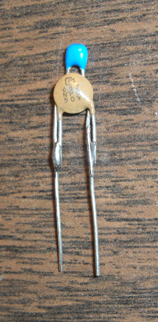

                          • trimming
                            Re-measured dfbowers oscillator freq with his coil = 13.72 kHz.
                            Trimmed mine to 13.72 kHz with kluged capacitor.
                            Meter only accurate to 10 Hz, so still not exact, but will try comparing now.
                            -SB
                              I'll go along with that. I overlooked that there is a formula for hysteresis and that an input resistor is needed. I should glue the formula to my forehead so I won't forget it.
                              I have always believed that the 100k resistor is a "feedforward" path whose purpose was simply to make the TGSL audio louder for stronger targets. It effectively sets the pull-up voltage of the comparators to the output of the GB LM308, which is then passed through to the audio signal by the next stage. Note also that in the original TGS, the GB LM308 does not have the limiting.
                              -SB
                              Feed-forward makes sense. I've read that before. When it's late at night, my wishful thinking can sometimes lead to confabulation having no basis in reality.
                              That also holds true in the daytime, come to think of it.
