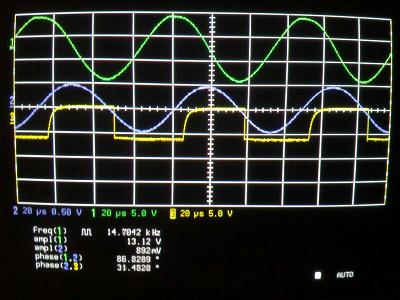

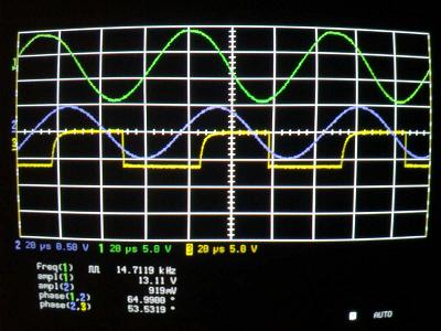

    I took snapshots of my coil nulling parameters before and after pouring the epoxy into the shell.
    As so many others on this forum, I too had problems to achieve minimum null or +20 deg phase shift in the same coil positions. I made a compromise between them and ended up in a situation as in the first picture. The curves a as follows:
    1 (green) TX; pin 1 of J1
    2 (blue) RX; pin 7 of LF353 (U101b)
    3 (red) GB, gate of TR5
    I thought, that the GB signal could sample at proper part of the negative going RX signal though it is not exactly at the middle. After epoxy had cured, the GB signal was barely up at the negative going slope of the RX signal (2nd picture).
    How does the real ground effect the relationship between RX and GB; does it “drop the RX out of the GB signal” or does it lower the phase shift?

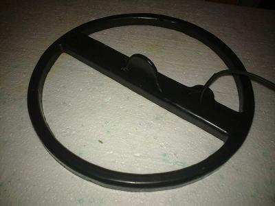

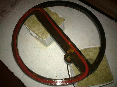

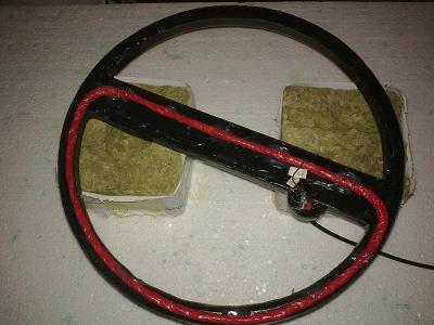

    Everyone likes pictures, so here’s some of my latest version of coil set.
    Can someone please tell me how the sow the pictures between paragraphs; not all as one heap at the end of a message?
      Before epoxy, you had phase shift ~ +60. I have ~ -60.
      1) Do you wind coils in same direction or different?
      Made some test with ferrite on Tx. It makes oscillator work on lower frequency because ferrite rises inductivity on Tx coil.
      We always want achieve shift 20. Does it should be measured directly between tx vs rx or tx and lf353 pin 7 - thats the question
      LF353 (Tl082) should influence shift also. Also TL082 or LF353 should change phase differently. They are not identic 100%
      The most important thing is (by my opinion) phase shift between tr4, tr5, (drain and gate). It works like mixer
      From where comes theory 20, none can say? I think than man which made successful project had phase shift 20 Tx, Rx. But what phase shift was tr4, tr5 (drain vs gate).
      There comes Tx vs Rx signals. But they have not original Tx, Rx phase shift they are influenced by all circuits they passed. These circuit are indentical only ir schematics. In real conditions not, because components acurracy. R, C +- even 20%? So phase shift +-20%? with identicals circuits? There is the reason why each desing works differently?
      I think you can compensate GEB shift by trim easily if you had shift like in the first picture, not sure about second one.. Did you measured on middle GEB trim position? This also influence TR gate GEB shift
      Your phase shifts:
      1pic) Tx/rx = 64 ______ +22 _________ = ____ 2pic) Tx/rx = 86 ____________________(When you applied epoxy Difference= 22)
      1pic) Rx/geb = 53 ______ -22__________= ____ 2pic) Rx/geb = 31 ___________________(When you applied epoxy Difference= 22)
      So if you had Tx/rx = 20 (64-44)
      Rx/geb would be = 97 (53+44)
      So when Tx/rx shift would be 20, rx/geb shift 97.
      97 is not the middle. Middle is 90. So there is no chance achieve 20 tx/rx and rx/geb = 90 at the same time. Then question which of these shifts is more important?

        I think the 20 deg should be measured between TX and pin 7 / LF353. That's where the sampling (by the FETs) happens.
        I feel, that the 20 degrees comes from the fact, that the GB adjustment circuit (U102b, C10 and R22) makes the sample to delay that 20 degrees. We would need Simonbaker to comment it, as he has (to my understanding) simulated most of the machine, piece by piece.
        I tried my machine ouside, far away form anything electric. The detection distance was exactly the same as indoors.
        Next I will make another coil set and measure it's resonance when attached to the detector. I have an audio analyzer with which I can feed random noise to the TX coil and monitor the output of RX coil at the same time. The max hold function of the analyzer should reveal the resonance.
        I will set the resonances "by the book i.e. 14.5/16.1 kHz" and null the coils to absolute minimum. What then, I don't know yet.
        The phase measurement between the RX and GB singal is there just for fun, I did not use it for anything.
