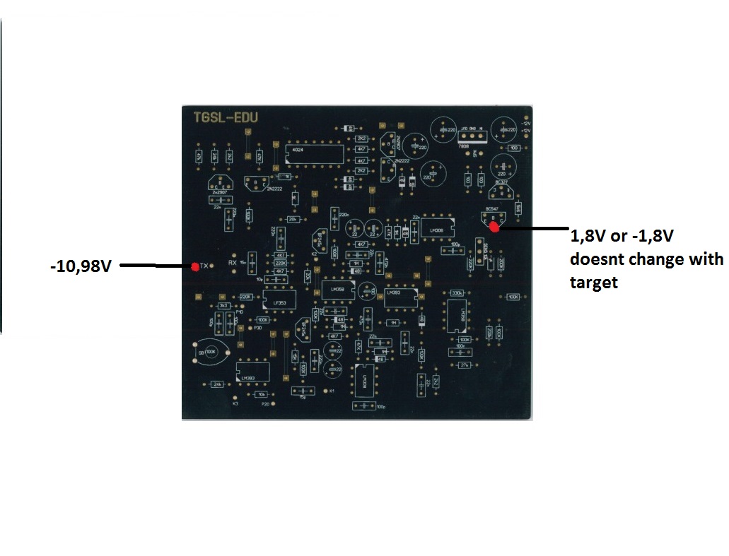

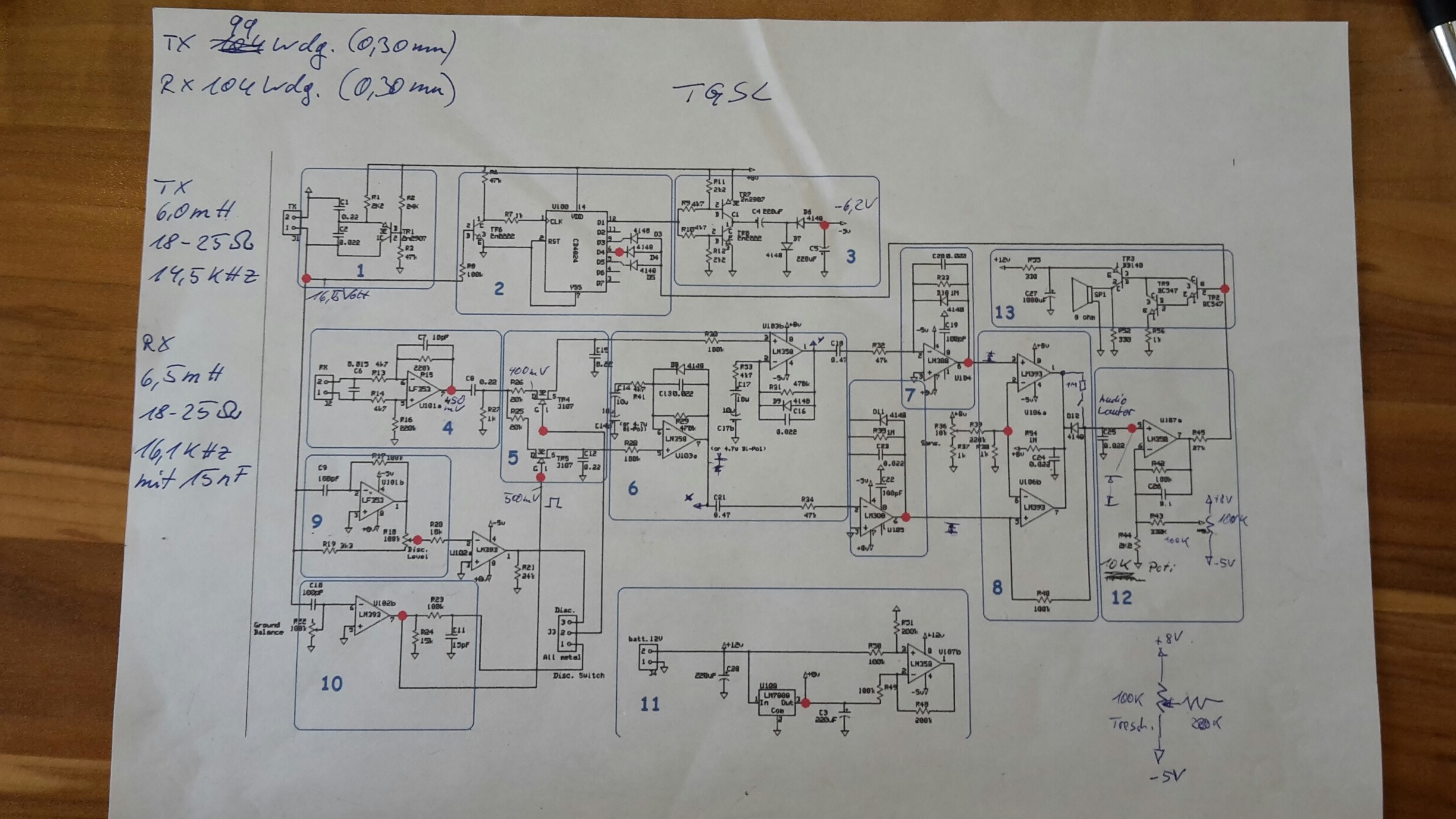

                    • Hello, i have a problem with my TGSL . I think my internal speaker detached and caused a short curcuit.
                      The Coils are not coiling and the speaker doesnt make a sound.
                      Should i check the Pin 4 Voltages from my Op amps? Can i do this without coil?
                      Edit: I got 0.605 V at Pin 4 from every 8 Pin IC without coil.
                      • It's the same with coil. I think the coil is ok. Measured the resistance of the coils: 25 Ohm and 26 ohm.
                        Pin 7 Voltage (Null Voltage) is 0,77V -> Does this mean that the coils are coiling?
                        I got constant 2,5V or -2,5V at the speaker with speaker attached.
                        1,8V at the BC547 Base. (Control Point 13-Audio) , doesn't change with target, always 1,8V.
                        • Im afraid u must disamble the pcb and trace dead part or unconnected track, or find all voltage reading by each components to find the error. Or ur speaker just dead
                          • My Tracks are all connected , it's the PCB from silverdog. It worked before.
                            Can someone show me the test points from the PDF at the PCB?
                            • Try this blobber test point
                              • Thank you , i already know the testpoints but i have problems to find them at my PCB.
                                Can you mark it red at this picture? Or someone else?
