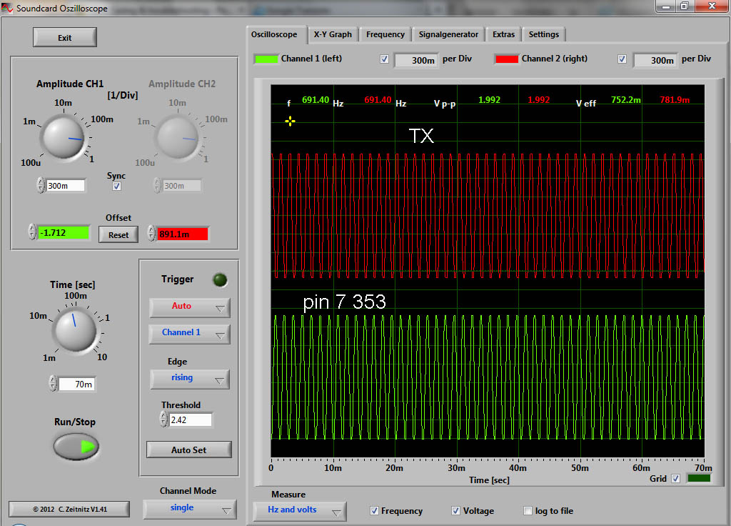

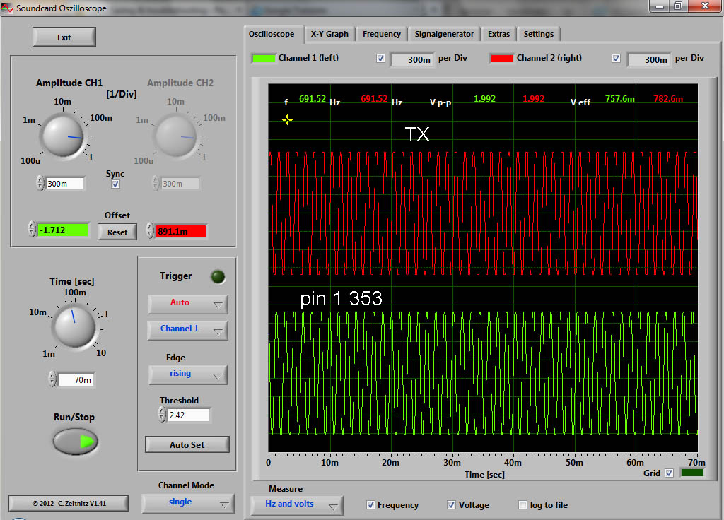

  • >Are you measuring the TX or RX signal as reference (your scope screen says RX)?
    >Most useful to start with is measurements vs the TX signal.
    that is TX graph sorry ... it was early in the morning typo in photoshop...

      • captured few more

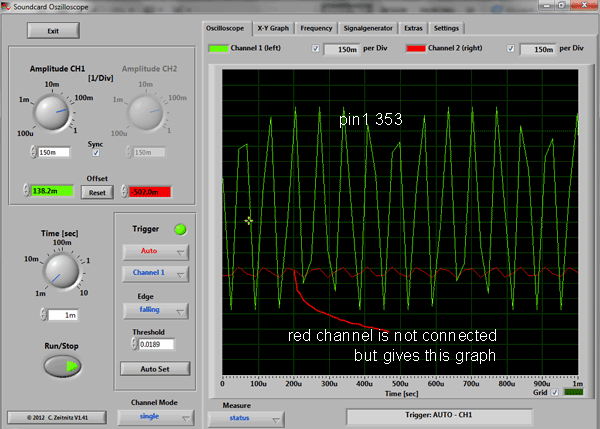

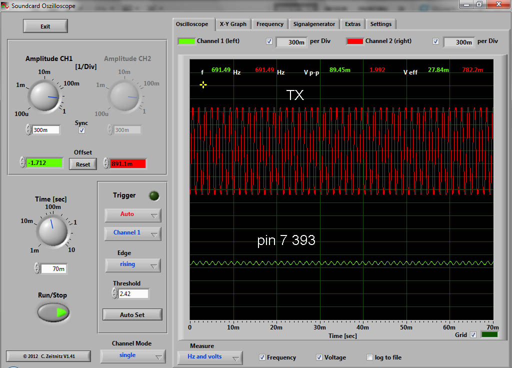

        TX and pin 7 393 close to GB (I am thinking that lower one is noise only - even if not connected there is similar signal)

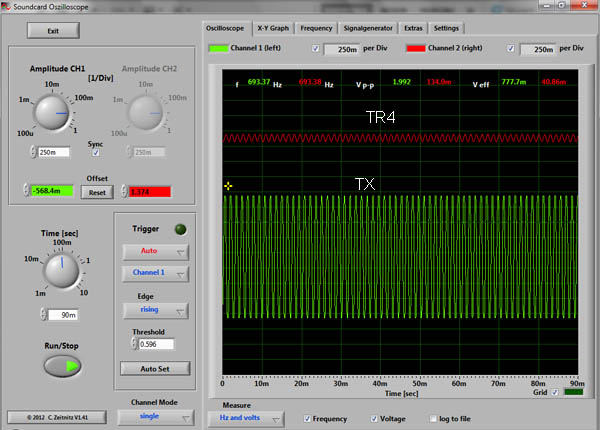

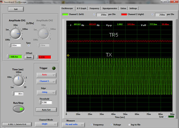

        TX and gate of TR4 and TR5
        all metal mode

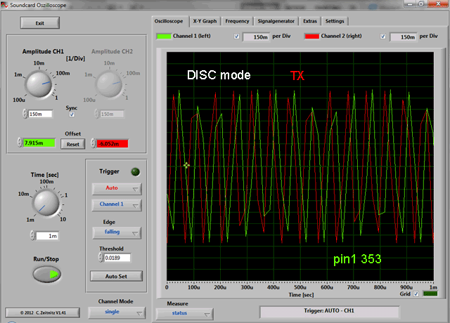

        • Switched to disc. mode
          tx and pin 1 353
          tx and pin 7 353
          tx and pin 7 393

          • small signal GATE TR4 and GATE TR5 is from TX coil
            when it is not connected there is no signal - this scope can't read TR4&5 ?
            GB trimmer on middle

                • LM393 pin 7 while rotating the GB pot
                  I made a mistake by connecting pins 7 and 8 of LM393 and detector stoped working
                  then it responded to ferrite and I was able to noch it with GB trimmer
                  (or just lower sensitivity to all)
                  I shocked it with 8V to pin 7 ... after minute it was beeping again ...

                    • It appears as if you used up all the space for your attachments. You may want to politely ask Carl to do something about it. Those scope shots were all jpg. Unfortunately. For all screenshots you get 10 times smaller files, and in incredibly better quality if you save them as gif.
                      Anyway...
                      There might be a logical explanation after all. Guess you have some decent ohm meter at hand. I want you to switch off your device, and measure resistance between LM393 pin 7 and ground. With device switched off, of course.
                      Edit ... you can find ground at pin 5 of LM393.

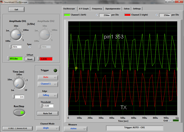

                        Unfortunately we cannot see phase easily because time scale is too long -- can you "zoom in" by using faster sweep or magnifying the time scale?
                        I would like to see details of signal at Gate of TR4, TR5, but I think maybe your scope bandwidth is too small. The signals should be square wave for GB sync pulse (at gate TR5) and DISC sync pulse (at gate TR4). Sometimes the DISC signal has spikes which usually don't cause a problem. ALL METAL (gate of TR4 also) signal usually looks like a triangle wave.
                        Any distortions to these signals, or level problems would be interesting to know. Usually the max value of the sync pulses is approximately 0 V (ground).
                        Anyway, I'm hopeful you can find the problem because it is not sensitive to cables -- something more definite is wrong. Because it was a kit, it would seem you are using all the right parts.
                        What did you use to measure the inductance of your coils?
                        -SB
                        • Davor,
                          resistance is 14,94k ohm

                              Let's try another one... this time it is PNG and smaller
                              This is graph for pin1 LF353 ... without TX and with TX

                              this "scope" is not very accurate in this kind of scale...
                              • is this OK for view ?
                                tx and pin 1 LF353
                                disc. mode now
