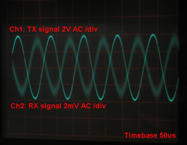

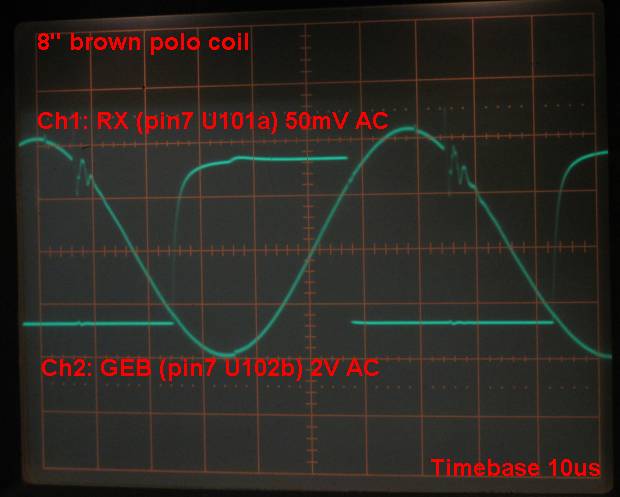

      Well, I've connected its 8" concentric polo coil to my TGSL circuit and these are the signals I got from this coil.
      The coil works, and once geb is adjusted it does discriminate. I get ALWAYS a single tone for each target sweep.
      The sensibility is anyway VERY POOR (well, it's not much better on the original COnquistador detector) but the coil is nulled VERY WELL (around 4mV p/p)
      What I find strange is that the phase shift between the signal IS NOT 200 nor 20 degrees, but the circuit works ok (apart of the sensitivity isuue)!!!
      Beware of that input are AC.

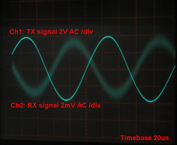

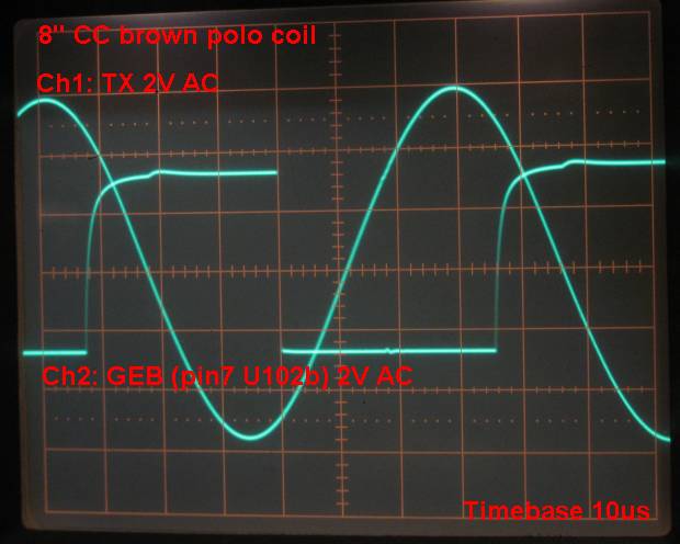

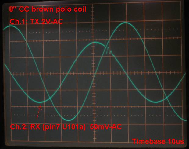

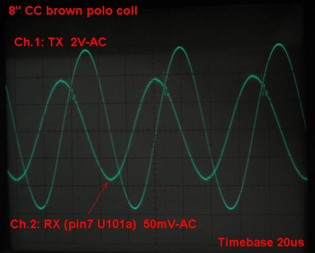

        Two more scope images:
        The tx and rx signals at the polo coil when connected to the Conquistador md. It is clear that Conquistador frequency is 10kHz....
