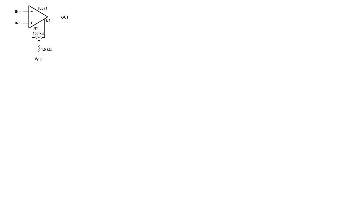

                  Simon, I'm still with you on the idea that the offset voltage on the LM308s can have some impact on performance. If the outputs of u104 and u105 are not in completely in sync we must be losing some part of the signal to u106. Maybe that's why some circuits seem to have a more robust audio or at least contribute to it?
                  With my next experiment, I am going to kludge in an offset adjustment to TL071s in place of the LM308 (u104 and u105). Just looks like I need two small pots with the wipers tied to the -5v rail.. I can probably just solder the pot to the IC legs of the TL071s and swap the LM308s out. Waste of time or not.. I need to know!! Need to order a set, so stay tuned!!
                  Don

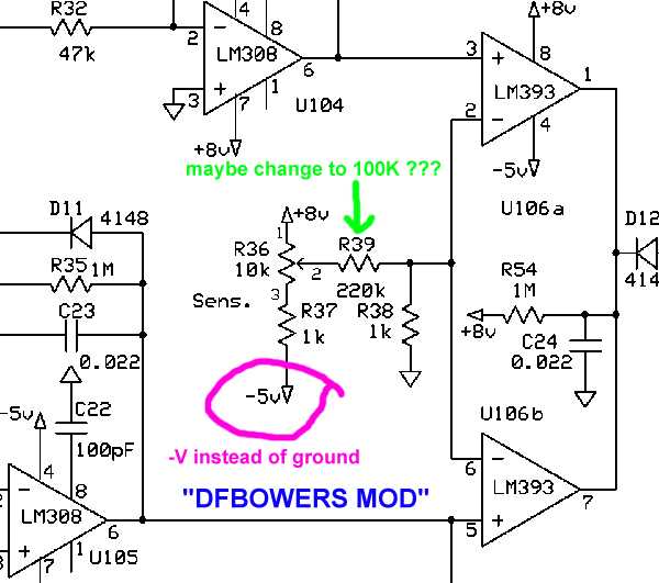

                        If you think the problem is caused by having different DC offsets on U104 and U105, then you could try disconnecting pin 3 (non-inverting input) of U104, and connecting a trimmer preset to allow adjustment of the opamp reference voltage. First measure the DC offset voltage at pin 6 U105, and then adjust the trimmer to get the same voltage at pin 6 U104. Some detectors have this adjustment, which is referred to as DBIAS.
                        You might also want to try removing the limiting diodes D8, D9, D10 and D11. They're not really needed anyway.
                          I can see where adding a trimmer to U104 pin 3 would do the same thing as adding a DC offset adjustment to U104 and/or U105. I guess the other consideration would be to determine exactly where both U106a and U106B will trigger.. and adjust accordingly to allow them trigger more in unison. More things to investigate.

                            Hi Don:
                            Yes, I am talking about the LM308 output "offset voltages", meaning the offset from the ideal zero average output (best seen with shorted RX coil input).
                            And yes, they are different by about 20 mV! ...validating your desire to test separate offset adjustments, which I feel we fanatics would be pleased to have as a useful feature because of off-spec chips. In fact, with such adjustments, the need for precision op amps may disappear, since we are happy to tweak and are not mass-producing these MDs.
                            *** Note -- when adjusting separate thresholds, just looking at the U104 (LM308 ) outputs is not enough -- we need to consider out-of-spec input thresholds of the LM393 as dfbowers once noted. So the real way to calibrate is to separately test the thresholds by watching when the LM393 output flips as we make adjustments.
                            Back to the "light effect" -- in fact I did the tape test and it seemed to confirm light on the diodes to be the culprit -- although what part of the spectrum I'm not sure. I first used some cheap blue electrical tape and did not see the effect go away to my surprise, until I checked and saw that light went throught the tape! More opaque black tape confirmed it. Also the hair dryer test convinced me it wasn't due to heat -- it was hot enough believe me, there was a toasty smell in the air!
                            The "light" incident reinforced my feeling that the DC offsets at U104, U105 (LM308 ) along with the threshold of the U106 LM393 inputs is critical for detecting small signals (and explaining the differences in peoples TGSLs) because I believe the light boosted the LM308 output offset and increased my sensitivity.
                            **** I have now implemented the "dfbowers" mod on my PCB and look forward to testing it. My first test was to crank up the sensitivity in my lab, expecting to hear the audio go to a solid beep. To my surprise, it did not, it just got more chatter. This makes me feel that my LM393 chip may have a bigger threshold than I assumed (those sneaky discount parts...).
                            So, I think we may want to extend the mod even further just to make sure we have absolutely full sensitivity control. I'm thinking maybe replacing the 220K R39 with 100K. This should change the min threshold from -17 mV to -37 mV, hopefully enough to overcome any out-of-spec LM393 and LM308. Of course, going to 50K gives you even more range, but makes the sensitivity control more "touchy".
                            Looking forward to your (dfbowers) tests with TL071 chips. I assume your point is to test using separate adjustments of the offset/thresholds on each input to the comparator to optimize those thresholds. Because the DISC and GB channels have different gains, this might be useful. We might also want to consider literally boosting the gain of the GB channel a little to see how that plays out.
                            Where exactly will you (dfbowers) put the extra adjustments? I guess there are a number of places as Qiaozhi noted. The only caveat to using the non-inverting input to U104 (LM308 ) would be that the stage gain for non-DC signals maybe could magnify noise from the pot. A bypass capacitor around it might be a good idea. In fact, a bypass cap across resistor R38 in the sensitivity control might be a good idea in principle.
                            If you can identify an optimal ratio of the DISC sensitivity threshold to the GB threshold, we might be able to just add another resistor to the sensitivity threshold circuit and pick off two voltages that move together nicely.

                              It looks like we have at least 2 choices for playing with offset and either may let us arrive at the same result. I like Qiaozhi's suggestion on biasing pin 3 of u104 but I may try playing with the offset pins. If I cannot get the range required I will try his suggestion.
                              I was just going to piggy back a small trimmer on a pair of TL071s and solder directly to the legs, then run a small wire to the -v5 rail.
                              Don
                                Don
                                Looks good. Theoretically, you only need to adjust one of them for balance, then use the normal sensitivity control (with your mod) for overall level. Is that your plan?
                                I'm still not sure I like pin 3 for noise amplification reasons, but probaby negligible. It's practical.
                                One thing we want to do is "gear down" the adjustment as much as possible for stability. Otherwise mechanical vibration of the pot will make a big effect.
