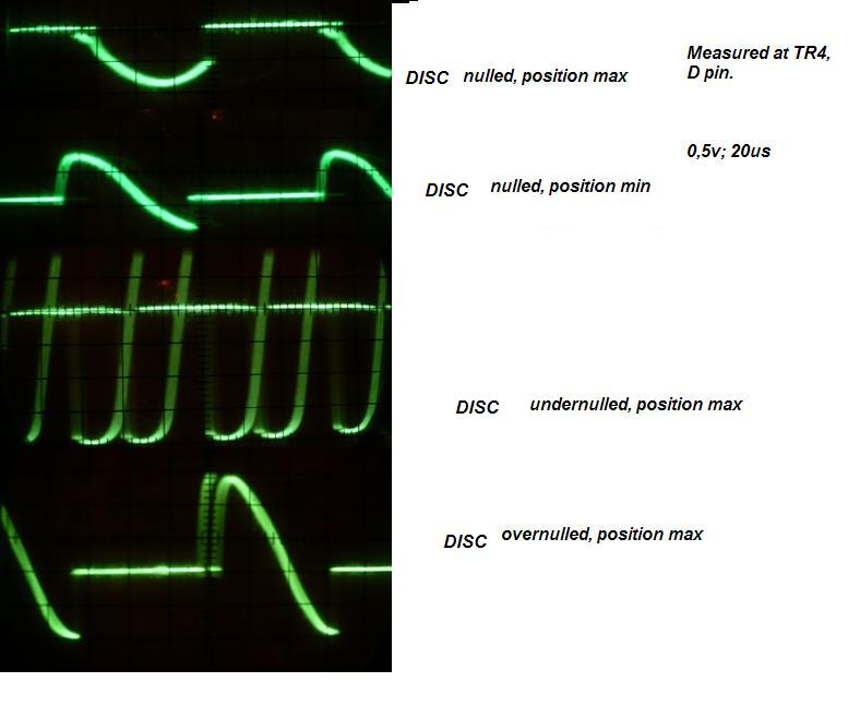

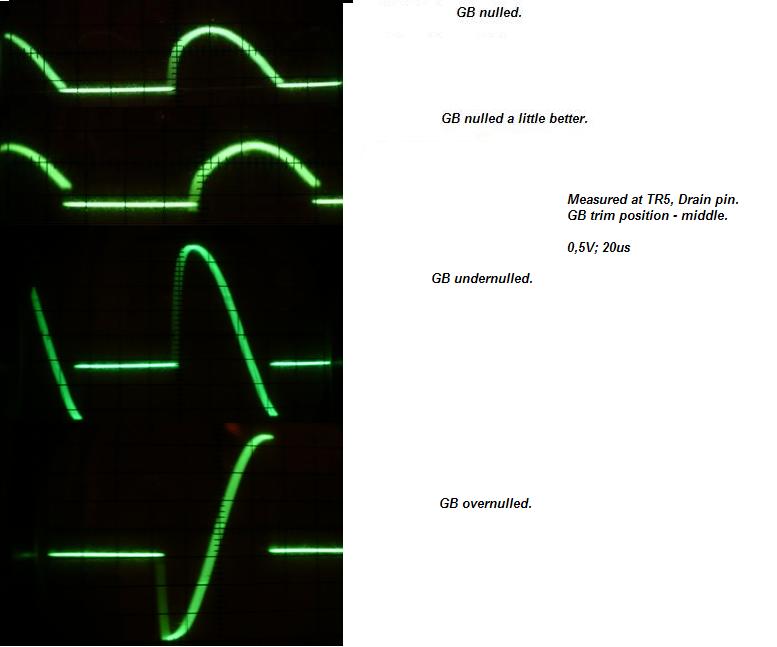

    On TR4 drain pin (disc channel) i see negative impulses.
    And TR5 drain pin (gb channel positive impulses).
    According to oscilograms in forum it shoul be on contrary.

      But on TR4 drain pin (disc channel) i see negative impulses. Yours positive: http://http://www.geotech1.com/forums/attachment.php?attachmentid=3277&stc=1&d=119294976 3
      And TR5 drain pin (gb channel positive impulses). Yours negative: http://www.geotech1.com/forums/attac...1&d=1192949787
      According to your oscilograms it should be on contrary.
      Reasons?:
      Coils gives no double beeps sound, so not reversed rx or tx. Wrong phase shift with 29cm 1e detection and good ferrite rejection?
      Even try a big and small off ressonance: add plus 1nf parrallel to RXc or to TXc. Later plus 10nf to RXc or to TXc. Just for trying to make another phase shift, to check if i can get other polarities.
      I could not make signals at these points sinus shape opposite polarity. Can get only if signal shape rectangle, but it means nulling bad.

          But this don't change Tr4, Tr5 drain signal polarities in mine TGSL. Another mistake in ?http://www.geotech1.com/forums/showt...hase#post61260
          pictures F11-F17.
          Can't still clear up.
          Sorry for that, but have suspect that oscilograms F11-F17 was made with mixed scope leads: ground to signal, signal to ground.
          Or rx, maybye tx leads reversed during scopping.
          It is important to me, cause i want be sure i made TGSL correctly or not.

            Hi johnsmith77:
            It would help if your links referred to the message containing the photo instead of the photo itself. Then we can see the context.
            I'm not sure, but it may be possible that your coils are nulled to a different phase, which could make the oscilloscope signal at tr4 drain look different. It depends on which side of the minimum null point you choose. However, which side you choose null should not affect the basic DISC function. The target signal phase is the same regardless of null signal phase.
            Are you sure you do not have the DISC pot leads reversed? Please describe more fully how your DISC control is working. For example, for each pot position, list all the metals that are rejected and which metals are accepted. Describe which position is clockwise (CW) and which is counter-clockwise (CCW). For example, some people divide the pot range from 0 to 10, with 0 meaning fully CCW.

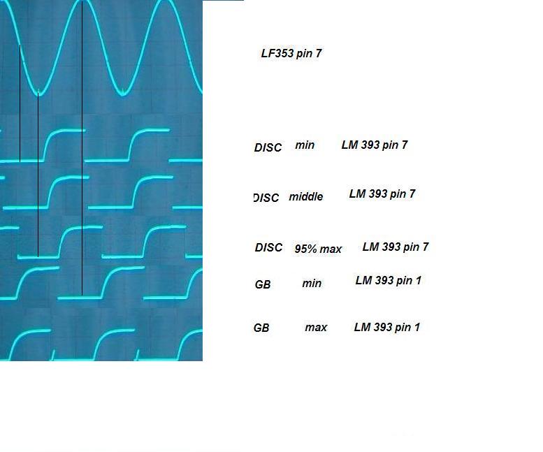

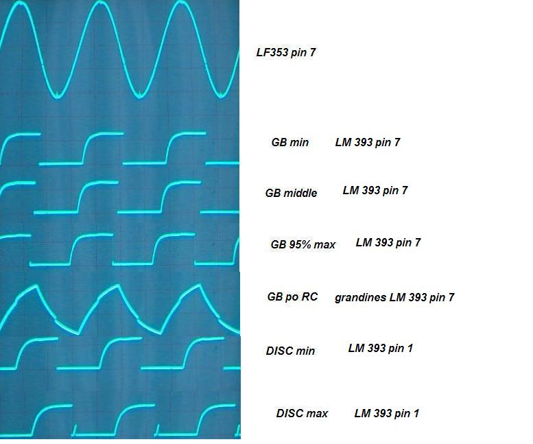

                I add some picture. It would help better compare to yours.

                        • Originally posted by johnsmith77 View Post
                          I don't have 2 channel scope. Will try with 2 channel pc scope, so signal shape will not be very nice with that kind scope at almost at the end of 20khz (sound card), but phase shift can be obtained
                          I attach teoretical scope pic. I am 99% sure i will see the same on the scope.
                          Also i attach one more lower - yours real oscilograms, posted on page 57. I made from your pics, it will help to compare.
                          So mine impulses are shifted 90 degrees from yours. This will change polarity, not shape.
                          Why equal 90? I am so good to ballance coil 90 degrees from yours? Not 12 or 47 ? Think no. Reason is somewhere else.

                            Hi johnsmith77:
                            LF353 pin 7 is not a good reference for phase. Can you do same pics but referenced to TX signal?
                            Sometimes a 90 deg shift means wrong capacitor somewhere -- uF instead of pF -- for example.
                            But first let's compare waveforms referenced to TX signal.
