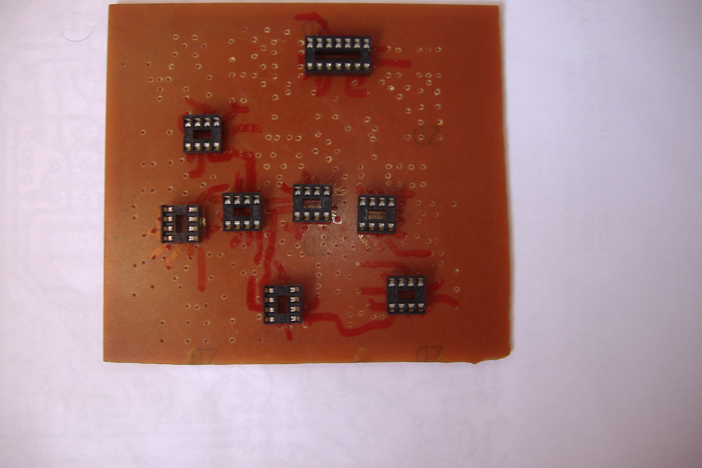

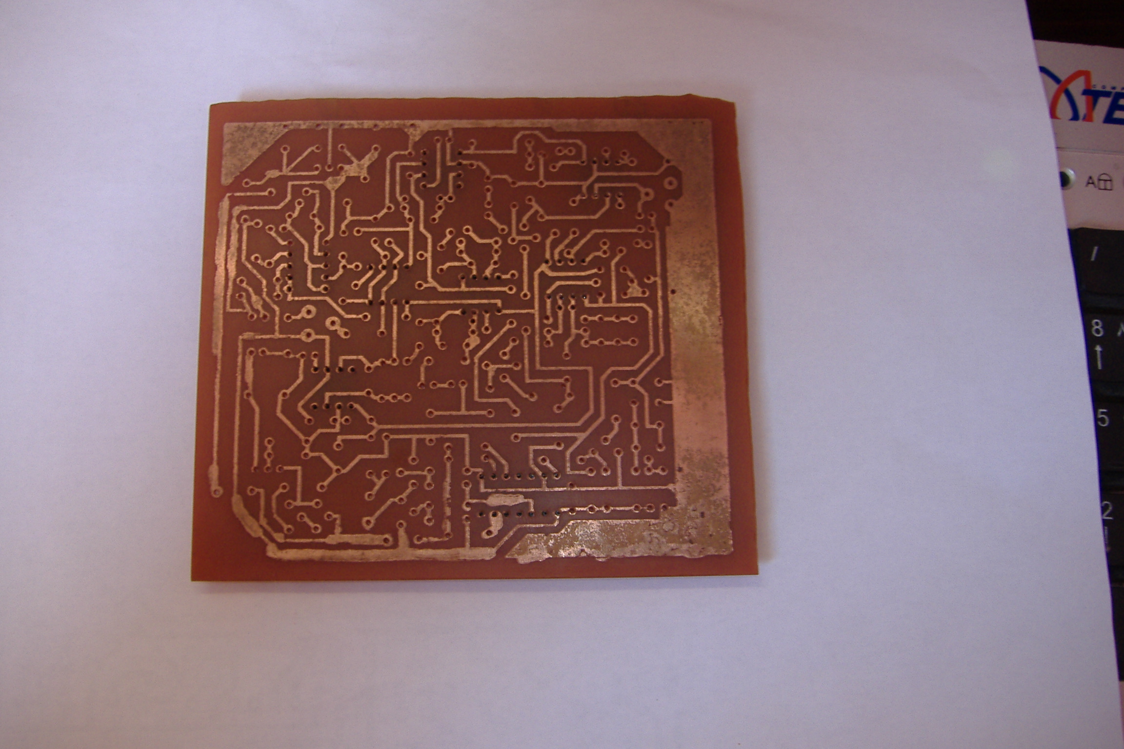

          hi ,
          please what's hapen with my pcb why it is inverted ?
          '' TGSL complete details "
          http://www.geotech1.com/forums/showthread.php?t=15710

            Yes, I have made that mistake too. It depends what method you use to make your PCB. If you use the "toner transfer method" you may have to flip the image on your computer before printing. Other methods do not. . I will hopefuly only ever make that mistake once!
            Other things to be aware of. Make sure that your image is the correct size. I had to adjust mine to about 108% to get it to the right size. All depends..
            Oh well, you just got some good practice for your next one!!

            • What method did you use to make the board?
              I used photo sensitive pc boards and exposed them using a transparency that I printed on my ink jet printer. It was a contact print with the transparency so all I did was turn it over so it looked like the pictures.
              Jerry

                Hi Jerry ,dfbowers
                i use the "toner transfer method" i tryed to invert the image without result thanks for reply............

                    You can easily flip your image with "Paint" or "Microsoft Office picture manager" before printing .. Probably many other ways as well.

                      hi,
                      it is ok i did many thanks
