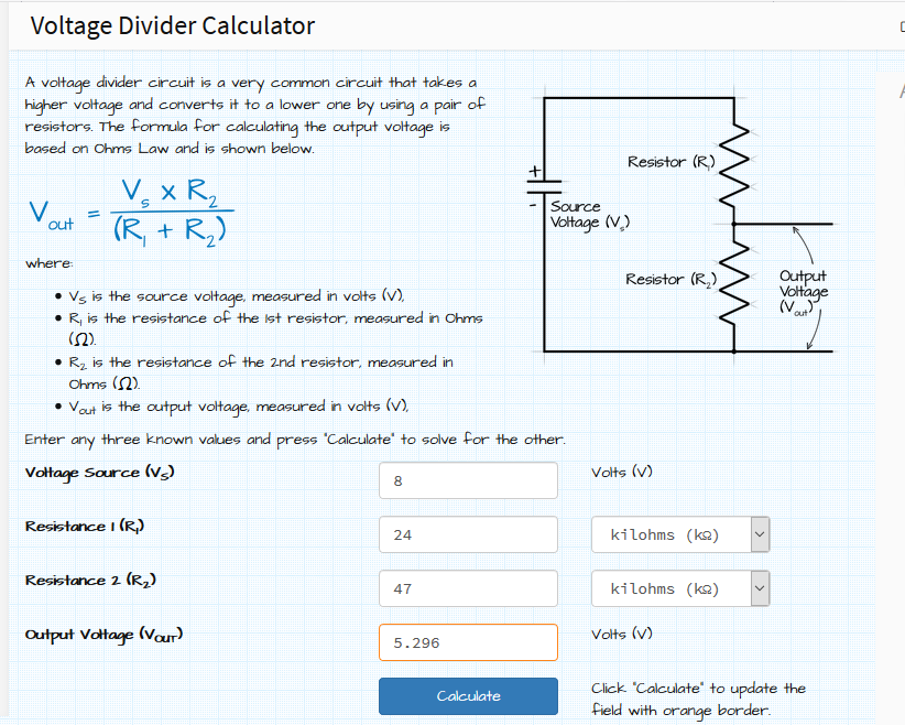

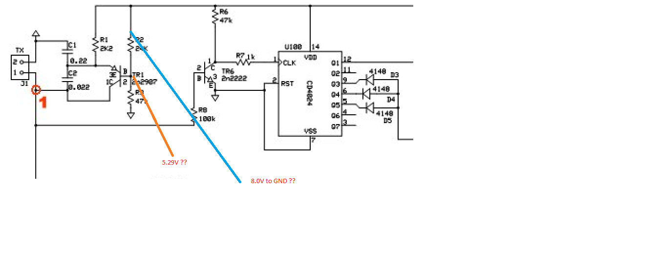

              • Dang Dude, Buy the $20.00 scope and be happey for what it will do for you.
                Do you know Ohms Law ?

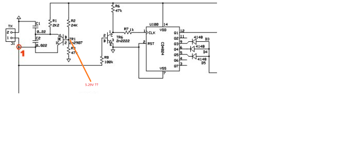

                • I didn't saw that i need 8V. This was what i wanted to know.
                  So i think the problem is the power supply.
                  Edit: I have 0,5V where it needs to be 5.29V.

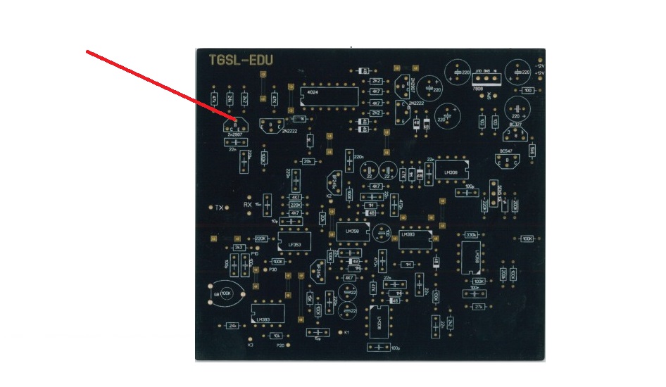

                  • Guess you need too check and see if you have power.

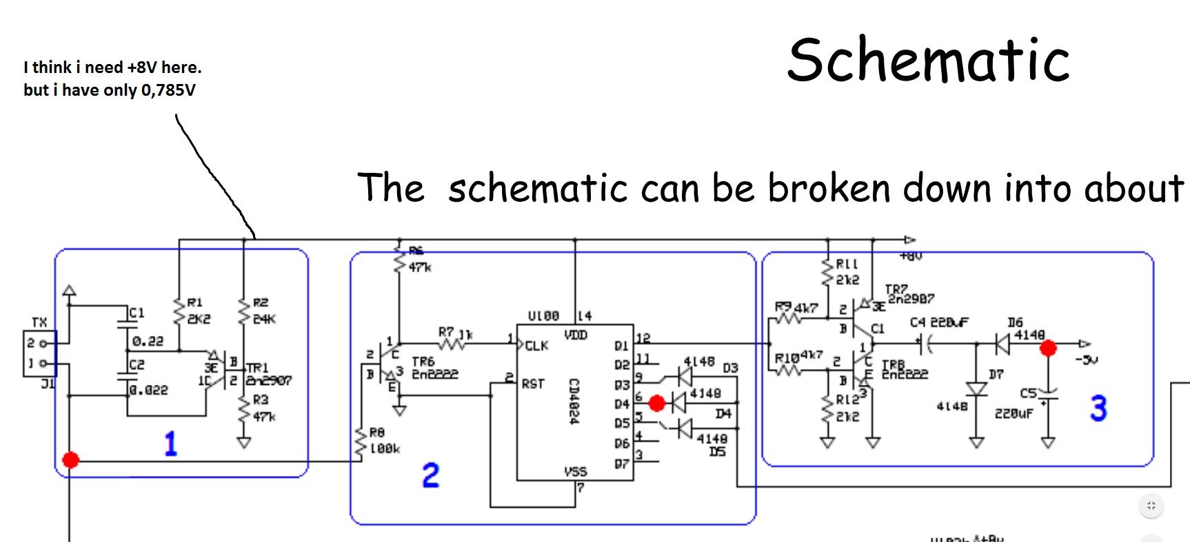

                    • I got only 0.7V at the output of the 7808. I think this is the problem.
                      • Hope you have a spare.

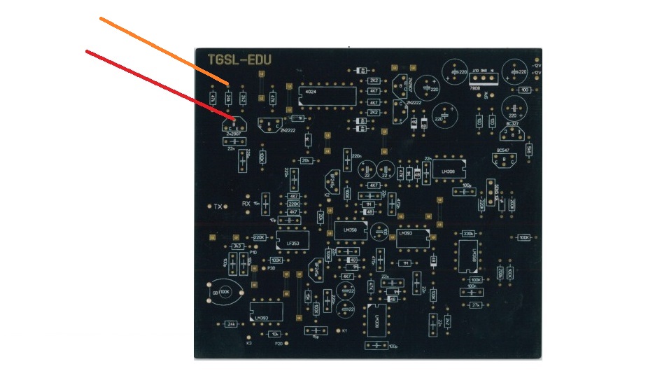

Name:	TGSL PCB2n2907base.jpg
                        • homefire. I have already measured this and posted.
                          0,7V at the upper power connection. (above 24k Resistor in the schematic)
                          And 0,5V at the base of the transistor.
                          I think i need to buy a new LM7808 and maybe change the 220 electrolytic capacitor.
                          No spare 7808 , i have ordered 6pcs right now. I need to wait until they have arrived.

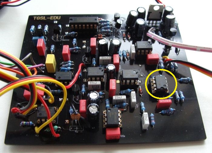

                            7808... If you measure DC voltage between ground and pin 8 on LM358, LM393 or LM308, do you get 8V?
                            • No, i get 0,75V at them but not at this one:
                              I have 10,77V there.
