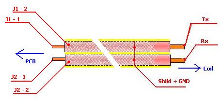

  • Originally posted by Vladimir View Post
    On the coil and the board.
    Do you mean you ground both shields (TX shield and RX shield) to the PCB? In other words, resistor R13 (5.1K) and capacitor C6 (.015u) have their connected leads grounded to the PCB ground?
    -SB
      -SB
      I guess what I was getting at is:
      Do you ground the non-inverting input to the Rx circuit directly on the PCB?
      With a USB cable, the non-inverting input to the RX circuit gets grounded ONLY to the coil shield.
      Don
        Don
        Yes, that was my follow-up question too. Maybe Vladimir actually grounds in both places -- I don't really understand the whole grounding business with the RX coil, so I could believe many variations at this point.
                -SB
                Yes, see post # 188, there are changes in the Rx, but it is the essence of the Tx and Rx connected to GND and Shild
                  Sorry, I'm still not clear - is that ground at J2 pin 2 referring to the coil shield or the PCB ground?
                  -SB
                    -SB
                    This was clearly.
                    J2 pin 2 is connected with the coil shield and the PCB ground.

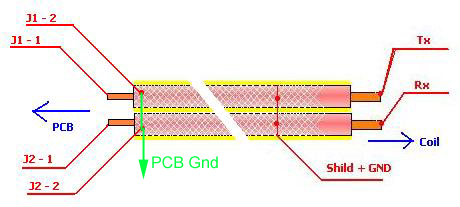

                      Hi Vladimir:
                      I think what dfbowers was asking is: do you also ground the cable shields together at the PCB? (see green line in attached photo).
                      -SB

                                Hi Vladimir:
                                -SB
                                -YES- they are at GND
