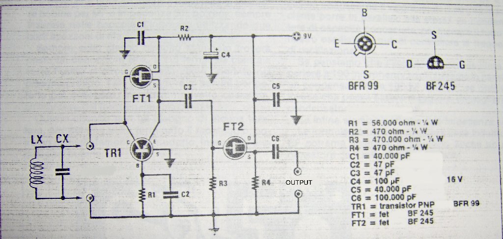

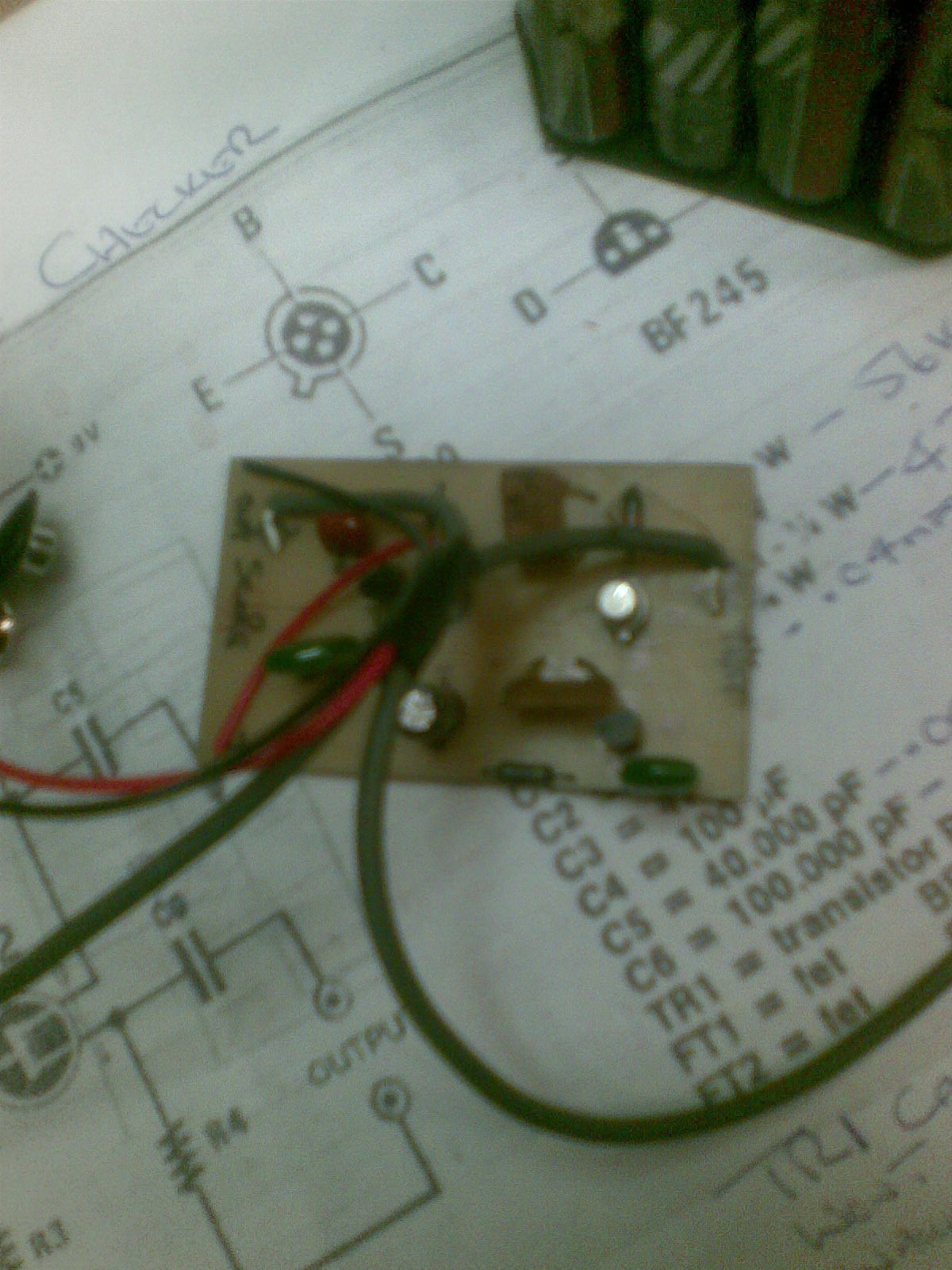

    This one here, put it all together with a 2n2907 with a TGSL working coil 6mh with 15nf cap and its not oscillating, the transistors were ones that were pulled out of the TGSL a while back while doing tests, although they did read to spec before installing them, but never can be sure with old bits.
    Can you see any mistakes on the circuit, the pcb is perfect double checked it.
    The only difference was C1 and C6 fitted 47000pf instead of 40,000pf.
    Thanks in advance for your opinion

      I for one don't know that circuit. Of course I'd just use the TGSL oscillator since I know that one, although it too has trouble oscillating as the coil inductance gets smaller.
      -SB

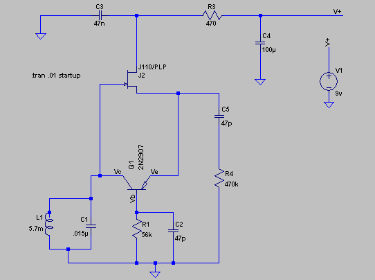

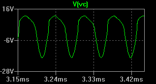

        Hi satdaveuk:
        For fun I hacked an LTSpice sim of your circuit, leaving out the second JFet stage which I don't think affects the oscillator.
        It did oscillate, albeit a little ugly.
        Maybe the transistors are "duff", or your JFet has some extreme parameters?
        -SB

          Thanks simon
          ITS actually called a universal coil checker so should be good for all are coils in metal detecting, by all accounts if fitted with the bfr99 which is tr1 its takes you from a few hz right up to the uhf bands 100mhz or so, or at least thats what i was told.
          Where i got this from god knows but looks as if it came from a old mag at some point.
          While you have it on spice can you check with C1 and C5 at 40,000pf, it may make it less ugley lol
          Where you put c3 it should be c1 simon.
          As i said early though ive fitted 47,000pf in both c1 and c5 because i didnt have 40,000pf to hand
          Dave

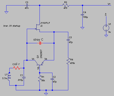

            • INCORRECT SPICE
              The circuit can't oscillate if the transit frequency of Q1 is high, stray capacitance C is small and coil resistance r is large. Pay attention that transit frequency of BFR 99 is high relatively to 2N2907.

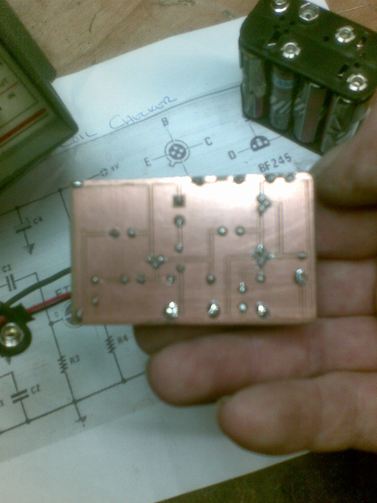

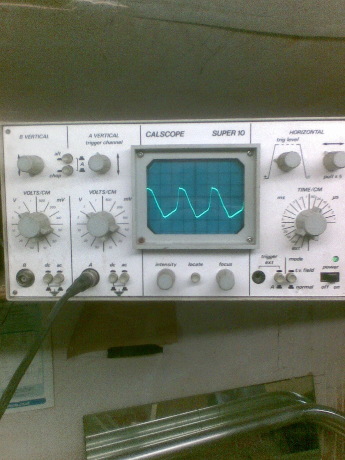

              • universal coil checker now up and running
                Hi Simon and Mike
                I replaced the 2n2907 with the metal type has a slight differences on the spec sheet against the T018 package but not convinced that was the source of the problem, it was proberly a duffer because as explained it had been in my TGSL at some point.
                Anyway the low down on this oscillator is its solid as a rock from switch on far as frequency drift, checked a few different coils with it changing CX etc on them and at this point in time seems very accurate which means its going to be a god sent when making or checking coil frequencys.
                I know exactly what im going to do, shall fit a 5 pin regular socket on one end switched to be able to go from TX to RX without picking up a iron, then along side it sticking out will be a vero board to be able to perfect each coil far as L/C, On the other end a BNC socket so I can feed directly into the scope/frequency counter via flylead instead of messing about with probes.
                Running at 16.750khz picture on the scope in my untidy workshop plus the PCB .
                Note how ugley the waveform is, im going to try and get hold of the proper oscillator TR and order some 40,000pf caps maybe that will correct it.
                Anyway once ive boxed the project will post it under tools for everone ok.
                Sorry about the qualityof the pictures and spelling but it is 6am not been to bed yet
                All the best
                Dave

                    Sorry I was too lazy to re-label the components! I modified an old circuit I had.
                    Your waveform looks similar to the Spice sim voltage taken at the corresponding point.
                    Perhaps the purpose of th oscillator was simply a stable frequency, not a clean sine wave. Usually "over-driven" oscillators are more stable.
                    I tried the 40,000 PF value -- still hideous. I guess that's how it was designed.
                    -SB
