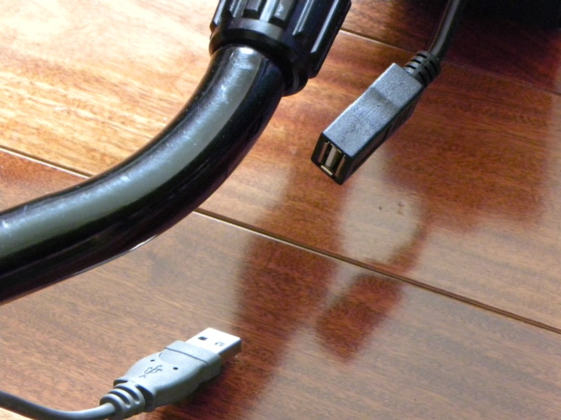

              Andy,
              I found a slick thing to do with a USB-2 cable. Get yourself a USB-2 EXTENSION cable.. Male on one end, female on the other. Cut the cable somewhere near the female (or male) end. Connect the plugs together and use it that way.. You can swap coils EASY!! Just make sure the the short end is near the control box.
              Don

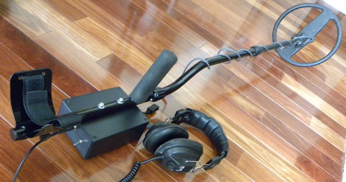

              • Hi @dfbowers,
                Nice idea, but I very much dislike USB Connectors, for they easily break, are susceptible to contact failure and distortion, and they also have no "locked" pull fixation mount. But this is just my humble opinion about USB connectors.
                By the way, beautiful Metal Detector you have there!
                If you have ever had a chance to walk around the equipment used for Pop Festivals, then you will see that they use Top-Notch Connectors. The kind of stuff you can mount on a Cannon, fire it off, and the Connectors will still be there where they have been plugged in. And not only that, they have excellent fixation mounts, and are designed to be plugged in and out many times without suffering loss of contact pin signal threw feed.
                One connector that comes to mind is the XLR Connector, sturdy, robust design, well shielded, have extremely low threw feed resistance, ... and they are also very cheap too! Even the Gold Plated ones, which are less susceptible to environmental deterioration by for instance Oxidation, are also very cheap. Spending a little more money on Top-Notch Connectors will real save you a lot of hassle in respect to poor connectivity, ... now and in the future!

                  Robert,
                  I would agree with that.. My choice of connector probably is not the best choice, and certainly not a positive connection! I have not had an issue with it.. yet, but I will consider it for my next project.
                  Thanks.
                  Don
