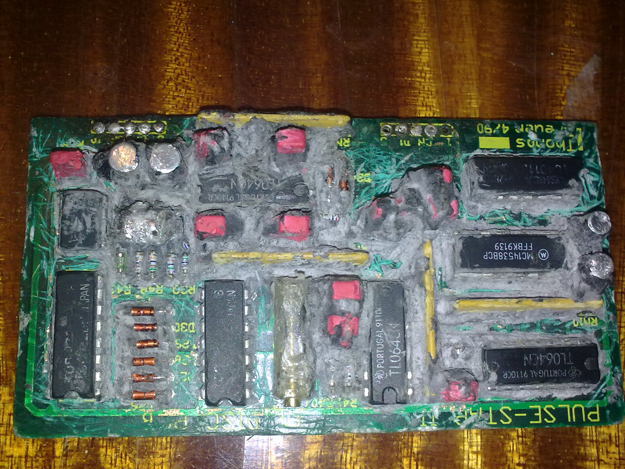

          pulse star 2 pcb 1

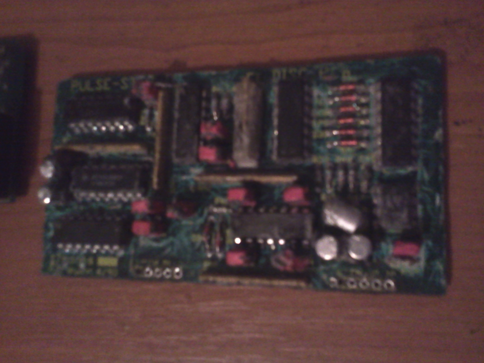

            pcb 2 and pulse star 2 pcb 2

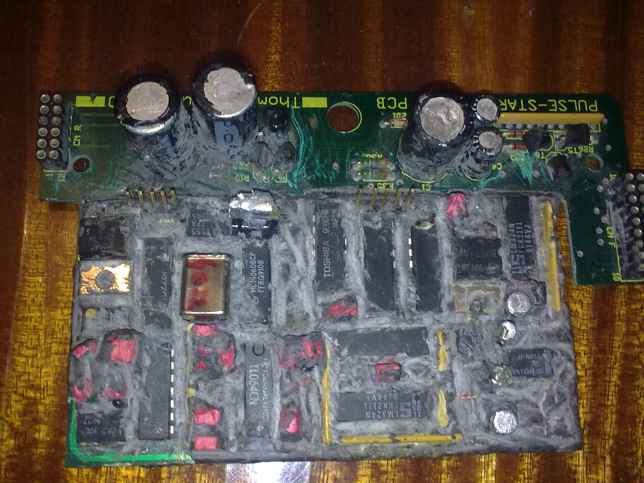

              pulse star
              No more secrets ,pulse star ready to transfer downloaded resin details

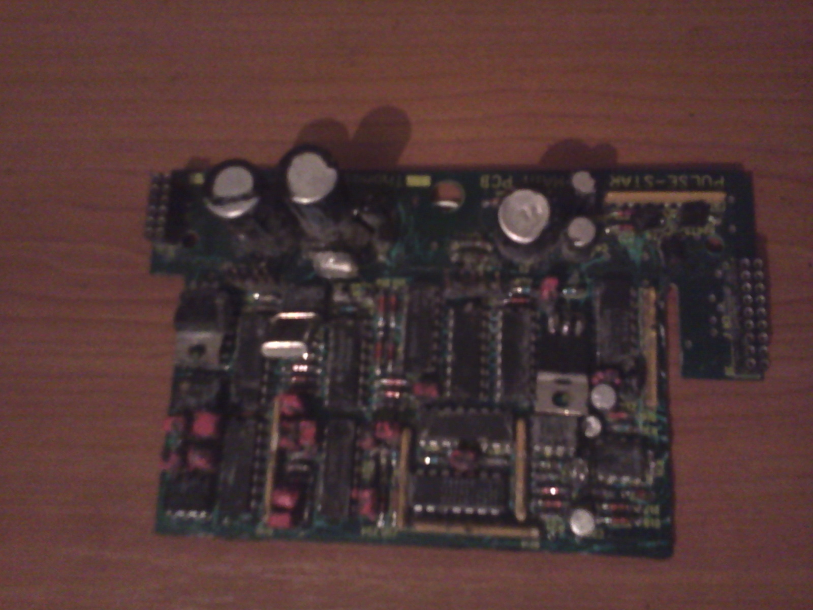

                puls star
                puls star
                • #83

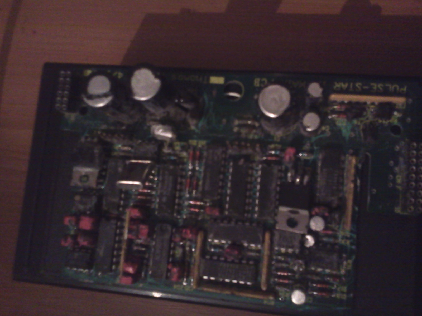

                  puls star
                  puls star
                  • #84
                    Good work Orbit when you will have all the numeration of the ic ...etc...you can put the circuit board in gas auto and in one o two month you will have a mint board without epox but also without all color and inscriptions of the ci
                    • #85
                      Thanks Alexisimex .That about a month to two months , entire job will be done pcb, ic circuits, and more.

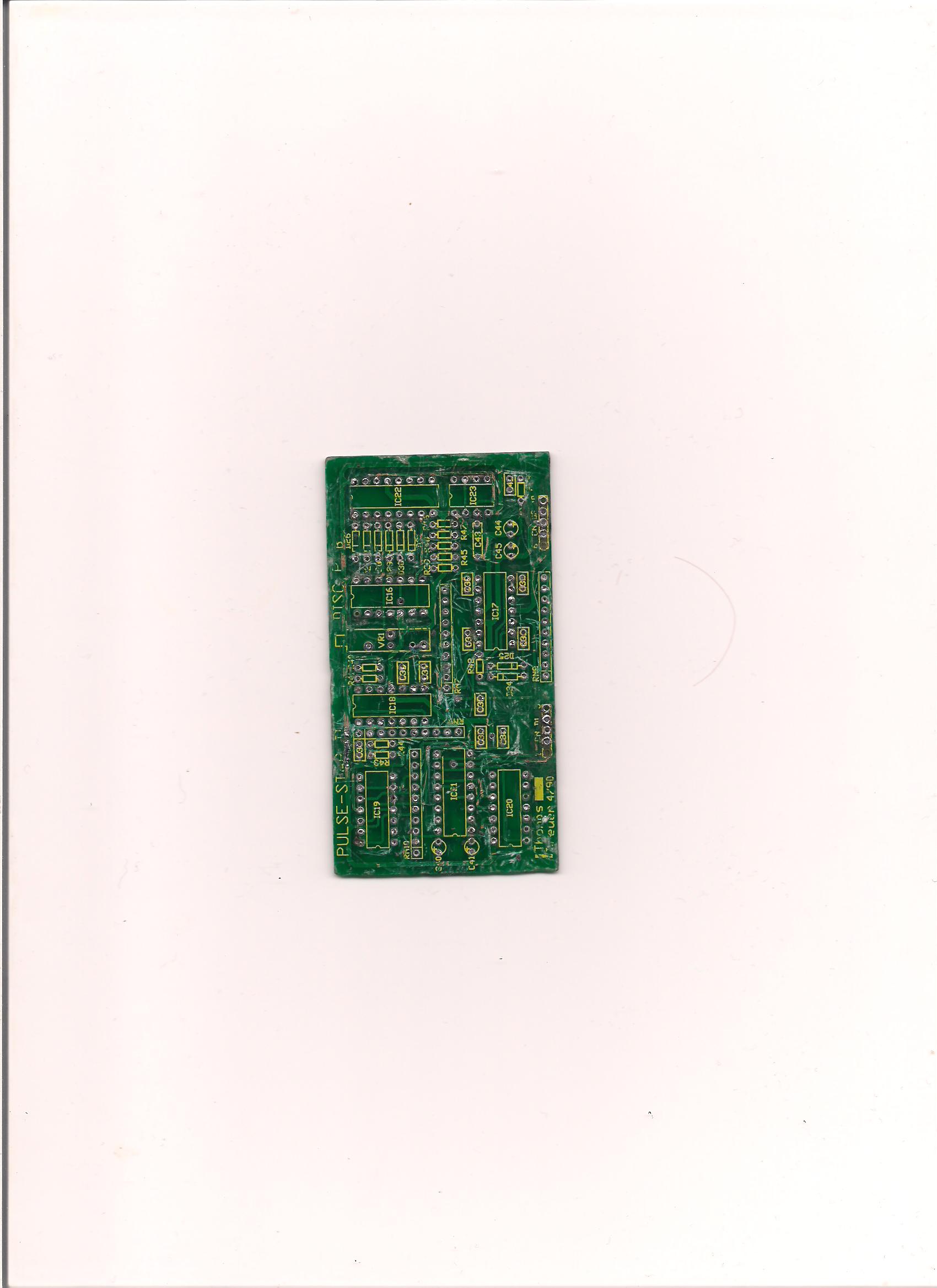

                        small PCB pulse star 2 without parts
                        • #87
                          Hi Orbit
                          You working hard for reverse engineering pulse star 2 !!!! excellent and very good work , but I think you spent more energy without result , because you cannot obtain microcontroller source code !!!!!
                          • #88
                            If he manages to get a microcontroller source code, the question is: is it worth so much effort and wasted time?
                            • #89
                              Unit on last few pics is not uC based, just analog machine (i never see this thing before) and reverse engendering is possible if components are not badly damaged, but will it worth? And epoxy problems sometime can be solved using special dissolver liquid, try to find it at some store selling boat repair kits and chemicals etc, not expensive and usually not make much damage to components.
                              • #90
                                I like challenges, This is all DONE strong hair and plain plastic needle but otherwise this detector does not pick the processor has analog circuits which I normally recorded and all are available to me , example oscillator is modeled with the 4060 cd from it goes counter cd in 4022 and MOSFET etc.
