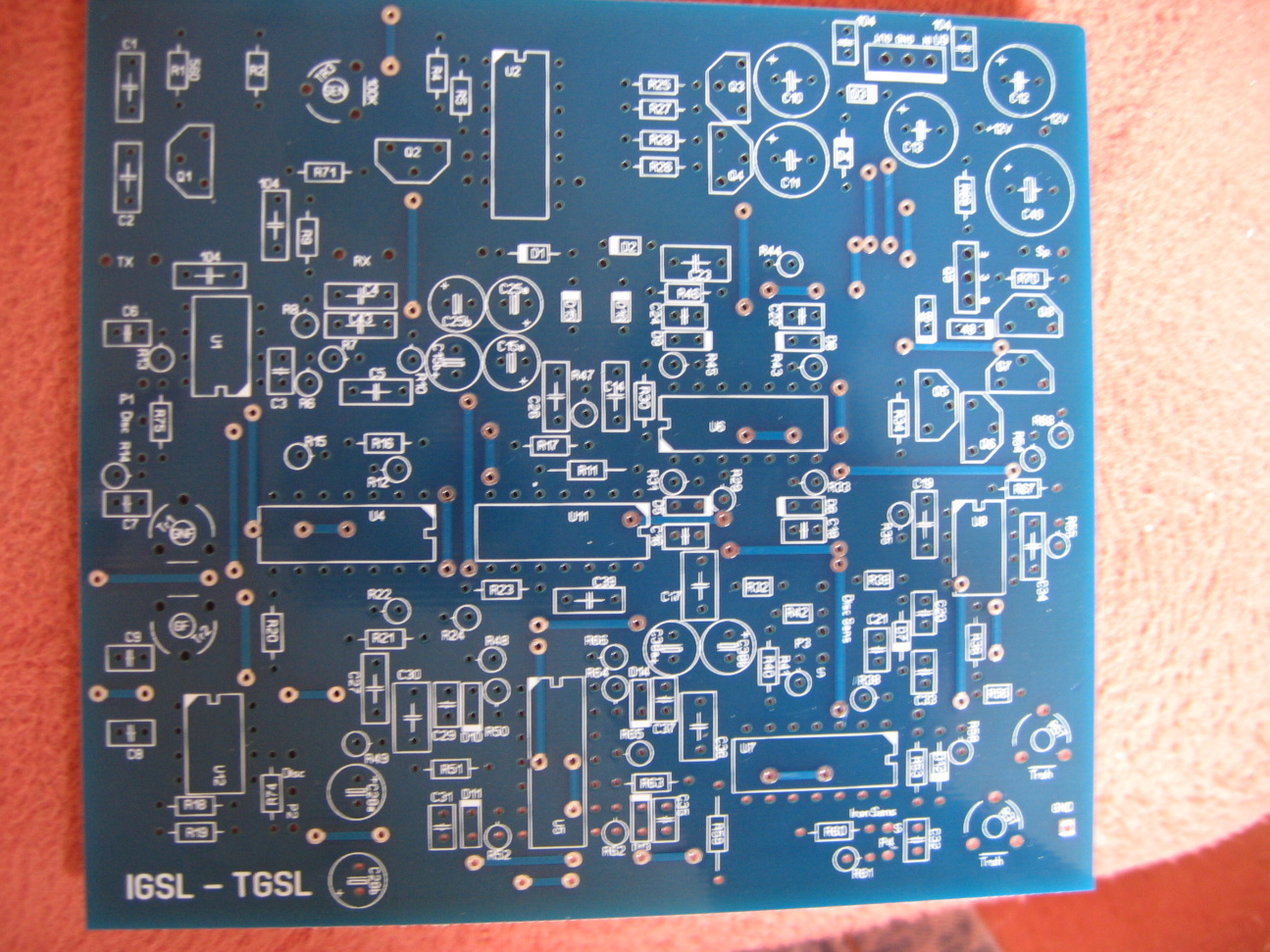

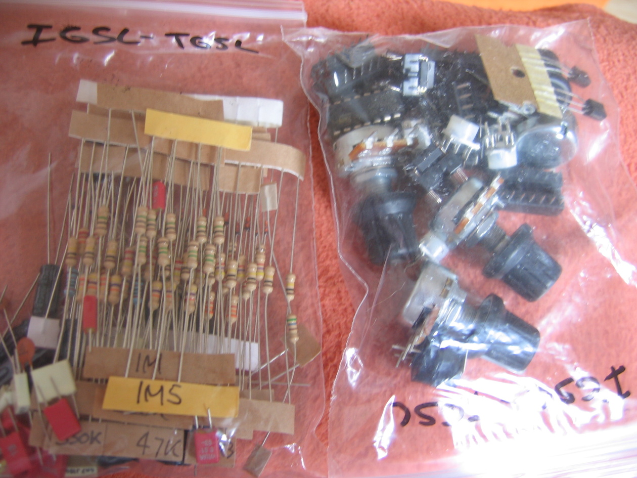

              • IGSL Kit for TGSL DIY Coils has arrived from SilverDog
                First impressions are really fantastic, the PCB artwork is good enough to hang on a wall in a den (sadly my wife would not alloow it on the lounge wall!!!!! )
                All component positions clearly marked, even a complete beginner will have problems in placing a component wrongly orientated.
                He has also added the wire links in as tracks on the top, so its really a double sided PCB, no wires to fit at all on the PCB....makes it even prettier.....
                Two bags of components with attractive mini pots (easy to fit in any size enclosure) WITH KNOBS, which have a POINTER on them, sockets for all chips, clear extra marking on the paper strips which hold the resistors, no exscuse to get it wrong at all !!!
                The reasonable price belies the the excellent quality of everything.
                Thanks SilverDog and well done.
                Andy
                PS I have attached two pictures of the kit.
                • Originally posted by der_fisherman View Post
                  Nice pictures!
                  A bit invisible... but nice indeed!
                    Nice pictures!
                    I just corrected that, I had to resize them to allow uploading.....

                            The top jumpers are a very nice touch for sure!
                            Who will come up with a nice inexpensive coil-building kit, enclosure (box), and pole assembly?
                            -SB
                              -SB
