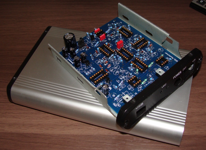

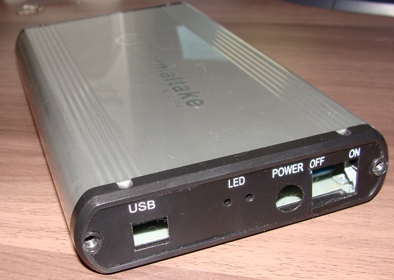

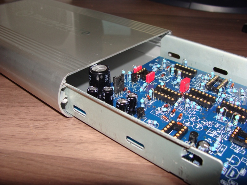

  • Found a used Thermaltake external hard drive this spring at a garage sale for $2.00. It didn't work but, figured the case might be good to house a metal detector.
    The ISGL fits onto the tray that the HD was screwed onto. Only a few mm clearance for the one cap.

          The Hammond enclosure has 4 screws to secure the front panel. One in each corner. Have you placed your own panel over the top of this?
          • First set screws, after the set engraved plate and potentiometers. Screws remain masked.
