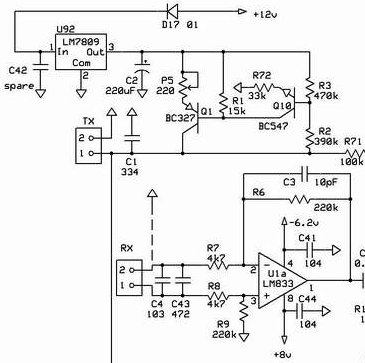

            • Not sure what part on PCB marked 334 is??
              Looks like a cap but, not 100% sure on the value.
              • Capacitor conversion and codes
                Its a cap in Picofarads 334 = 33 and 4 x 0(zero) = 330000 pF.
                OK?
                Andy

                  • bernte one..
                    The Tx on IGSL is 14.6kHz (it is on the schematic)
                    The Rx is 16.3kHz ..... ( from 1/(2 x pi x sqrt(LC)) L was 6.5mH C is combination of C4 and C43 (4n7 and 10n (which is 14n7))
                    So in this IGSL OFF resonance design .. Rx coil and cap is 1.7kHz Higher than Tx.
                    You are right about the ratio of Tx to Rx being approx 1.2 (actually 1.116) BUT, Tx is lower, and RX is higher.
                    For you to resonate your coils at original IGSL design frequencies - with your Tx coil at 0.38mH and Rx coil at 0.71mH
                    With standard values
                    C1=3u3
                    C2=330nF
                    Gives a Tx of 14.9kHz
                    C4 = 100nF
                    C43 = 33nF
                    Gives an Rx of 16.4kHz
                    Difference of 1.5kHz This should be fine.
                    steve

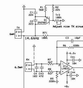

                    • @Golfnut,
                      I think there is a mistake.
                      330nF with 0.38mH gives 14.21 Khz (not for C2 but for C1, C2 is for 9V filtering).
                      And guess what, 14.21 Khz multiply by 1.166 gives 16.56 Khz just like 130nF with 0.71mH.
                      but the real frequency will be 16.37 Khz with 133nF (100nF + 33nF).
                      With a manual selection of the caps, you can easily reach the correct value.
                      Hugo

                          • Hi Hugo, If Bernte one is using an IGSL, I am right.
                            If Bernte one is using the schematic in your post YOU are right.
                            S

                              • Hi Bernte one this is the schematic I was working with
