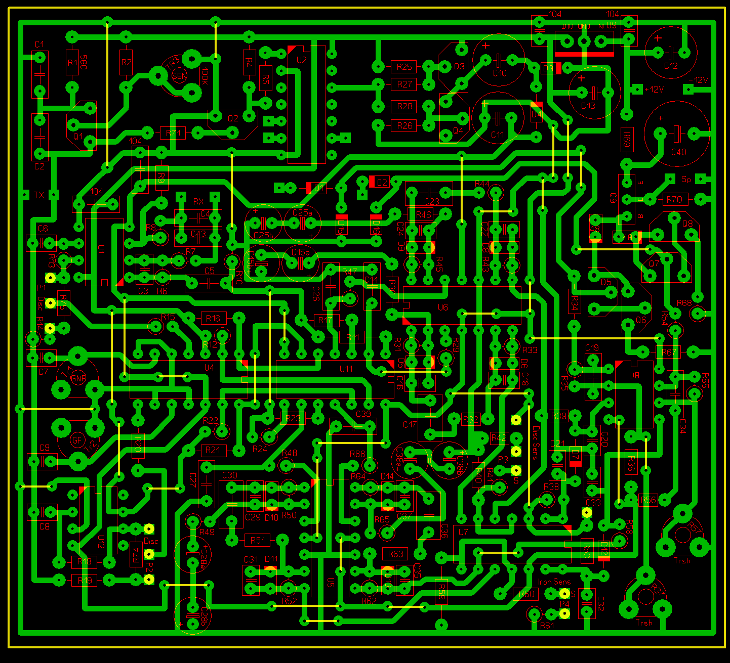

    Hello. In the previous pcb there is an error, thanks to Silver Dog has been noticed. Pin 5 of U1 was wired incorrectly. Now I think everything is ok. First of all, take a look at the TX circuit. Sorry for the inconvenience.

                    The new board is still too big, SilverDog told us that the board must fit into a 100 x 100 mm square for the best prices, the latest board is too large in the X direction.
                    Maybe someone who has a full version of the Abacom software should try and reduce it in size by trimming the X direction. There are plenty of resistors that could be stood up still.....
                    I would be surprised if the software does not allow a board size to be set.....
                    I feel that it really needs to be re-laid out to achieve the requirements of SilverDog and I would do it if I had the software......But I am an Eagle person, sorry.....
                    What is your feeling Guys? particularly SilverDog and Edouardo? What would be the price difference for a PCB, is it enough to worry about or not?

                      The new schematic and the parts list are radically different to each other, I found 10 discrepancies in the caps alone just by looking at the top and top left hand corner of the schematic.
                      Please note:-
                      I DID NOT CHECK THE COMPLETE SCHEMATIC....nor did I check any other components than Caps, so 10 errors are probably not the complete picture.
                      SOMETHING IS WRONG GUYS!!
                      SilverDog cannot proceed at this time till the problems are resolved.
                      My guess is that someone has renumbered all the components in the schematic, but neglected to send us a copy.....
                      I hope its something simple and quickly fixable....but its a possible disaster.....
                      Andy

                          • OK, I will list the failures I have seen, but I have not checked the complete PCB, I feel that with the type of failures I can see, there are serious problems of documemntation.
                            Examples only:-
                            Part Schematic Parts List
                            C4 103 220µF 16v Electrolytic
                            C3 10pF 220µF 16v Electrolytic
                            C5 0.22nF 220µF 16v Electrolytic
                            C14 0.22nF either 4.7µF Bipolar or 10µF Electrolytic
                            C16 103 22nF
                            C17 0.47nF either 4.7µF Bipolar or 10µF Electrolytic
                            C10 220µF 100pF
                            C42 104 Does not exist on parts list
                            C43 472 Does not exist on parts list
                            THIS LIST IS NOT COMPLETE. Format gets lost, so look at the attached text file for a formatted version.
                            I have only checked a small area of Caps only.....no other components have been checked......
                            I feel its pointless me checking further as with such drastic differences there must be another reason for the problems.
                            I checked using the BMP schematic that Edouardo posted today. It is seemingly identical to the one posted some days ago, no differences at least up to now and that was one that Ivconic said was incorrect!!!!
                            Maybe you sent the wrong schematic Edouardo? Can you check please?
                            Andy

                            • Der Fisherman you confused first schematic (IGSL for TGS/TGSL coils) with second version (IGSL for Musketeer coils). Be patient for half an hour and you will have both versions completed.
                              By now i finished first version update, here it is:
                              • The changes I have noted are far more than what you describe, at least 4 caps on the schematic, are not in the parts list at all, some pF caps are suddenly µF electrolytics in the parts list, a gigantic leap in value.....
                                We do need to check carefully, and that's simply not possible at this time.
                                With regard to the two New PCBs, both versions, are the differences purely component changes or are they also Board changes?
                                By lining one above the other I could not detect any PCB differences (but I was using a bad method!)
                                My take is an out of date schematic.....but only Ivconic can be certain or not.
                                Due to the fact that the values are not in the data for the PCB, only the part, I cannot check better.
                                Also, some pads are in the wrong layer, they show up as yellow with the wiring and will not get etched on the PCB......fatal!!
                                Andy
