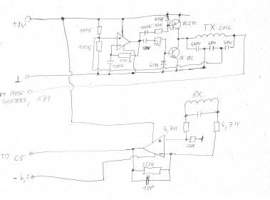

        • What build you have, what kind of coil do you use, and what is exactly your Rx input configuration?
            Tx: Push-pull oscillator, 13.5 KHz, 40 V P-P, 80 turn, 0.4 millimeter. Rx: IGSL original amplifier, 135 turn, 0.25 millimeter. Amplifier and oscillator the head is installed. The head polyester resin and fiberglass material.
            • Could you post the schematic of the head?
                I'm sorry, I drew by hand.Click image for larger version
                • There is a configuration of this oscillator that may perfectly fit a pinpointer due to it's instability. Please in the future when you post drawings save them in gif or png format. jpg-s are full of artifacts that spoil them

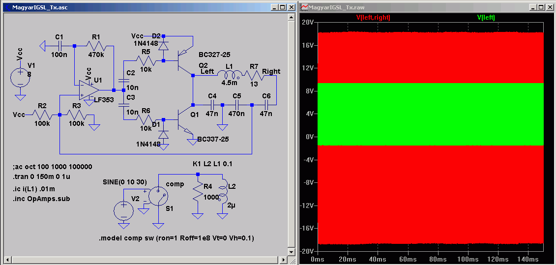

                  I made a LTspice sim of the oscillator as per your drawing. Please confirm what op amp you have and what are the exact values of C4, C5, and C6. Especially C4! That makes a big difference.
                  Actually, please check my schematic for all components.
                    There is a configuration of this oscillator that may perfectly fit a pinpointer due to it's instability. Please in the future when you post drawings save them in gif or png format. jpg-s are full of artifacts that spoil them I made a LTspice sim of the oscillator as per your drawing. Please confirm what op amp you have and what are the exact values of C4, C5, and C6. Especially C4! That makes a big difference. Actually, please check my schematic for all components.
                    The circuit diagram is correct, but three mistakes.
                    R1=100k
                    R7 none
                    U1=TL081
                    Oscillator signal phase shifters load without: 80-100 volt PP

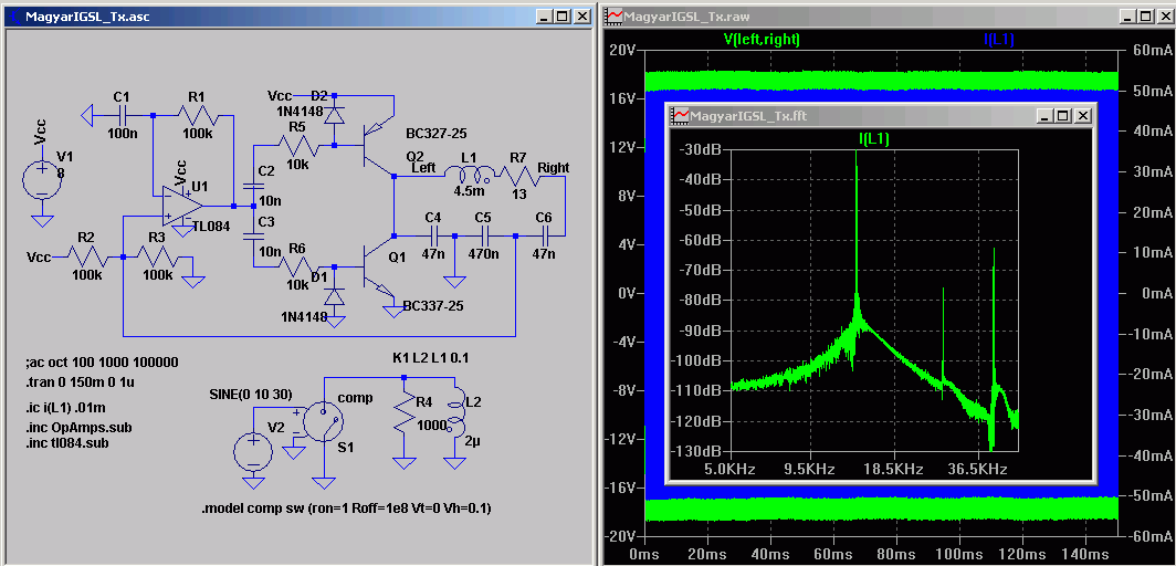

                    • I corrected the schematic, and you'll see a TL084 model, which is the same thing as TL081. R7 is a lumped representation of coil resistance - I think it is about just right for your coil. Only thing I don't understand is:
                      So, are my capacitors correct??? Please clarify.
                      In case of a different capacitor configuration you can obtain quite high voltage across a coil, but in all such cases you lose stability.
                      If your oscillator performs as per the attached simulation, I'd exclude it as a problem here.
                      I'd say it is shielding problem after all. My coil is without shield, but it has a centre tap on the Rx coil.
                      Here is a latest picture and a LTspice model for everyone's convenience.
