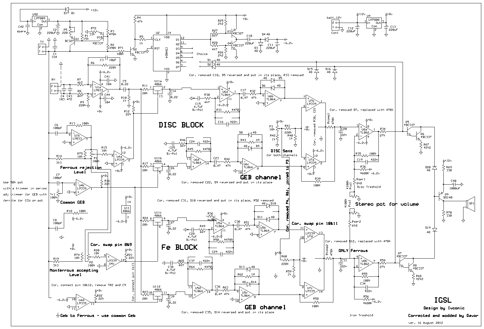

                  • Here comes the scheme for IGSL with my mods, set as a delta against the original. I did not include my mods of the preamp stage, as there is a minimum benefit if you do nt make your own coil with a center tap etc.
                    Here you'll find some details I did not discuss on the forum yet, but as they are tested and obviously work fine, and I do not intend to change them any time soon ... that's about it.
                    Ikebana correction of a Fe channel Disc works perfectly. However, I had to solder some wires directly on chip pins, swap them and insert them into a socket. It did not work the first time I did that. It's action is best perceived with weak signals, and it enables joining the controls of Sens and Thrash. into common ones.
                    If you follow everything through, you'll find loudspeaker reproduction a bit too quiet, and that's because I favour headphones.
                    I replaced LM358 with TL062, but beware, it works only with a comparator stage modded as shown - it does not work well if inputs are forced too close to the rails.
                    I also replaced LF347 with TL064, mainly for lower power consumption. LF347 has somewhat better noise and lower 1/f corner frequency, but noise is dominantly defined by the preamp, so I didn't care. Besides, I don't have LF347s at hand so TL064 there is. I might replace them with LF347 eventually but I don't expect much improvement. LF347 are better, but are they worth the milliamps they consume - I don't know.
                    There is no LF351. It is not doing anything different than U1B does, so the potentiometers are just wired together. Works fine.
                    Fe channel's GEB subchannel does not do anything different from Non-Fe channel's GEB, and it could be used for all metal indication. My inspiration ran down on that one, so if some inspired soul has some idea, please step forward.
                    You'll find diodes only in the second stages of the gain blocks. That provides better response for strong signal. There are no capacitors in those stages because they only ruin timing at the subsequent comparators. There are two LPF stages prior to this one, so those capacitors will not be missed. You'll see that in Disc subchannels there are no resistors in feedback, and the reason is near 20 dB gain that ensures sharp discrimination triggering up to the discrimination edge, and less signal strength dependance on discrimination. Now I can be sure the Al foil will give double tone from faintest to the strongest signals - as seen in the first video. Increasing Geb subchannels gain did not make sense because of the noise.
                    U7 circuitry is pure Feng Shui. We may discuss that, but it obviously works better than the original and all other Tesoros.
                    Just ask.
                        Just ask.
                        Thanks for schematic. Your mods seem to make some useful changes; in particular, the mods affecting target beep duration and response speed are interesting to me. I see you kept the 22N cap and added Rcomp1 in the "chatter filter", which I'm guessing helps stretch a detected pulse; it also changes the "floor" voltage level that the comparators can pull the drive voltage down to, so everything has to be adjusted to get the desired delay. I have wondered if a very small schmitt trigger interval could be used also to improve the chatter quality and target beep.
                        The mods with the feedback diodes also affect the target beep duration and response speed. I guess you are OK with throwing away one LP filter; I have wondered if we actually need a higher order filter to make a sharper high-end cutoff so there is less HF noise to make chatter, and we can relax or get rid of the "chatter filter" delay circuit. Don't know.

                          • Thanks for posting your Mods and corrections Davor. However I do have one nit to pick
                            U8b is shown with the inputs shorted together. I think you intended for pin 6 to go to Rser2, the 6.8k resistor.
                            Still have not digested the whole thing but will give it some study.
                            Jerry
                            • It is an error, not a nick. It happened when I dragged the potentiometer to indicate a stereo pot. Thanks, I fixed that with me here.
                              I also noticed the R36 appearing TWICE near U5a. It is another obvious error.
                              A few more corrections and I'll repost the schematic.
                              Thanks.
                              BTW, my mods are mostly done in a way to make minimum difference on the existing PCB-s.
